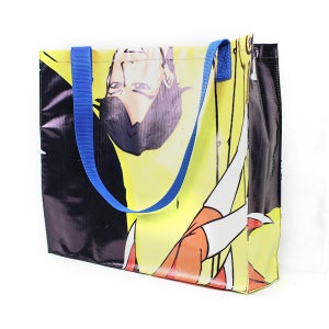

Introduction: Upcycled Banner Tote Bag
A simple and quick sewing project using discarded banners to make attractive tote bags – can be used for all reasons and seasons! It is also a perfect piece to replace plastic bags for your everyday shopping :)
This bag is made by using discarded banners from big events which was used for adverts and information. In Biji biji, we collect these unwanted banners from the event companies and bring them to our office to make things such as tote bags, pouches or pencil cases.
The aim of this project is to raise awareness about environment pollution and to give an idea on new and creative ways to reduce and reuse materials. To find out more of our sustainable fashion products, feel free to check out our page.

- You are done! now you can enjoy carrying a trendy tote bag and also helping the environment.
There you go! Simple and quick to make, and it sure looks good too.
