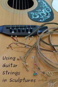

Step 1: Tips for Using Guitar Strings in Your Art and Sculptures
I recommend that you wear safety glasses and gloves when you are working with guitar strings. They are springy, and the cut ends can scratch you. If you’ve never changed the strings on a guitar before, please be careful so that you don’t put your eye out and break your poor mother’s heart.
The easiest way to get used guitar strings is to have an experienced player give you strings with no guitar attached. If you remove them from a guitar yourself, make sure that you know how to do it before you begin. There is a nice tutorial here, and it’s not difficult, but guitar strings are under a LOT of tension. I’m serious about this, don’t cut or twist or attempt to remove a string from a guitar unless it is COMPLETELY slack.
Guitar strings wear out quickly enough, and you may be able to find someone who is more than willing to give you their old ones the next time they change them out. I feel like the worn look gives them extra charm, and of course I love upcycling whenever I can, because it gives new life to something that was going to be garbage anyway.
But you can always buy new strings for this project if you want to, and if you do, I highly recommend the Ernie Ball Silk and Steel strings. They have a layer of silk in between the core and the windings, which makes it really easy to remove the windings from them (we will be making the lily petals out of the windings). They’re also the strings I put on the guitar I play, because they’re easier on my fingers than all-metal strings.
Take a look at the guitar strings that I used to make the lily sculpture. A set of guitar strings for a standard guitar will have 6 strings that vary in thickness. The thicker, bass strings are usually bronze colored, and the two thinnest ones will probably look silver.
See how some of the strings are thicker, and look like springs? Those are made from very thin wire (the windings) wrapped around thicker wires. The windings can be removed (I’ll show you how in a minute), which will give you yards and yards of very thin, curly wire. The windings are what I used to make the delicate lily petals.
In all, I used four sets of strings for this project, but I picked through to get the sizes and colors of strings that I wanted. I only used the thickest 16 strings from the 4 sets, so the thinnest silver ones were set aside for another project.
One end of all of the guitar strings should have a metal ball on one end. The balls on the tips (you can’t see the balls when the strings are on the guitar) might be many different colors. This is because some brands color-code the balls so that you can tell the strings apart when you’re re-stringing your guitar. So don’t be too surprised if the strings you find have strange colors on the tips… just look for a different set of strings if the colors aren’t what you wanted for the stamens of your lily.
The other end of the string will probably be curly, where it was wrapped around the tuner on the neck of the guitar. I didn’t use the curly part in this particular sculpture, but if I was making a vine it would make a great tendril. Or curly hair on a statue. Or the tail of a piggy. Okay, I need to make another sculpture now!
