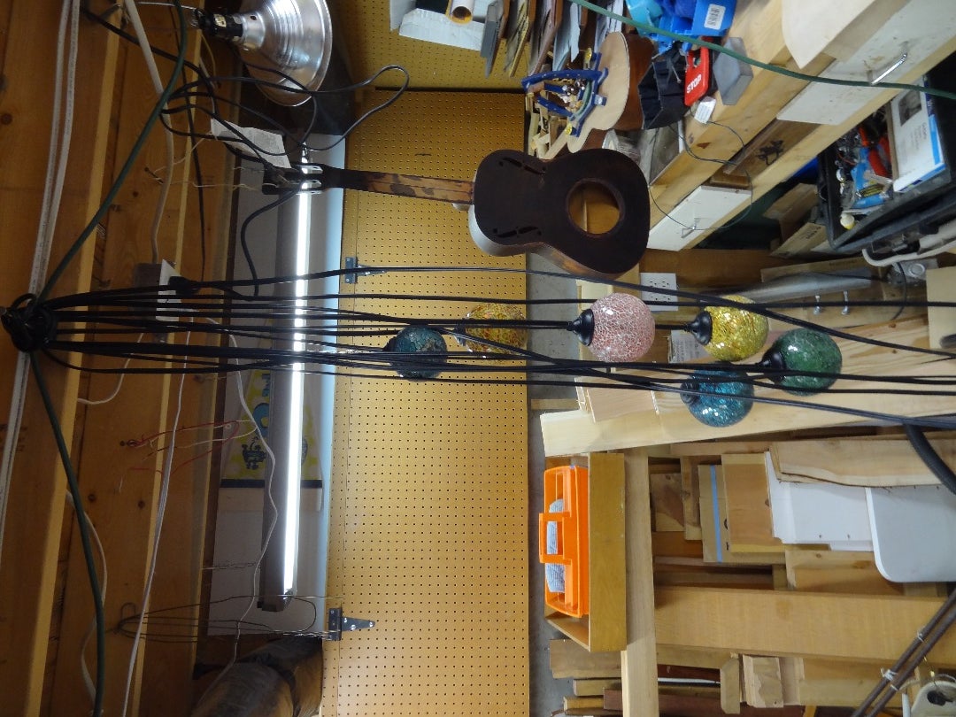

The old LEDs in the orbs were probably good, but the wiring was cracked and worn and the fixtures were gobbed up with old silicone glue. I stripped that all off, washed the orbs, and set them aside to try.
For the new LEDs I split the 16/2 wire into 7 lengths, one for each light and one to run to where the solar panel would be placed. I then sliced the end of the wires, inserted the LED into the wire with the long lead always associated with the side of the wire with the writing on it (to keep track of positive and negative leads).
To keep the LEDs in place I soldered them to the copper wire.
I then threaded them through the fixture, tied a knot in the wire, and attached the orb. I hung the first ones in my workshop while I made the rest.

Wire the orbs up in series and test them. I first tested each and then the set of six, starting with 2 AAA batteries and then using the solar charger.
Once it was all working, I dug out a set of Molex connectors and wired everything up so that I could detatch the solar charger from the LED leads. I did this so that I could bring the solar charger indoors during winter. I think the orbs will be fine outside.
