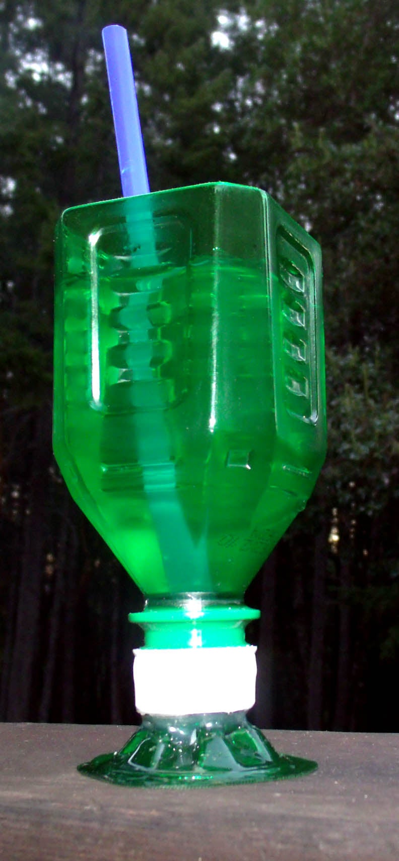

Step 1: Materials
-PETE (plastic #1) beverage bottle of your choice- there are some cool bottles out there, shop around! You can even mix and match different bottle parts around to make more unique cups.
Step 2: Tools
- Hot glue gun and glue, you can also use epoxy, whatever works.
- knife, scissors, or other fairly precise bottle-demolition tool.
- very fine grit sandpaper or a piece of metal that can be heated.
- Sink and soap for washing.

Step 4: Cut Cup
Look at your bottle and decide where you want to cut it- the size and style is up to you.
Using your knife or scissors, cut the bottle in half where you want. Most soda bottles have a design that commonly includes a diameter somewhere on it, so you can follow that to get a clean cut. Go slow and use a sharp blade, you want the cut as clean as possible with no burrs.

Step 6: Cut Base
Flip the remaining chunk of bottle over and cut off the bottom. Bottles vary, so bottoms vary. Cut it down to where it is of a desirable size and sits flat.
Step 7: Scratch and Glue
Use some sand paper or a knife to scratch up the top of the bottle, and the part of the base you are gluing to. This will make your glue adhere much better.
Glue it! It helps to use a tiny dot of glue at first just to tack it in place and make sure it is level at first, then come along and reinforce it with more glue once everything looks good.
Keep any and all glue and glue residue out of the inside of the cup, the majority of glue isn't food safe and you will have to restart.

Step 8: Decorate, Clean, Drink!
You can attach more bottle parts to your cup to give it whatever kind of look or features you desire. Handles, garnish holders, straw holes, whatever you see fit.
Once you are done building and decorating, wash the bottle again with warm soapy water to get workshop residue off it.
Drink from it!
These are lightweight, recyclable, pretty indestructible, and always start conversations.
I make these all the time, so a gallery will begin to develop on this step. User builds will also be put here.
