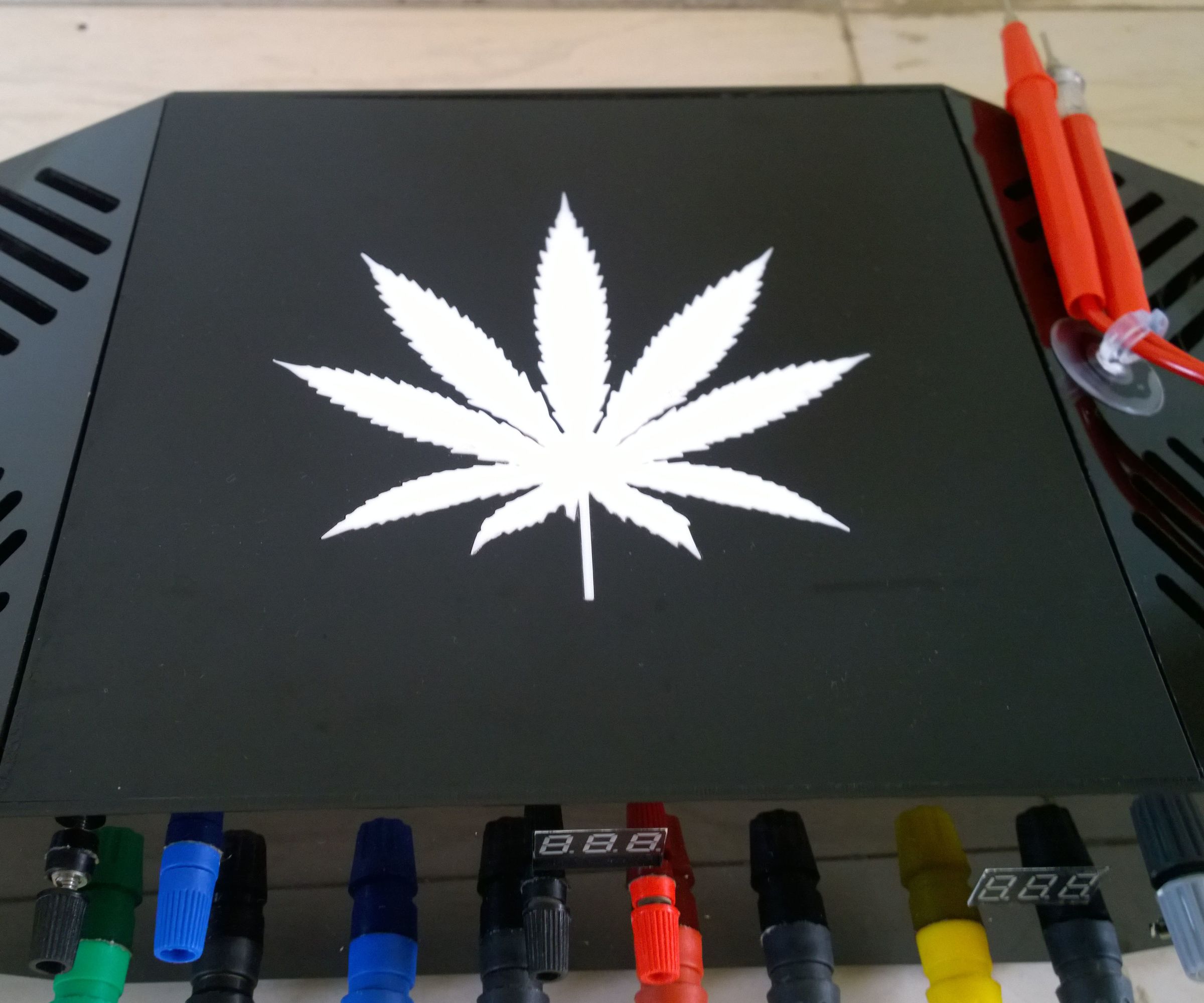

Start to unscrew and open up the LCD, Here is the Power Supply board, which couldn't power up.
We wont be needing the LCD panel, the black glass that shows the Images. So remove that too, All we need is the White Surface with the Lights.
So I soldered the components according to the schematic diagram.
Step 3: Resplendent
The next important thing is the final finish, Cut and Fold the image so it looks like perfect.
Use some instant glue and paste the image.
For the support I'm using the back plate of the monitor itself, with a piece of acrylic sheet so it could sit on my table.
and Voila! Check out the Pics.
