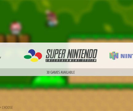

For convenience, we are going to be using the USB method due to its convenience.
Using USB to Sync ROMs
  1. First, make sure the flash drive file system is FAT32.
  2. Then, on your computer, make a folder at the root of the flash drive called retropie
  3. After that, eject the flash drive and plug it back into the Pi. We have to do this so that RetroPie can create the rest of the subdirectories in the retropie folder.
  4. Wait 10 seconds for the subdirectories to be created, and then plug it back into the computer.
  5. Now it's time to place all the ROMs onto the flash drive. Head over to the flash drive, and go to the directory retropie > roms > and drag roms into their designated folders. For instance, if you have an SNES ROM, place it in the snes folder (zip files are also acceptable). Playstation 1 ROMs go into the PSX folder.
  6. After you are done, eject your flash drive and plug it back into the Raspberry Pi.
Syncing ROMs to RetroPie
  1. Now that you have your flash drive plugged in, it's time to restart RetroPie. However, a trick I like to do is to press the start button and click on quit EmulationStation. Only RetroPie needs to restart, not necessarily the Raspberry Pi itself (although you can just pull the plug and plug it back in...).
  2. Finally, just wait for all the ROMs to sync with RetroPie, and you're golden!

Time to get all the metadata for all your ROMs! Fortunately, there is a quick and convenient way of doing this. Make sure your Raspberry Pi is connected to the internet via an ethernet port or anything else, and follow the instructions below.
  1. Click on the start button
  2. Go to Scraper
  3. If you want, you can choose your game database that RetroPie will be pulling information from
  4. Press Scrape Now
  5. Make sure "User Decides On Conflicts" is turned off. By doing so, we can just breeze through the metadata syncing quickly without it asking you for input every time.
