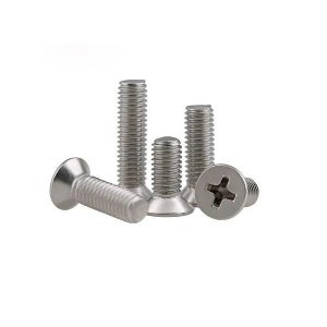

  1. M3 x 10 - 4 pieces ( for Top Lid)
  2. M5 x 15 - 2 pieces ( for Back Lid)

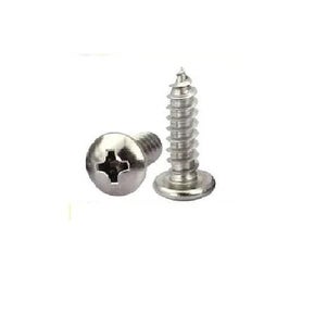

  3. 3mm x 15mm - 2 pieces ( for fan)
