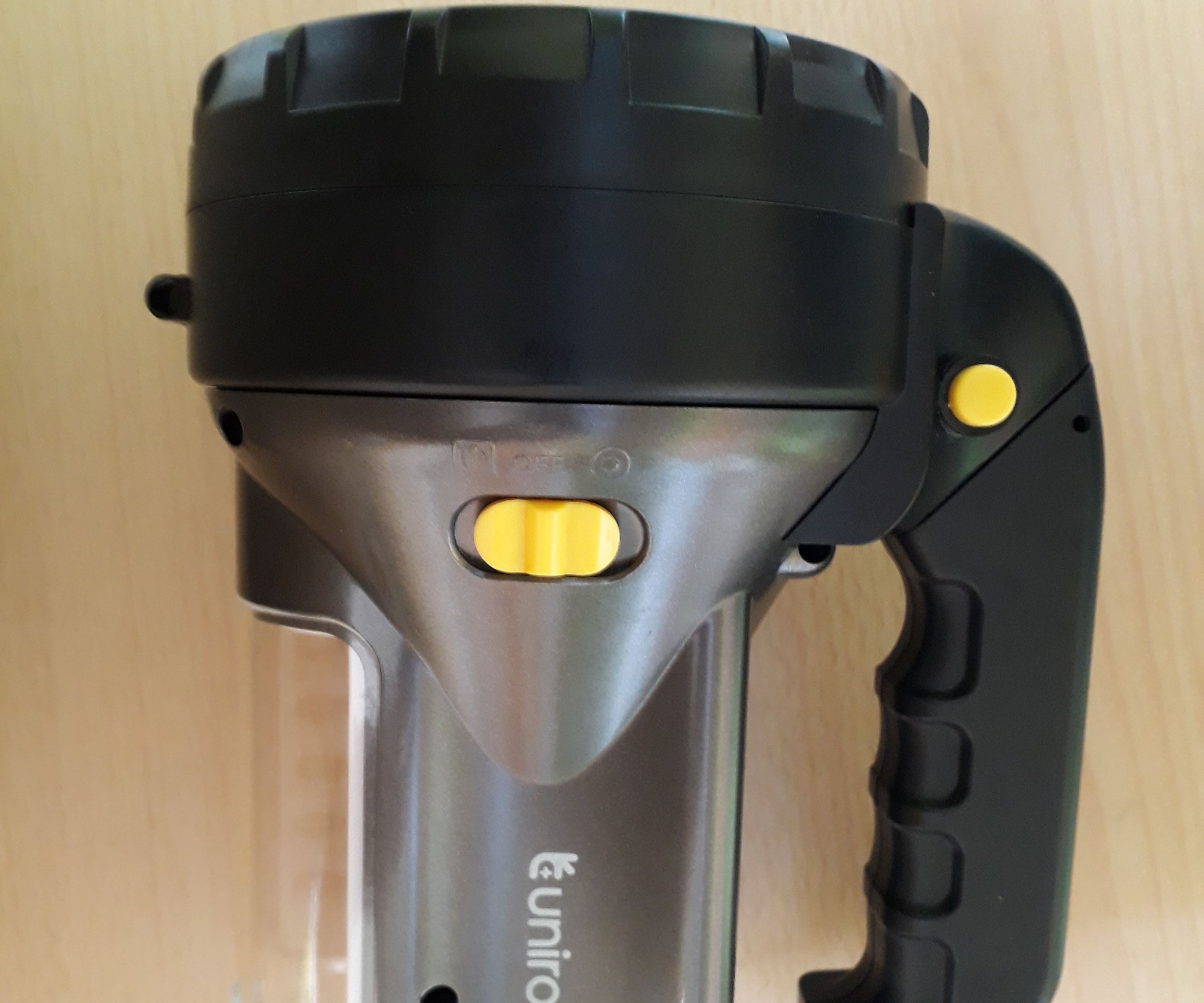

The need for upgrade......
This cheap lamp is quite useful in many cases. It has 24 LEDs and gives good light.
However, when you charge it with the included cable, it does not last more than 15-20 min, and it dims when you need it the most.
This needs to be fixed!
Step 1: Let's Have a Look Inside
Of course bolts are under the gushy pads.
Inside we see a familiar setup. There is a battery with no labels, which looks big enough, but does not hold charge. Seems Li-Ion. And there is a capacitive dropper charger with 4x diodes rectifier and a small smoothing capacitor. This was designed to charge from the mains ~220V.
It also has 2 resistors which limit the current for the 2 brightness modes. It uses both of them in series, or only the small one (2,2 Ohms) in high brightness mode.
