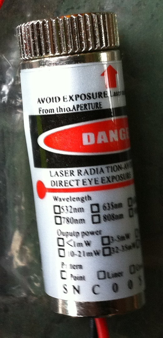

Step 1: Get the Parts
You'll require a nerf gun to modify, and a laser module to install. I got my laser from
http://www.dealextreme.com/p/2-5mw-dot-laser-module-3v-46391
Its a 3 volt module, so I could reuse the pair of AA batteries already in the toy.
DX also has laser modules with a cross shape, and a line. However I figured the dot would be best.
Be wary of 3.7 volt modules on the site, they might not even lase on 3.0V

My laser package was cabled correctly, so all I had to do was strip the ends, solder or twist them, then insulate with tape or heat shrink.
You could use a bit less wire than I did, but there's heaps of space inside the case . Or you could solder the new laser straight to the existing mounts, but I was worried about melting the plastic case.
