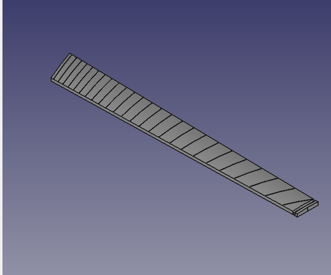

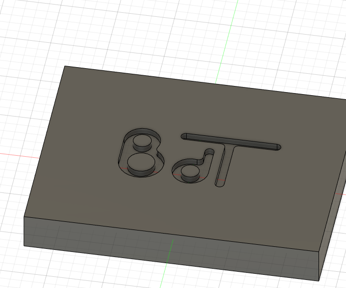

Step 8: Build Your First Project in Fusion 360 or FreeCAD or Any Other CAD/CAM Software
There are many tutorials for that. It's a long story.
Just remember in the end you'll use a post processor for GRBL and produce a GCODE file that will probably have extension .nc
