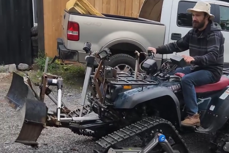

Laying out the mechanics of a dozer blade with 8 ways of articulation, and as much articulation as needed to shape snow park features was challenging. Achieving 8 ways of articulation was possible with 5x PA-17 actuators:
- 2 are used to run the blade cut angle/dump mechanism to achieve a full dump capability
- 1 for up/down motion
- 1 for left/right angle motion
- 1 for left/right tilt motion
He first only upgraded the up/down function actuators and left/right angle, due to cost, and initial uncertainty. After testing for a couple of days bulldozing through sod this spring with ease, Shawn decided to upgrade the last two cheap third-party actuators on the blade. He also ended up deciding to try to see if they were strong enough to run a bucket, so he built a bucket that clips on the blade and ordered an extra PA-17 actuator. Shawn modified every aspect of it using scrap metal, his cheap flux core welder, and an angle grinder. This required a redesign of the cut control function for the blade and having it controlled by two actuators to get enough articulation for the bucket "wrist" (blades cut function) to both tip the bucket back to contain material, and tip forward enough to dump the material.
Step 7: Wiring Controllers and Electrical Protection
Waterproof connectors allowed for blade removal while wiring the electric actuators was quick and simple since they all had a basic 2-wire operation for their brushed DC motors and were 12v compatible. A custom weatherproof plastic box mounted to the handlebar has simple polarity reversing momentary switches that are used as the controllers to operate each PA-17 actuator. There is a singular power feed-in, with a 30 amp fuse for electrical protection. Shawn found the extra size of the motor mounted to the side of electric actuators made installation more of a challenge than with hydraulics, however, the easy routing and flexibility of wires over hoses helped offset those difficulties. From Shawn’s experience, he could run 3 actuators at once without blowing the fuse.
Step 8: Using the ATV Dozer Blade and Bucket Loader Combo
The clip-on bucket was used during the summer for hauling massive loads such as 600 lbs of boulders and cutting through 3" maple roots. Shawn ran them at over 60% duty cycle, days on end, for weeks. Sometimes he'll run them at 100% duty cycle in the winter with no problems yet for shaping and maintaining his snow park, however, we suggest using our PA-17 actuators within the recommended 20% duty cycle rating. The speed added by the 850 lbs gearing has been a great benefit for Shawn, and the PA-17 stainless steel shafts have no failures yet after 1 year in conditions that were 3-4x the abuse of the third-party models with aluminum shafts that failed.
