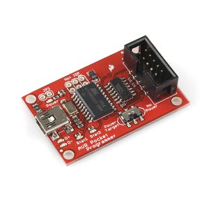

Step 1: Get AVR Programmer and Download Avrdude
For the upgrade, you'll need an AVR ISP. (An example is pictured above). This Instructable uses the USBTiny which is available from Sparkfun here https://www.sparkfun.com/products/9825 You can use your preferred programmer if you like you'll just have to head the avrdude -c option to name your programmer.
To update these chips we need something called avrdude that reads the program and communicates with the AVR and tells it what to do. Basically, avrdude just overwrites whatever is on the chip memory with a new file. For Mac the installation is pretty straight forward. For Mac download the latest Crosspack for AVR (at this link https://www.obdev.at/products/crosspack/download.... ) and run the .dmg. For Windows download the latest WinAVR (found here https://www.obdev.at/products/crosspack/download.... ) and run the .exe. avrdude is a command line tool so there wont be an icon or anything you'll be running it inside of the Terminal or Command Prompt.

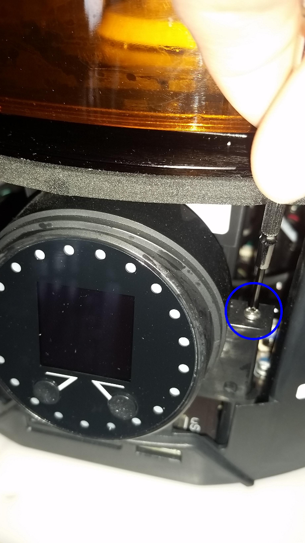

Now you'll program the second AVR which is on the front panel. You'll need to remove the two screws holding the front panel display mount with a phillips screw driver (circled in blue). There is a cable connecting the front panel to the main board so don't just pull it out, it's long enough to leave attached. On the back, you'll see the same two columns of three pins which are the ISP header pins (circled in red). When you plug the USBTiny in the ribbon cable should be pointing to the left, don't miss any pins! Then the process is the same as programming the motor board even the file to upload is the same, open a Terminal and enter:
cd /FOLDER/CONTAINING/TWIBOOT.HEX avrdude -p m328p -u -U flash:w:twiboot.hex -c usbtiny
