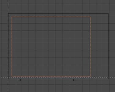

19. If you bought an 8445S, you can use the "Reno45 Panel Cutout.lbrn2" file below to cut the bigger hole. I think the 6445 is identical, but you’ll want to verify the dimensions and drawings in the 6445 and 8445 manuals. The way I did this was to put the acrylic piece on the bed and in Lightburn have it continuously frame the orange tool layer only. That tool layer is the existing hole. Keep adjusting the acrylic piece (or alternatively nudge it in Lightburn) until the red dot grazes the entire hole evenly all the way around. When you’re happy with it, make your cut of the other layer. To make a nice clean cut, I used 15mm/s speed and 45% power at TWO PASSES. Don’t move that piece until you’re certain it cut all the way through!
Notice the little notches cut out on one side of the new hole. The Ruida has a couple protrusions that are intended to snap down under a piece of sheet metal. The acrylic is too thick, so this won’t work. The control panel will just sit inside the hole. You can use a little double-sided foam tape or a bead of silicone or something if you want to, but it fits nicely inside and won’t jostle around anyway.
