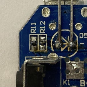

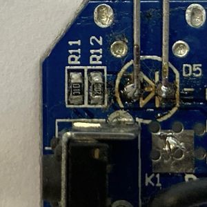

I bought my UV LED from a small local LED supplier here in Australia. The part number is VAOL-5GUV8T4 and I found it on RS components as well for a little more so I assume it is a popular LED for these kind of applications.

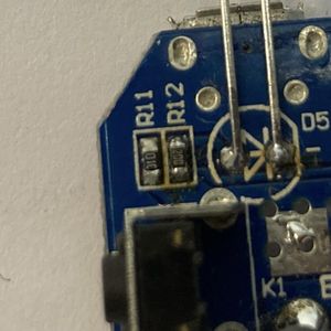

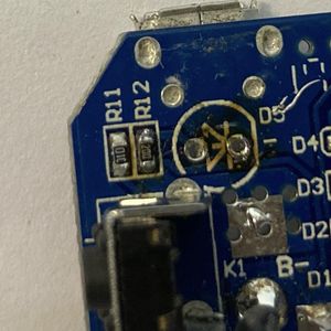

I desoldered the original white LED and temporarily soldered the UV LED on for testing.
I was hoping that the UV LED would work without modifying anything else but it was very dim and my power supply showed the LED was drawing between 10-20mA which is not very much for an LED.
From the datasheet we can find that the LED is rated for a typical forward voltage of 3v at 20mA. As I didn't expect to use this torch very often I had no problems running the LED higher than 20mA. The datasheet recommends a maximum continuous current of 30mA and testing the LED at 25-30mA I was seeing a forward voltage drop of around 3.3V.

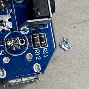

The entire original circuit is based around an IP5305 which is an integrated controller specifically designed for power banks. From the datasheet of the IP5305 I found that the recommended configuration is an LED in series with a 20ohm resistor coming out of pin 5 on the IP5305. Looking next to the LED I quickly found the 20ohm resistor labeled "R12".
Probing each side of R12 with an oscilloscope I saw a voltage of around 3.6V from pin 5 of the IP5305 and 3.3V across the LED (max voltage is labeled as Ma on my scope). The voltage was also not always on and had a duty cycle of ~75%. From here we can calculate using ohms law that the current flowing into the LED when the duty cycle was positive was (3.6-3.3)/20 = 15mA so for an average duty cycle of 75%, average current would be .75*15mA = 11.25mA.
If we wanted 30mA average, we would need a peak current of 30mA/0.75 = 40mA. Again using ohms law we can find the resistance necessary for this current by R = (3.6-3.3)/40mA = 7.5 ohm.

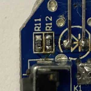

I decided to start by replacing R12 with a 10 ohm resistance. These are 0603 resistors and are quite small so for some advice soldering SMD components check out the procedure I mentioned in step 15 of my flashing PCB heart Instructable https://www.instructables.com/BEAM-Solar-Powered-P...
With a 10ohm resistance I expected an average current of 22.5mA but I was still getting less than 20mA. This is because the output impedance of pin 5 of the IP5305 would likely be quite bad so the more we load it, the less voltage we can get out of it. In fact, when I removed the resistor entirely and checked the voltage it is actually outputting 4V! Just for curiosities sake we can actually calculate the equivalent output impedance as we know that when we load the circuit up with 11.25mA we have a 0.4V drop from the 4V we expect to 3.6V so the output impedance is roughly 0.4/11.25mA = 35ohms. This impedance may not be the same for different output currents but it gives a good ballpark estimate for the impedance we can expect.
In any case, I wanted more current still so I soldered the 20ohm resistor back on top of the 10ohm resistor to put them in parallel which created an equivalent resistance of around 6.67ohms. This gave me an average current of 25mA.

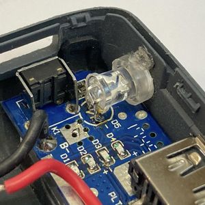

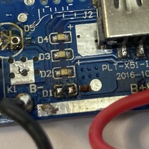

Before soldering the UV LED back in place I decided to do the SMD LED mods as it would be easier to solder some of the SMD components without the UV LED in the way
These new LEDs were quite a simple mod that has been such a game changer in the last week that I have been carrying the new power bank!
The LEDs are 0603 size and I bought a pack of 100 (20 of each of 5 different colours) from the same place I bought the UV LED for on $2.50.
To desolder the original LEDs I just heated both joints at the same time with a large, chisel tip on my soldering iron. The PCB designer in this case was nice enough to include marks for positive and negative side of the LEDs however you could always just remember the direction the original LEDs were, try to work it out from the datasheet, or just do trial and error. To solder the new LEDs I followed the same procedure I mentioned in step 15 of my flashing PCB heart Instructable https://www.instructables.com/BEAM-Solar-Powered-P....
I tested each new LED by replacing one LED at a time and then hooking the circuit up to my power supply at 4.2V.

Step 5: Modification 1: Replace the White LED With a UV, Blacklight LED (part 2)
Now we can solder back the UV LED. First we have to clear out the holes. To do this I usually first apply a bunch more fresh solder. Counterintuitively, more solder is often the easiest way to remove solder as a large blob of solder will hold heat and stay liquid longer than a small amount of solder. Then I hold my iron on the pad for a while and when it is hot enough I remove the iron and quickly blow very hard to blow out the liquid solder. This is obviously not the safest way and makes me quite light headed after a while. As well, one of the pads for this particular component is connected to the ground plane which sucks up heat from the soldering iron, making the solder solidify quicker. As such this trick only worked for one side and I had to use a regular solder sucker for the other.
Then I bend the LED legs at as sharp an angle as I could manage and roughly trimmed them before putting the LED and circuit in place. From here I applied a small amount of solder to the top of the pad just to keep the LED in the correct place, then I removed the circuit carefully and soldered the LED properly.
The light from the LED always bled into the charge indicator lights when on which never bothered me however I figured I should fix it while I was at it so I put black nail polish on the back of the LED and sides of the lens and then used to black heat shrink to mask of the rest of the side of the LED.
