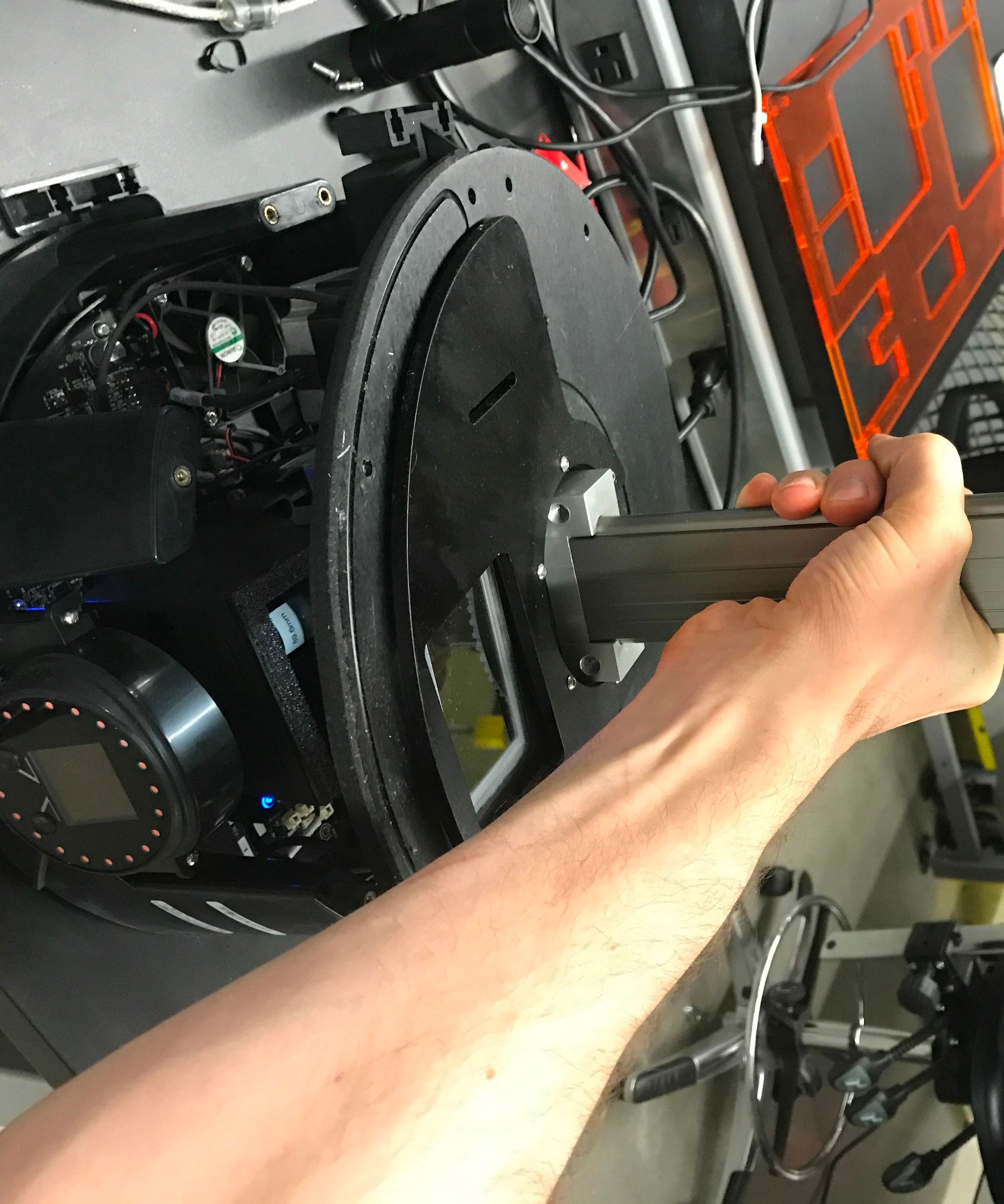

Step 4: Disassemble Your Ember
Disassemble your printer by following Steps 1-8 of this Instructable. Once you've removed the central assembly, come back and continue to the next step.

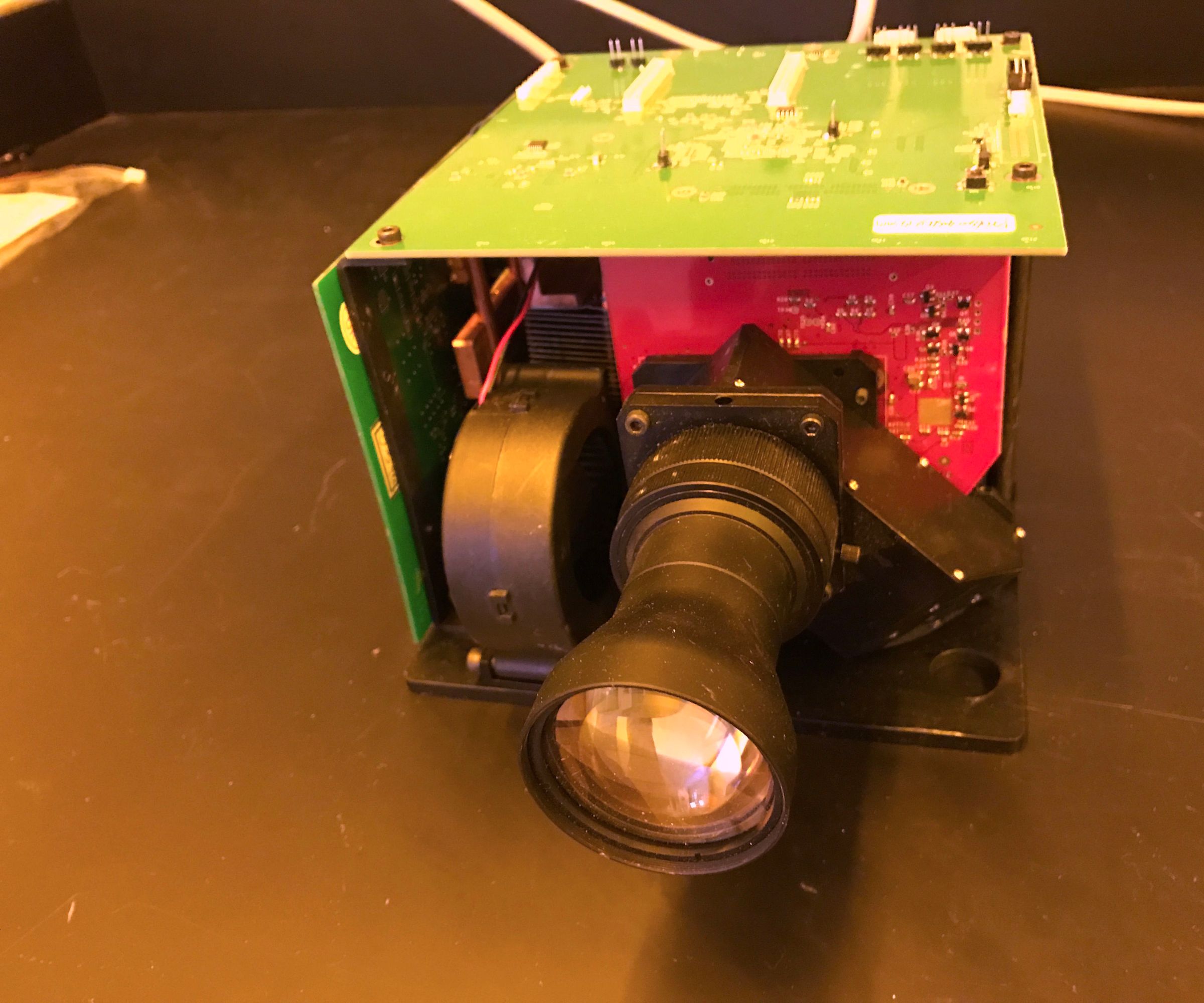

Step 5: Check If Your Projector Has I2C Resistors
Looking down at the projector, with the projector pointing to the left, find the hole on the bottom row that's second-closest to the lower-right corner. It's circled in orange.
In this hole, look for R67 and R68, and see if the I2C resistors are present. The attached images shows a projector with and without the resistors.
If you have the resistors, use a soldering iron to remove them. Firmly press the tip of the iron against each resistor until it comes loose. Make sure it doesn't get lost in the projector electronics (usually it will stick to the soldering iron).
If you don't have resistors, continue to the next step.
Step 6: Install the I2C Cable
Install the I2C cable, making sure that the end of the cable labeled J1 plugs into the Ember control board, and the end labeled J2 plugs into the projector as shown.
