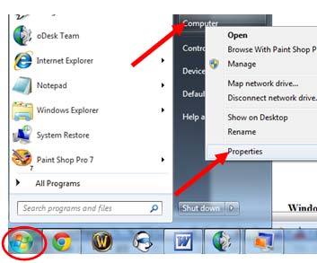

Step 1: Check Your Systems Hardware

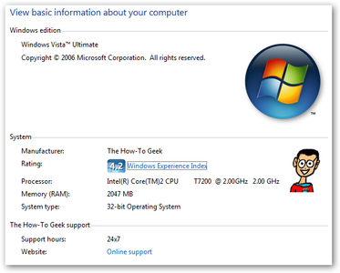

From the desktop click the start button and right click the computer button/icon. From here select properties to view the system hardware. Read over the system hardware and see how much RAM is in use for this computer. Then move on to the next step.

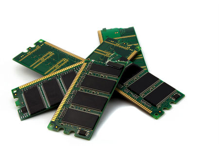

Step 3: Purchasing New RAM
Once you have figured out what and how much RAM you need then you must purchase it. RAM can be bought in stores, online, or even used RAM is available at local computer recycle places. It is crucial that you only get exactly what the specifications allow. It would be pointless to have 8 gigabytes of RAM on a computer that only recognizes 4 gigabytes. If you are unsure you can always ask a sales associate or tech. After the RAM has been purchased move on to the next step.

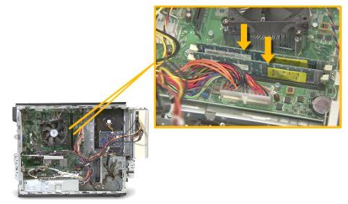

Step 5: Opening the Computer

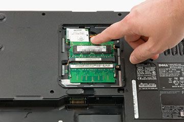

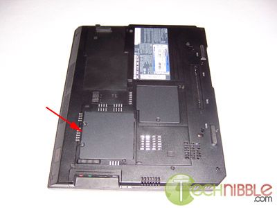

Most computer towers have one screw to remove in order to slide the casing off of the tower. Some casings are snapped on and just nee to be unsnapped. Laptops usually have a small screw on an access door built to easily change out the RAM. Once the computer is open make sure to ground yourself to something metal to stop any static discharge. Locate the RAM and proceed to the next step.
Step 6: Replacing the RAM
Removing the RAM is quite simple once you have located it. First push the hold clamps back on each end/side. Then carefully pull the RAM out of its slot. Place the old RAM in a static free bag or case just in case you need it later. Take the new stick of RAM and push it into the slot or slots where you removed the old RAM from. The clamps will snap into place if you have it set right. Make sure that the RAM is clicked in and tight. If it is not in for any reason you could have trouble powering on your computer/laptop.
