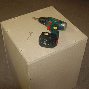

1. Attach the sides to the front and back to create the box shape.
2. Drill 3mm countersunk pilot holes - 2 down each side of the front and back - to secure the sides in place.
3. Secure the base onto the frame with [2] screws along each side.

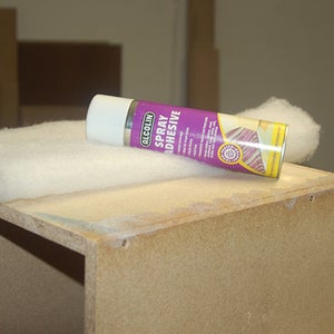

4. Cut a piece of batting to wrap around the sides of the box, leaving some extra at the top and bottom. Secure one end of the batting to the box using sprayable adhesive. Follow the instructions on the can for proper application.
5. Secure the end and then wrap the batting around the box, securing the other end in the same way. Pull away any excess with your hands to avoid any bulky areas.
6. Pull away excess batting at the top and bottom. You only need a thin layer of batting to soften the sharp edges that could eventually tear your fabric.

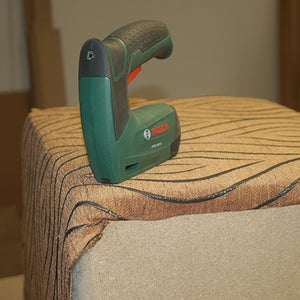

7. Cut your fabric to fit around the ottoman, allowing extra for folding under at both ends, and at least 50mm extra at both the top and bottom for folding under and over

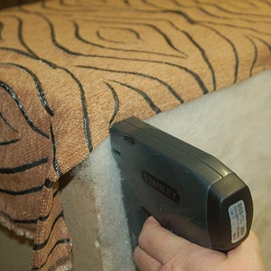

8. Fold under and secure the starting edge of the fabric to the box frame. You only need [3] staples close to the top, bottom and centre to hold the fabric in place. Turn the ottoman to wrap with fabric, making sure to keep even at the top and bottom.
9. Once you know exactly how much fabric is needed to overlap the starting edge, cut away excess, fold under and use iron-on webbing to secure the fold. Also apply iron-on webbing to the edge of the fabric to secure on top of the starting edge.
10. Iron the edge of the fabric over the starting edge, making sure to align with the corner of the box so that this is hardly visible once the ottoman is finished.
11. Now you can begin to fold over and staple the fabric to the base of the box. Start at the centre of one side and then move to the opposite side. Repeat this for the other two sides. Use your hand to smooth the fabric as you work from the centre towards the corners and stop at about 50mm away from each corner, so that you have plenty of space to tuck corners.
12. For the top edge you will also fold under and fold over to secure the fabric to the top edge. Again, start in the centre and work towards the corners, leaving a space for folding and tucking the corners for a neat finish. Gently pull the fabric up the sides - using your hand to smooth - to avoid floppy or loose fabric.

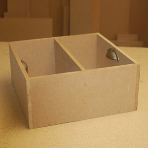

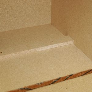

13. Measure down 280mm inside the box and secure the support under this line with [2] screws. This support with hold the storage container in place.
14. I made my storage container using 12mm MDF offcuts, but you can have pieces cut for the 16mm particle board if you prefer. Should you decide to use particle board, allow for the difference in thickness when having the particle board cut to size. Assemble the box as shown.
GOOD TO KNOW:
Although I attached handles on the containers, these aren't really necessary and had to be glued in place using epoxy glue, since the screws supplier were too long.
To provide a washable finish, I applied two coats of clear acrylic sealer (Mod Podge) inside the box.

2. Starting on one side, fold the fabric over and under the staple - starting at the centre and working towards the sides. Stop about 100mm from the corners to leave enough space for tucking the corners. Move onto the opposite side and then repeat this process for the other two sides.
GOOD TO KNOW:
Don't pull the fabric too tight when stapling the opposite sides - just enough for the fabric to be taut and not loose.

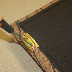

5. The top is mounted to the base using butt hinges. Use a small, flathead screwdriver to make holes in the fabric before attaching the hinges to the lid with 16mm screws, and the hinge to the base with 30mm screws.

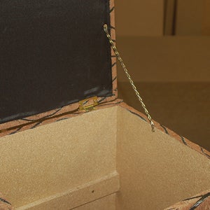

OPTIONAL: To stop the lid from opening too far I attached a piece of chain to the top and inside of the box.
