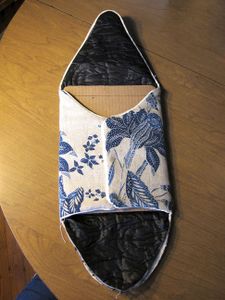

Step 8: Sewing Pocket for Screen Protector
Lay your case down flat on the table, and place your iPad-sized piece of heavy-duty cardboard on top of it. Make sure it is completely centered in the middle of the case and lightly trace the border with a pencil (dotted line on the pattern).
Stitch along this line through both layers of fabric, once again leaving the bottom flap open. This opening will be where you insert the cardboard for your screen protector.
