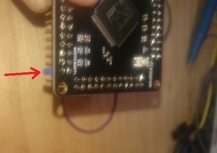

Add a jumper on "BOOT 1" pins (last row)

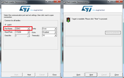

Step 3: Uploading Sketch
Plug the USB adapter in the computer before starting the Demonstrator GUI.

You now need to change the jumper's position to BOOT 0 and reset the board to run your sketch.
The reset button is the one near the micro USB plug.
