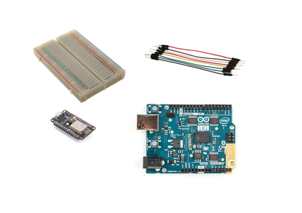

Step 1: Materials
Here's a few things you're going to need before getting started:
  • NodeMCU ESP8266 Bluetooth Module
  • Jumper Wires
  • Breadboard
  • Arduino board

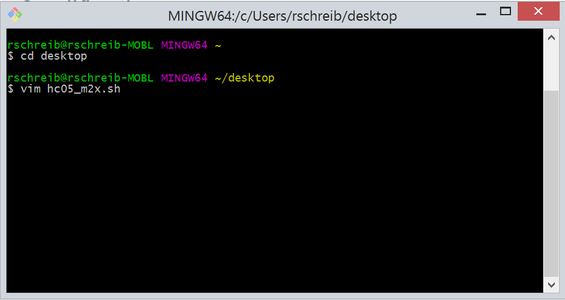

Open up Git Bash on your computer, and navigate to the folder where you want to keep your script. Git Bash uses commands like Linux (cd, vim, mkdir, etc.). To go to a folder, use "cd" without the quotes. For example, I wanted to keep the files on my desktop, so in git bash, I typed "cd desktop".
Type "vim script_name.sh" to create a new script file (and replace with your script name). Copy and paste the script into your file.

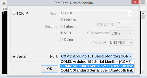

Now it's time to pair your computer with the HC-05 module! Go to Settings -> Change PC Settings -> PC and Devices -> Bluetooth. Make sure the Bluetooth on your computer is turned on, and make sure the HC-05 module is turned on (the red LED on it will be blinking very fast). Select the HC-05 from the list of Bluetooth devices, and enter the pairing code. If your HC-05 has it's default settings, the pairing code should be 1234.
Open up Tera Term and connect to the HC-05. After you've paired with it, two COM ports for it should appear. Choose the lower numbered one. If you successfully connect with the HC-05, the red LED on it should have two quick blinks about every one or two seconds.
We now need to make a log of all data the the HC-05 sends. Go to File -> Log..., and choose where to save the log.
