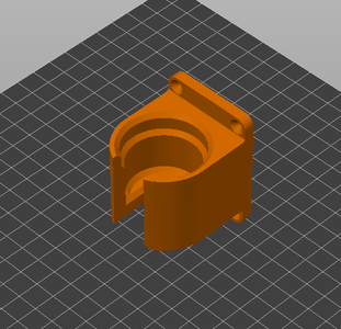

On the right side of the closet, I mounted the water valve and I fixed it to the wood by mouning the hose connector on the inside, which will be connected later on to the 2-way divider water line.
Additionally I 3D printed a hose wall holder to keep everything tidy.
