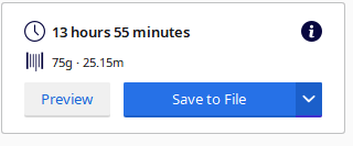

75 grams of PLA filament, a 3D printer that can print superfine (I used a Dremel 3D45), 14 hours, and a prayer that it will not warp. My design was designed in TinkerCAD, transferred to Cura and then the Dremel software, but the design can be done in Blender (NOT recommended for AutoCad-nightmare to map the states)

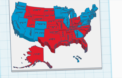

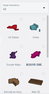

Step 1: Getting the States in Tinkercad
On the Tinkercad shape menu, go to the shapes dropdown menu. Select Shape Generator-All. The United States States should be the very first one on the list.
(I might do one for China and Europe in the Future...)
Step 2: Arrange the States in the Proper Order
This step is going to take a long time, and for best results try to get the borders as aligned as possible. I also colored them based on the 2020 election, but that is not necessary. My board's dimensions were 9.5"x9.5", but do not stress over the size since it will eventually be resized down. Some Tips:
Turn off Snapgrid(or as low as you feel comfortable) to bring them as close together as Tinkercad will allow
Use Shift+Right click to move around the workspace (I didn't know how to do this until afterwards, but it will be a BIG help)
Step 3: Give the States a Textile Feel
Change the height of each state so that you can clearly see the border of each state. I overtried and sized them accordingly to the population per state, though a random pattern will work. I would recommend a .02 mm distance at LEAST, though you might have to make them bigger if you are using a lower quality printer.

Step 4: Get the Braille Generator Text Box
This is a really cool tool, along with the other text tools, that can come in handy in scenarios other than this. On the Shape menu dropdown box, select Shape Generators-All (same as before). Go to the second page and it should be right next to the Hebrew Generator. Make 50 (51 if you include D.C., I did not) copies and type the correct states.
Step 5: Put the Braille Onto the States
THIS IS THE LONGEST STEP!! It took me 3 days to complete it. You have to resize each text box to the appropriate size and center it onto the state. Make sure that are at least .2mm larger than the state that they are being placed on. Rotate them to keep on the state bordersThe aligning tool really came in handy...
NOTE: I am not entirely sure, but I might have rotated some upside down. If so, please let me know and I will fix it.

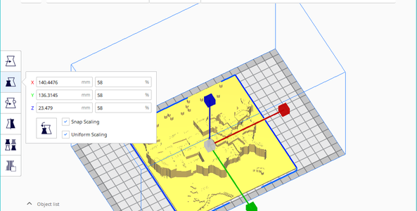

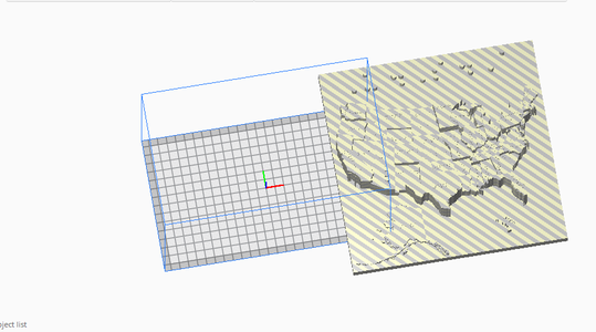

Step 6: Export Out of Tinkercad, and Print!
Mine had to be scaled down a bit in Cura to fit ( around 58%). I printed on a Dremel 3D45 with PLA, but any printer and any filament can be used. I would not recommend ABS, however, since it might warp.
