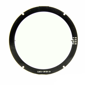

The first step i did was solder wires to my parts. This was especially needed for the neopixel ring because there weren't any convenient connections for testing. The neopixel ring I used had it's connections flat on the backside. The ring has 4 connections. A 5v, ground, data input and output connection. Because there's only one ring in this project the data output can be left alone. The 5v and ground can be easily connected to their respective points on the arduino. But for the data input it's recommended to put in a resistor between 100 and 1k ohm.

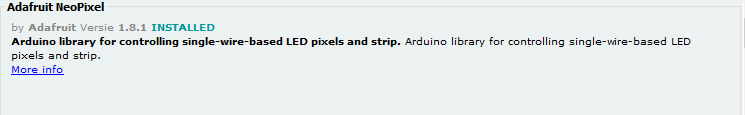

Having soldered the lights it was time to get them working. To work with the neopixel ring I installed the adafruit neopixel library in the arduino IDE. This library has a few example projects of which I used one to test if the connections were working.
After confirming the lights were working I wrote some code that makes part of the ring light up depending on the rotation of the rotary encoder. With this code rotating the rotary encoder rotates the lights that are turned on.

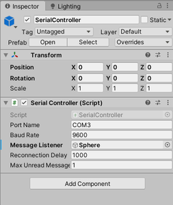

To connect the arduino with unity I used Ardity. Ardity is a Unity package that allows Unity to send and receive information from an arduino. The scene I made is one with the earth in front of a dynamic background. The virtual earth will be lit like the earth is lit based on the system time.
Ardity receives the information from the arduino and sends it to a customizable script. The script below receives the information from Ardity and uses it to rotate The earth in Unity.
using System.Collections;<br>using System.Collections.Generic;<br>using UnityEngine;<br><br>public class RotateEarth : MonoBehaviour<br>{<br>    //public GameObject sun;<br>    int lastMsg = 0;<br>    // Start is called before the first frame update<br>    void Start()<br>    {<br><br>    }<br><br>    void OnMessageArrived(string msg)<br>    {<br>        if (float.Parse(msg) <= lastMsg)<br>        {<br>            transform.Rotate(0, 0, 18);<br>            //sun.transform.Rotate(0, -18, 0);<br>            lastMsg = int.Parse(msg);<br>        }<br>        else if (float.Parse(msg) >= lastMsg)<br>        {<br>            transform.Rotate(0, 0, -18);<br>            //sun.transform.Rotate(0, -18, 0);<br>            lastMsg = int.Parse(msg);<br>        }<br>        Debug.Log("msg arrived");<br>    }<br><br>    void OnConnectionEvent(bool success)<br>    {<br><br>    }<br>}<br>

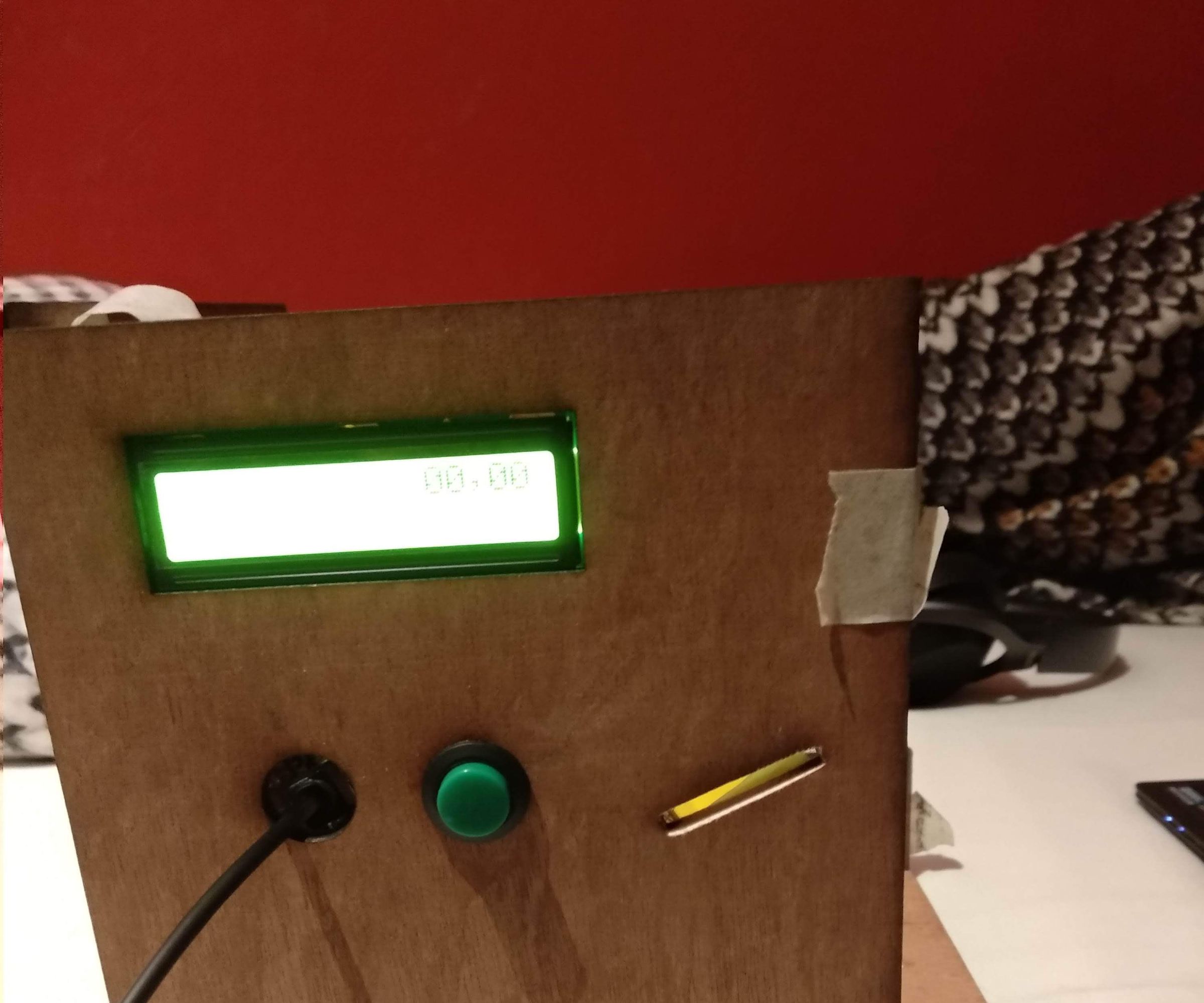

In the previous section I talked about the improvements I wanted to do to my project. The first one I want to talk about is the case. In the previous version the neopixel ring was glued to the top of the case with only a small hole for the cables. In the new version I embedded the ring into the case. To do this I Seperated the top of the casing into two parts with a ring the size of the neopixel ring inbetween. I also 3d printed a part with a hole for the cables. When assembling I put the neopixel ring on the 3d printed part and could then attach that to the casing. The result is that the leds don't look like an afterthought anymore.
Another Improvement I made was using bearings to attach the globe axis to. To help with that I 3d printed a part that would hold the bearings in place. between the two bearings I put a piece of tape to make extra sure the axis wouldn't start sliding down. This seemed to help without any negative effects to the turning resistance.
Another change I made is with the working of the light ring. In the previous version the ring rotated with the globe. In the new version the ring will show the time. For every hour a light will turn on. Because the arduino only reads 1 character at a time from the serial port I had to be a bit creative how I would communicate the time between unity and the arduino. My solution is to use a switch case and depending on the hour Unity will send the letter corresponding to that number to the arduino. So at 01:00 Unity will send "A" and at 02:00 Unity will send "B" etc. The arduino then reads that and uses a switch case to put the right time into a variable it uses to turn on the lights.
