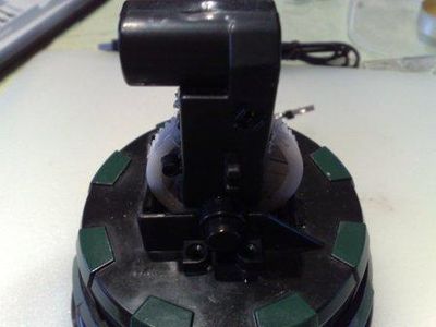

Step 1: Hack and Modify Usb Missile Launcher
You need to modify the PAN / TILT system for better move.
Before mod :
Pan : 340 ° in 17 seconds
Tilt : 45 ° in 2 seconds.
initialisation neutral position : 9 seconds
After :
pan 355° and tilt around 70°
Unscrew base.
Before mod :
After :
Unscrew base.
