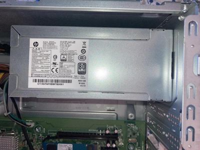

This is the 4th revision of this project. This greatly simplifies the required parts & wiring.
Many newer HP Desktops come with a proprietary PSU (Power Supply) & Motherboard. These PSU's are often low wattage leaving little room for system expansion. Higher wattage PSUs can be purchased but are expensive & still limited. A PSU upgrade will allow for a Graphics Card (GPU) in your system or even replace a broken PSU for cheap.

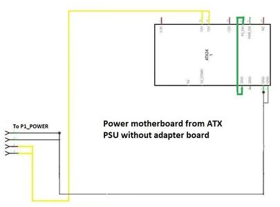

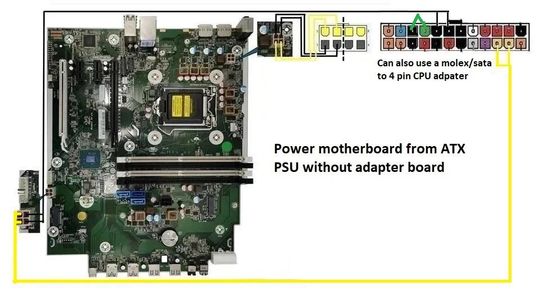

Many of the HP desktops can be booted with a standard ATX PSU but result in the PSU always running. This is fine for many, but can cause issues. Luckily this can be fixed by following this guide.
This guide will only work with HP PSU's that use 2 4 Pin(CPU Power style) connectors for power & a 7 pin connector for the motherboard. (See Step #2). This will NOT work with 6 pin HP power supplies

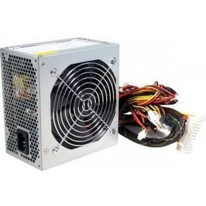

1: PSU:
  1. ATX, TXF, Flex ATX, etc. Just needs to follow ATX standard with a 20 or 24 pin connector.
  2. Minimum 2 amps on 5v VSB rail. Not a problem on modern supplies.
  3. Look for one with hefty 12v rail(s). The entire PC will be powered off 12v. If using a GPU this is extremely important.

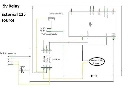

2: Boost converter module:
  1. Needs to support 5v input & 12v output. Minimum 2 amps output.
  2. MT3608 & Xl6009 are common choices.

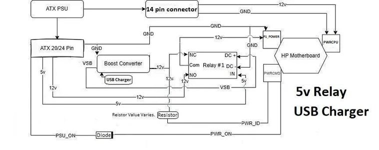

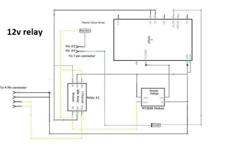

3: Relay module:
  1. 5v is preferred. 12v will work but requires a few modifications (See step #11).
  2. Common relay modules are rated at 10 amps. 10 amps is plenty.

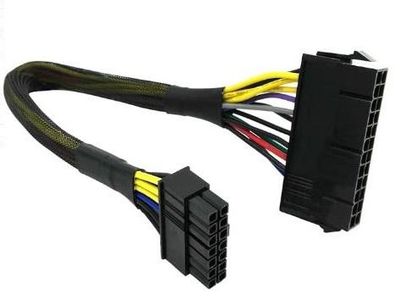

4: 24 Pin to 14 Pin ATX Wire (For Lenovo PC's)
  1. Converts female 24 pin ATX to a 14 pin connector commonly used on Lenovo Desktops.
  2. Must be for Lenovo PC's not Dell. The Dell ones will not work.
  3. This adapter was chosen because it has all the necessary wires broken out & the 14 pin connector is compatible with HP.
  4. Some wire colors may vary due to different manufactures. Please use wire positions versus colors to confirm.

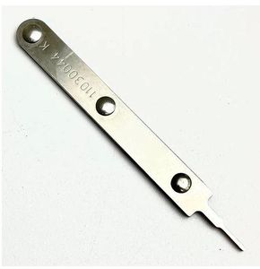

1: Molex/ATX Connector Extractor/Removal tool
  1. You will need to remove wires from the 14 pin connector. The tool can be picked up for around $10. If you don't have one, 2 flat staples will work (YouTube is helpful).
You can avoid pin removal if you purchase a 4 Pin CPU Extension cable instead & splice it in. See step #11 for help.

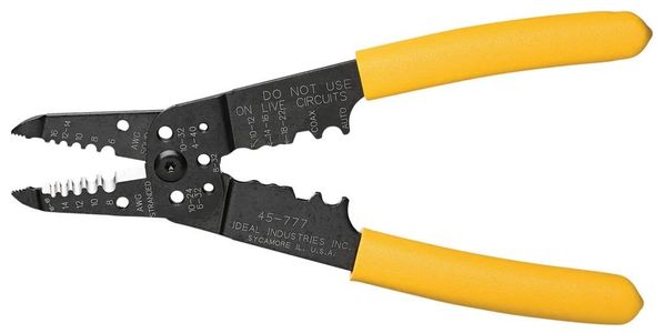

3: Wire Strippers/Scissors:
  1. Someway to strip & cut wire.

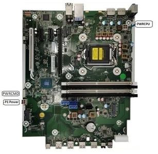

Connectors:
PWRCMD Connector = 7 pin connector on HP motherboard. HP PSU connects to it. Not all PSU's use all 7 pins. Some only use 3.
P1_Power = 4 Pin connector closest to the PWRCMD connector. Location depends on motherboard. Typically is closest to the PSU, HDD Power Header, & SATA Ports.
CPUPWR = 4 Pin connector closest to the CPU. Sometimes is under a plastic fan shroud. Location depends on motherboard. Typically is closest to rear I/O ports.

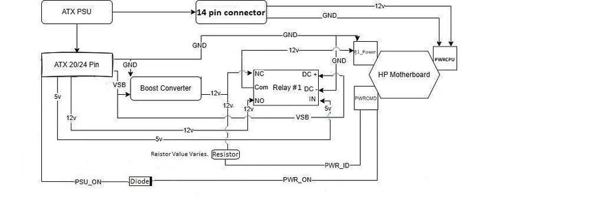

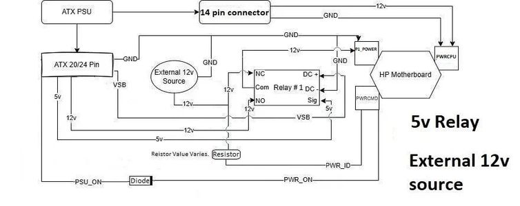

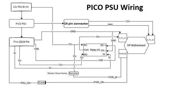

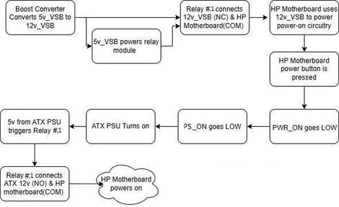

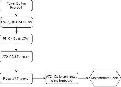

Step 2: How It Works?
The original HP PSU is always outputting 12v to the two 4 pin connectors (1P_POWER & PWRCPU). This is the equivalent of keeping the green & black lines on an ATX PSU jumped.
When the power button is pushed the motherboard pulls pin #4 (PWR_ON) of PWRCMD connector LOW. Pin stays LOW until the PC is shut off or power is lost. It then returns to HIGH.
Pin #3 (PWR_ID) of the PWRCMD connector is the equivalent of ATX PWR_OK. If the line is never OK (HIGH) the PC won't boot. This wire is connected to a constant 12v source via a resistor. The resistor value varies depending upon HP PSU model. See Step #10 for finding the correct resistor value.

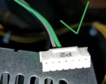

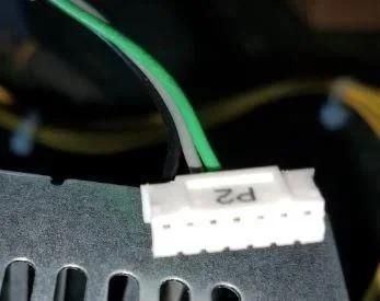

The PWRCMD connector pins are:
#1 Ground (Black wire)
#2 PWR Meter (Purple wire)
#3 PWR_ID (Grey wire)
#4 PWR_ON (Green wire)
#5 Ground (Black wire)
#6 Fan_Tach (White wire)
#7 Fan_CMD (White & red striped wire)
Not every PSU uses all 7 pins. Many only use 3 (GND, PWR_ID, PWR_ON). I have not found any issue leaving PWR_METER & Fan_CMD disconnected.

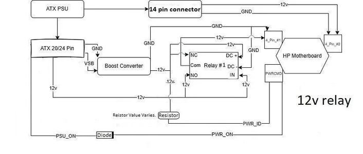

How this project works:

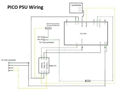

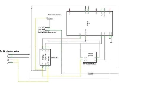

The relay module is powered off the ATX 5v_VSB line.
The ATX PSU PS_ON wire is connected to the HP PWR_ON wire via a diode. Diode cathode is facing motherboard PWR_ON pin.
The boost converter input is connected to the ATX 5v_VSB.
The HP PWR_ID is connected to the boost convertor 12v output via a resistor.
Relay #1 has the COM terminal connected to the 12v pins of the P1_Power connector on the motherboard. The NC relay terminal is connected to the boost converter 12v output. The NO relay terminal is connected to the 12v line of the ATX PSU. The relay triggers on a signal from the 5v line on the ATX PSU(Not the standby).
The boost convert supplies constant 12v to the P1_Power connector. When the power button is pressed PWR_ON is drawn LOW, which brings PS_ON LOW, which switches on the ATX PSU. Once the PSU is on it triggers relay #1 which connects the ATX PSU's 12v lines to the motherboard, disconnecting the boost converter.

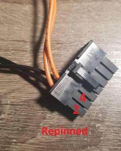

The hardest part of this tutorial is getting the pesky pins out of the connector. This tutorial assumes you know how to do that. If not a quick web search should help out.
  1. All the pins in the 14 pin connector need to be removed
  1. The white/grey, blue, 1 black wire, & the double orange/yellow wires need to be removed from the 24 pin ATX connector.
If your don't want to remove all the pins....
  1. Cut all the wires in the 14 pin connector except for the 3 orange/yellow , 2 black, & blue which must be removed instead. Try to cut as close to the connector as possible.
  1. 1 black, white/grey wire, & blue wires on the 24 pin connector can be cut. One wire of the double orange/yellow wire can be cut. Make sure to NOT cut both.
You should have a white/grey, black, blue & orange/yellow wire not connected. The white/grey & black need both ends removed. Keep the end(s) on the blue & orange/yellow wires.
NOTE: I swapped the blue & orange wires on my adapter. That is why my images are different then the description. Either way will work but my way required removing pins from the 24 pin connector. It is preference only.

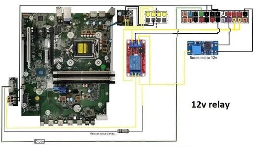

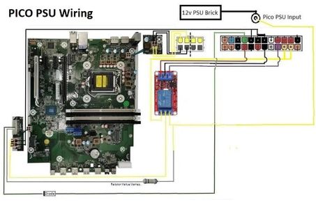

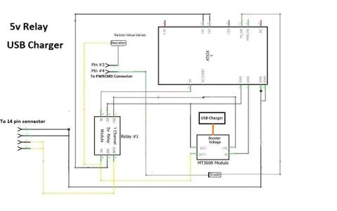

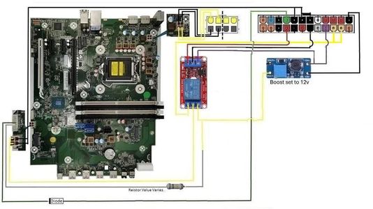

Step 4: Wire It Up
Wiring is simple. Follow the below description & images for guidance.
Make sure the boost converter output is set to 12v before assembly! 12.2v is the absolute max to set.
From 24 Pin Connector:
  1. Connect the red wire to the relay IN terminal
  2. Connect a black wire to the relay DC - terminal
  3. Connect the purple wire & the extra black wire
  4. Connect the purple wire & the cut black wire to the relay DC + terminal
  5. Connect the two orange/yellow wire to the relay NO terminal.
  1. Connect 2 black wires to the side of the 14 pin connector opposite the latch. Use the rightmost 2 positions. See attached images
  2. Connect the cut orange & blue wires to the relay COM terminal.
  3. Connect the other end of the cut orange & blue wires to the 14 pin connector in positions opposite the 2 black from the previous step.
From Boost Converter:
  1. Connect cut black wire to the VIN + pin
  2. Connect the remaining black wire from the 24 pin connector to VIN - pin
  3. Connect the cut white wire to OUT + Pin
  4. Connect the other end of the cut wire to the Relay NC pin
Resistor & Diode:
  1. Calculate the correct resistor value by visiting step # 10
  2. Connect one end of the resistor to the relay NC terminal (with the white wire).
  3. Connect the other end of the resistor to a Dupont wire.
  4. Connect the diodes anode to the green wire on the ATX 24 pin connector.
  5. Connect the diodes cathode (stripe) to the other Dupont wire
I made many revisions to my adapter throughout the process. Some images & videos may be inconsistent due to changes/improvements. The behavior seen is the same across all adapter revisions.
Step 5: Hooking It Up
1. Make sure PSU is unplugged from AC Main Power.
2. Plug the 4 pin or half the ATX PSU's 8 pin(4+4) CPU connector into the PWRCPU connector.
3. Plug the 14 pin connector into the P1_Power connector. Orient the connector so the latch is towards latch catch on the jack. Connector will only fit one way. Orange/yellow wires should be closest the latch catch.
NOTE: The latch will not align with the catch. This is to be expected.
4. Connect the Dupont wire with the diode to the PWR_ON pin on the PWRCMD connector.
5. Connect the Dupont wire with the resistor to the PWR_ID on the PWRCMD connector.
5b. Connect FAN_tach pin on the PWRCMD connector to the corresponding fan pin(if needed. See Step #6).

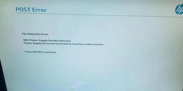

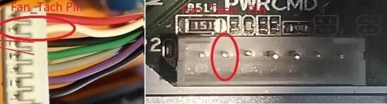

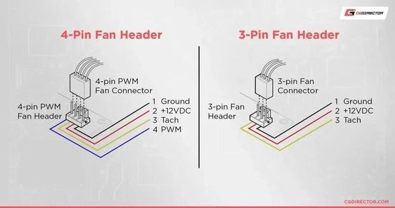

Step 6: Fan Error
On some HP PSU's the PSU fan is used as a system fan. Without this fan present the PC will present error 90E on POST saying a PSU fan is not present. The PC will still boot but the error is annoying.
An easy way to tell if you need this fan modification is to see if you have a wire in position #6 (Fan_Tach) on the PWRCMD connector. If so you will need to follow this step. The example Elitedesk 800 G3 requires this fan mod.
The PSU fan communicates with the motherboard via Pin #6 (Fan_Tach) on the PWRCMD connector. This pin is looking for a Tach signal from a fan. You have a few options:
  1. Run a jumper wire from a different fans Tach pin to the Fan_Tach pin. Any fan will do, even the CPU.
  1. Rig up a fan in the PC. Tie into any 12v & Ground source to power the fan. Connect the Tach pin to the Fan_Tach pin on the PWRCMD connector. Fan will always run full speed.
  1. Add a Tach controlled fan to the ATX PSU. Remove the original fan from the ATX PSU & swap in a new 3 or 4 pin fan. Run a wire outside for the Tach connection. Connect to the Fan_Tach pin on the PWRCMD connector
CAUTION: Be careful when opening an ATX PSU. Dangerous voltages are present & lethal.
Both 3 & 4 pin fans will work. On a 4 pin fan the PWM pin will remain unused.

Step 9: Debugging Power Rails
Most issues I find result from low current on the boost converter 12v standby. This is due to a low 5v_VSB rail current or a poor quality boost converter. Here are two ways to eliminate that as a potential issue:
Eliminate boost converter:
You will need:
  1. Adapter board (from this tutorial)
  2. 12v power supply. 2+ amps. The OEM HP PSU will work (The yellow wires are 12v & black are ground).
  1. Unplug the ATX PSU from the mains power.
  2. Disconnect the boost converter from the circuit.
  3. Connect the ground of the 12v power supply to the ground of your adapter.
  4. Connect the 12v positive of the 12v power supply to the relay NC terminal.
  5. Plug in the ATX PSU & the 12v Power supply into AC mains power.
  6. Press the power button on the motherboard
This replaces the boost converter with a separate 12v source. If it boots it means the issue is boost converter related.
The quality of the boost converters vary greatly, can not hurt to purchase a few and swap them around to debug.
Eliminate 5v_VSB not enough current:
You will need:
  2. 5v Cell Phone charger. 2+ amps. Either micro USB or USB-C depending upon the MT3608 converter.
  1. Disconnect the 5v_VSB wire between the ATX PSU & the boost converter VIN+ pin.
  2. Connect the USB cell phone charger to the boost converter via the micro or USB-C cable.
  3. Plug in the ATX PSU & the USB cell phone charger into AC mains power.
  4. Press the power button on the motherboard
This replaces the boost converters 5v_VSB input with the 5v from the USB Cell Phone charger. This will help determine if the ATX 5v VSB line current is too low.
If it boots it means the issue is related to the ATX 5v_VSB line.
To boot the HP Motherboard from an ATX PSU without an adapter board:
  1. Plug in the 4 pin (or 8(4+4)) CPU connector to PWRCPU connector.
  2. Connect 12v & GND lines from the ATX PSU to the P1_Power connector
  3. Connect the ATX PS_ON & GND with a jumper.
  4. ATX PSU will always be on. Needs to be unplugged to power off. HP motherboard should work as intended asides from sleep & hibernate functions.
Step 10: What Resistor for PWR_ID?
Thank you to user Kapuninja for your submission on using a resistor for the PWR_ID pin. This is how the OEM supplies work.
Below are some power supply models & their corresponding resistor values. Your resistor may vary depending on PSU. If so please comment so I can add it to the list.
HP PSU Model: OEM Resistor Code:OEM Resistor Value:Value Tested With:
D16-180P2A 57D 383K ohm 330K ohm
D19-180P1A 86D 786k ohm 750K ohm
HP Z2 G4 PC was confirmed working with a 100K ohm resistor. PSU model is unknown.
To find your resistor value without PSU disassembly:
  1. Disconnect HP PSU from AC main power
  2. Disconnect all HP PSU connectors from motherboard
  3. Stick a multimeters positive(red) probe into one of the two yellow wire plugs on the PSU P1_PWR plug.
  4. Press the negative(black) multimeter probe against the PWR_ID (grey) pin on the PSU PWRCMD connector.
  5. Set the meter to 2M
  6. Read the value. I got .378 for my power supply.
  7. Multiply your value by 1 Million (1,000,000). I got 378,000 (378K)
  8. Find the closest resistor value. Visit: https://neurophysics.ucsd.edu/courses/physics_120/resistorcharts.pdf
  9. That is the resistor value you need. There is some tolerance with values required.
The closest to 378K ohm is 380K. I had a 330K on hand and it worked fine.
If your desperate, I had luck connecting the ATX PWR_OK & HP PWR_ID pins directly. These are different voltages, so be careful.

  1. A 12v relay can be used instead of 5v:
  1. Do NOT connect the red 5v line from the 24 pin ATX female connector to the relay module IN pin.
  2. Connect a 12v line from the 24 pin ATX female connector to the relay module IN pin.
  3. Do NOT connect the relay modules DC+ pin to the boost converts VIN+.
  4. Connect the boost converter OUT+ to the relay modules DC+ pin. A jumper from the relay module NC to DC+ pins will work.
Pico PSU:
A PicoPSU can be used. Make the adapter according to this guide except instead of a boost converter; connect the 12v input from the PicoPSU to the relay modules NC pin. Great for a PSU replacement without modifying the PC case.
