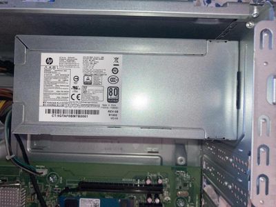

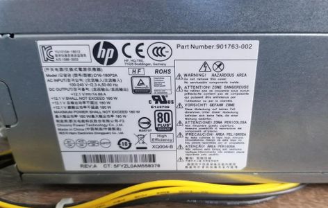

Many newer HP Desktops come with a proprietary PSU & Motherboard. These PSU's are often low wattage leaving little room for system expansion. A higher wattage PSU can be purchased but are expensive & still limited. A PSU upgrade will allow a more powerful Graphics Card (GPU), extra hard drives, & more in your system. It even can replace a broken one on the cheap.
Many of the HP desktops can be booted with a standard ATX PSU but it requires the ATX PSU's green wire to be always grounded, resulting in the PSU always running. This is fine for many, but can cause issues. Luckily this can be fixed by following this guide.
This guide will only work with HP PSU's that used 2 x 4 Pin(CPU Power style) connectors for power & a 7 pin connector for the motherboard. Does not matter how many of the 7 pins are used, any configuration will work. (See Step #2). This will NOT work with 6 pin HP power supplies
Confirmed Compatible PSU Models:
D16-180P2A*
PA-3401-1
DPS-310AB
D19-180P-1A*
*= Personally Confirmed

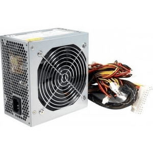

1: PSU:
  1. ATX, TXF, Flex ATX, Pico PSU, etc. As long as follows ATX standard with a 20 or 24 pin connector.
  2. Minimum 2 amps on 5v VSB rail. Not a problem on modern supplies.
  3. Look for one with hefty 12v rail(s). The entire PC will be powered off 12v. If using a GPU this is extremely important.

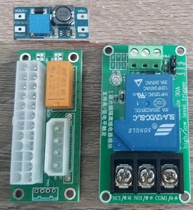

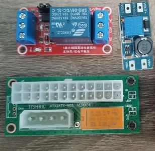

2: Boost converter:
  1. Needs to support 5v input & 12v output. Minimum 2 amps output.
  2. MT3608 & Xl6009 are common choices.

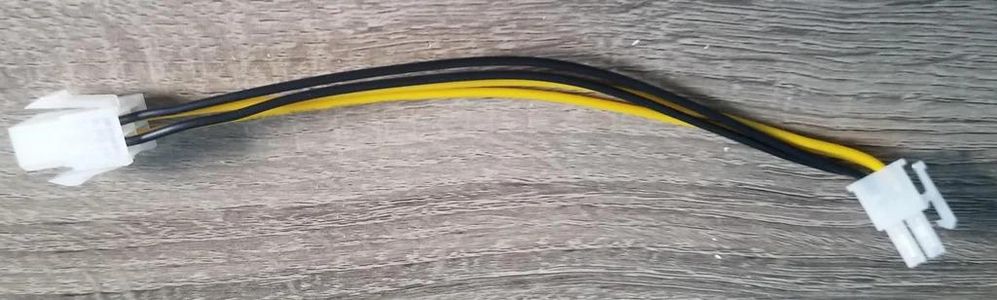

3: 4-Pin CPU Power extension cable:
  1. Needs to reach from adapter board you are making to 4_Pin_#1 connector.
  2. Only need the male end. Any cable with a male 4 pin CPU connector will work. Can cut off the original HP PSU.
4: Relay module:
  1. Either 5v or 12v. 5v is preferred. This tutorial will show both options.
  2. Common relay modules are rated at 10 amps. 10 amps is plenty.
  3. This tutorial will use a 10 amp relay for 5v descriptions(Red & Blue) & a 30 amp relay(Green & Blue) for the 12v. This is not required, just used to keep things organized.

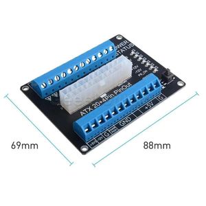

5: ATX Female plug/board
  1. Any female ATX plug(Same end as a motherboard).
  2. An extension cable is easiest.
  3. I used one a "Dual power Supply Sync Adapter". (Search that)
  4. Be cautious with ATX breakout boards as they do not always break out the required 5v VSB line.

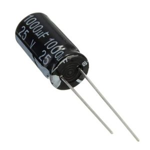

8: 1000uf capacitor (or larger):
  1. Value is not critical. I found 1000uf to be the minimum required for an Elite Desk 800 G3
  2. Some machines may require a larger value. Adding a GPU may require a different value.
  3. 16v minimum.
  4. Many users report this as unnecessary. Your experience may vary.

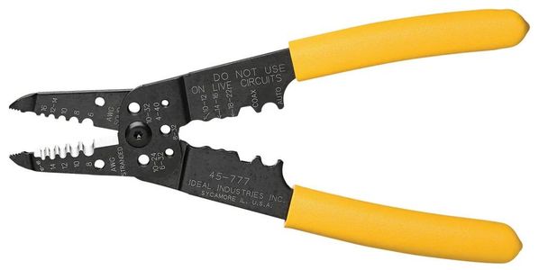

2: Wire Strippers/Scissors:
  1. Someway to strip & cut the wire to length.

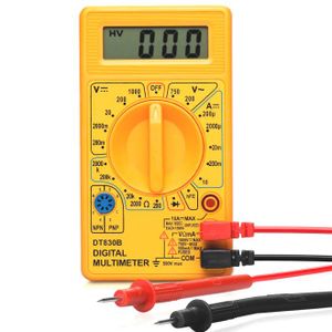

4: Multimeter
  1. Never hurts to check things & debug.

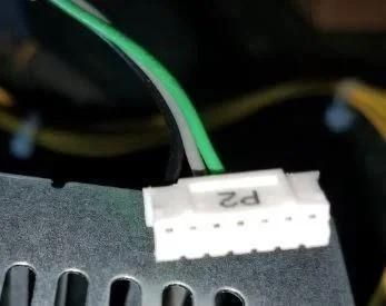

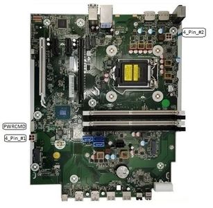

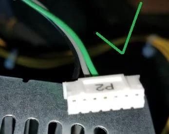

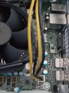

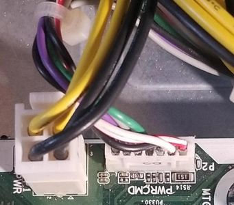

PWRCMD Connector = 7 pin connector on the HP motherboard. HP PSU Connects to it. Not all PSU's use all 7 pins. Some only have 3 positions populated.
4_Pin_#1 = 4 Pin connector closest to the PWRCMD connector. Location varies depending on motherboard. Typically is closest to the PSU, HDD Power Header, & SATA Ports.
4_Pin_#2 = 4 Pin connector closest to the CPU. Sometimes is under a plastic fan shroud. Location varies depending on motherboard. Typically is closest to rear IO ports.

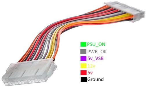

ATX PSU:
PS_ON = Green wire on ATX PSU that turns on PSU when connected to ground.
PWR_OK = Grey wire on ATX PSU that tells PC the Power supply is started up and ready.
5V_VSB = Purple wire on ATX PSU. Supplies 5v to the PC even when powered off. Used for motherboard power on circuitry & USB port charging when off.

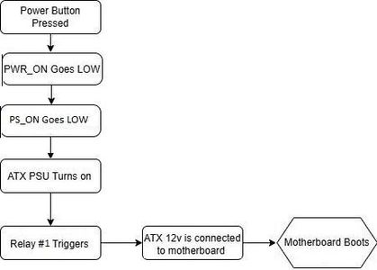

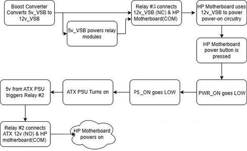

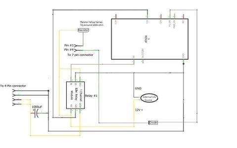

Step 2: How It Works?
The original HP PSU is always outputting 12v to the two 4 pin connectors. This is the equivalent of keeping the green & black lines on an ATX PSU jumped.
When the power button is pushed the motherboard pulls pin #4 (PWR_ON) of PWRCMD connector LOW. Pin stays LOW until the PC is shut off or power is lost. It then returns to HIGH.
Pin #3 (PWR_ID) of the PWRCMD connector is the equivalent of ATX PWR_OK. If the line is never OK (HIGH) the PC wont boot. This wire can be connected to a constant 12v source via a resistor. Resistor value varies depending upon original PSU model. Try around 100K Ohm to start. See Step #10 for more details

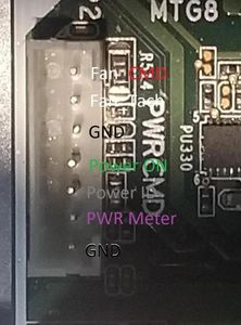

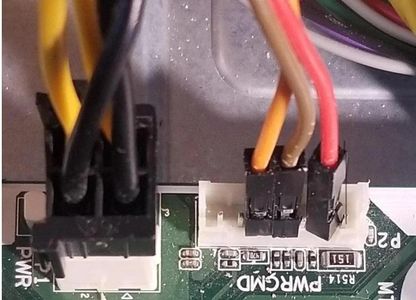

The pins on the PWRCMD connector are:
#1 Ground (Black wire)
#2 PWR Meter (Purple wire)
#3 PWR_ID (Grey wire)
#4 PWR_ON (Green wire)
#5 Ground (Black wire)
#6 Fan_Tach (White wire)
#7 Fan_CMD (White & red striped wire)
Not every PSU uses all the pins. Some only use 3 (GND, PWR_ID, PWR_ON). I have not found any issue leaving PWR_METER & Fan_CMD disconnected.

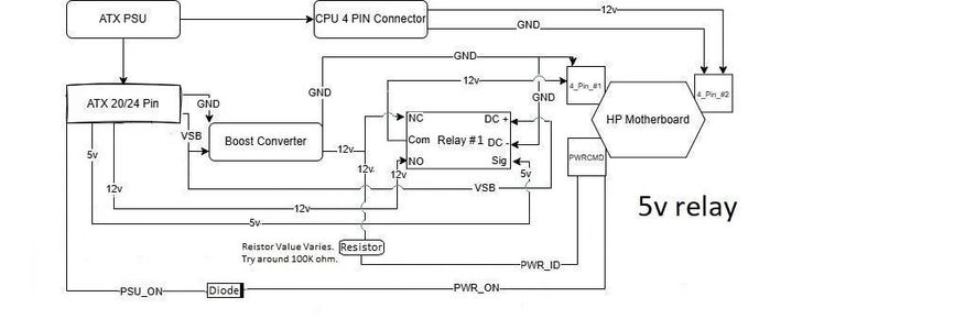

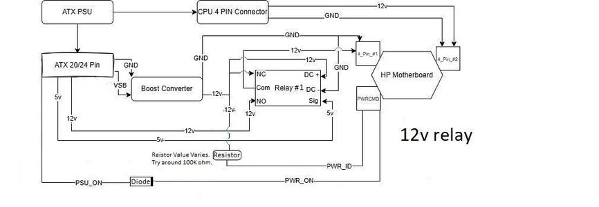

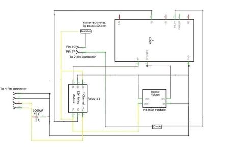

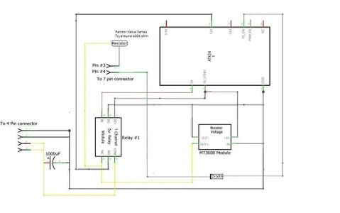

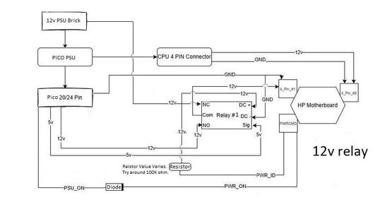

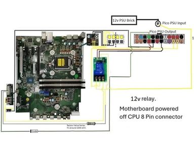

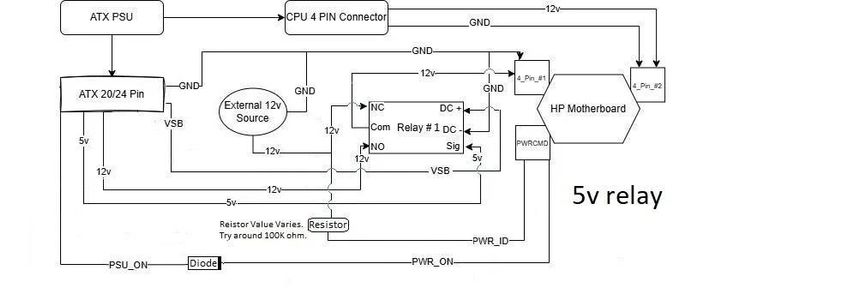

How this project works:

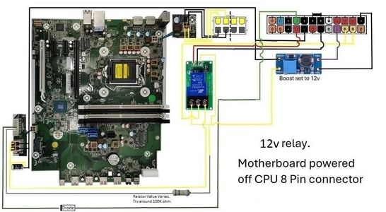

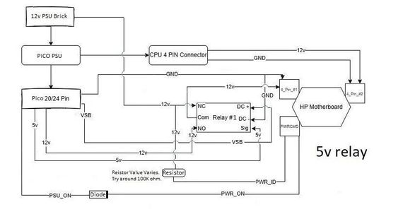

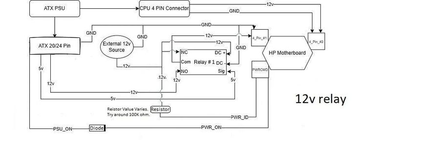

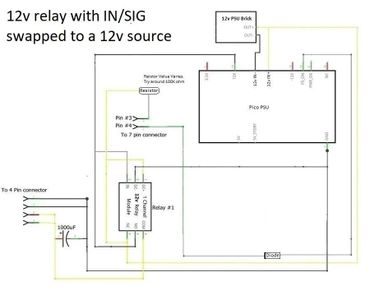

The relay is powered off the ATX 5v_VSB line. Directly for a 5v relay & via the boost converter for a 12v relay.
The ATX PSU PS_ON wire is connected to the HP PWR_ON wire via a diode. Diode cathode is facing motherboard PWR_ON pin.
The HP PWR_ID is connected to the boost convertor 12v output via a resistor.
Relay #1 has the COM terminal connected to the 12v pins of the 4_Pin_#1 connector on the motherboard. The NC relay terminal is connected to the boost converter 12v output. The boost converter input is connected to the ATX 5v_VSB. The NO relay terminal is connected to the 12v line of the ATX PSU. The capacitor is connected in parallel with the NO terminal. The relay triggers on a signal from any 5v line on the ATX PSU(Not the standby).
The boost convert supplies constant 12v to the 4_Pin_#1 connector. When the power button is pressed PWR_ON is drawn LOW, which brings PS_ON LOW, which switches on the ATX PSU. Once the PSU is on it triggers relay #1 which connects the ATX PSU's 12v lines to the motherboard, cutting off the boost converter. A small interrupt of power occurs which is minimized by the capacitor.

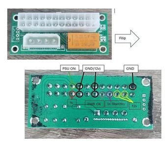

Step 3: Soldering to ATX Plug
To use a dual power supply adapter for the female ATX plug solder it like the above image.
You could also use an ATX extension cable or a Complete ATX Breakout Board. Those will not require any soldering. Just splice or use the screw terminals.

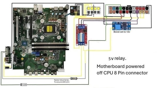

Step 4: Wire It Up/Lets Make It
Wiring is simple. Follow the above images for guidance.
Diagrams are all the same concept. They are just tweaked for both 5v & 12v relays.
I made many revisions to my adapter. Some images may contain slight inconsistencies due to improvements. Please notify me of any errors.
Step 5: Hooking It Up
1. Make sure PSU is unplugged from AC Mains.
2. Plug the 4 pin or half the 8 pin(4+4) CPU connector into the 4_Pin_#2 connector.
3. Plug the 4 pin connector from the adapter board into the 4_Pin_#1 connector.
4. Connect the ATX PS_ON pin to the PWR_ON pin on the PWRCMD connector via a diode.
5. Connect PWR_ID on the PWRCMD connector to the boost converter 12v output via a resistor.
5b. Connect FAN_tach pin on the PWRCMD connector to the corresponding fan pin(if needed).
6. Connect the 24 pin ATX connector of the ATX PSU to the adapter board.
7. Attach any 6/8 pin connectors to GPU & any Sata/Molex connectors to HDD/SSD's.
8. Plug the PSU into AC Mains
9. Press the motherboard power button
The PC should power up! Success!!? If not see Step #7 Debugging.

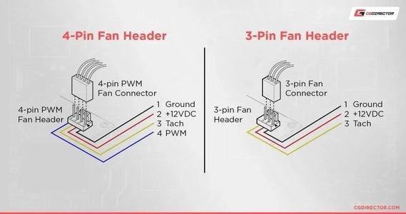

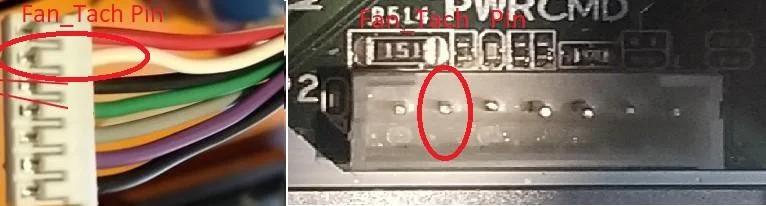

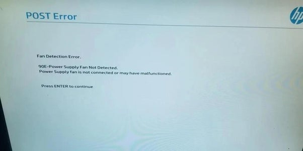

Step 6: Fan Error
On some HP PSU's the fan is used as a system fan. Without this fan connected the PC will throw error 90E.The PC will still boot but the error is annoying.
An easy way to tell if you need this fan modification is to see if there is a wire in position #6 (Fan_Tach) on the PWRCMD connector. If so this modification is needed. The example Elitedesk 800 G3 requires this fan mod.
The PSU fan communicates with the motherboard via Pin #6 (Fan_Tach) on the PWRCMD connector. This pin is looking for a fan Tach signal. There are a few options:
  1. Run a jumper wire from a different fan in the PC's Tach pin to the Fan_Tach pin. Any fan even the CPU will work.
  1. Rig up a fan. Tie into the ATX PSU 12v & Ground to power the fan. Connect the fan's Tach pin to the Fan_Tach pin on the PWRCMD connector. Note: Fan will always run full speed.
  1. Add a fan controller. Connect one of the controllers Tach pins to the PWRCMD Fan_Tach pin
  1. Add a Tach controlled fan to the ATX PSU. Remove the original fan from the ATX PSU & swap in a 3 or 4 pin fan. Run a wire outside for the Tach connection & connect to the PWRCMD Fan_Tach pin.
Both 3 & 4 pin fans will work. On a 4 pin fan the PWM pin will remain unused.

  4. Try a larger value capacitor.
  5. Try no capacitor.

  3. If using a 12v relay the SIG pin may need to be swapped to a 12v source rather than a 5v. (See last image)

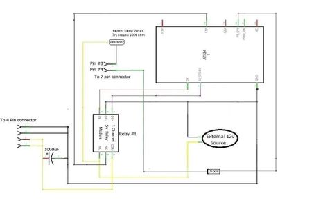

  1. Issue with the 12v boost converter current. Try the following:
  1. Unplug the ATX PSU from mains
  2. Disconnect the 12v output of the Boost Converter from the rest of the circuit
  3. Plug ATX PSU into mains
  4. Connect the 12v output of the boost converter to the rest of the circuit.
If it boots, you will need an alternative way to supply the 12v standby.

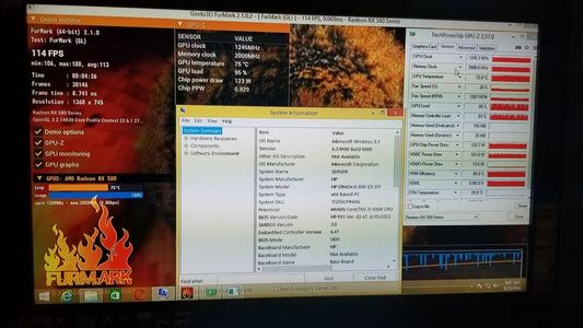

Everything worked until I added a GPU:
  1. Try disconnecting the capacitor
  2. Try a larger value capacitor.
  3. Try a powered ATX riser. (Uses Sata, Molex, or 6 Pin). Some motherboards may limit PCIE slot wattage.
If it boots with the riser installed congrats. Unfortunately the PCIE slot wattage can not be changed. Your stuck with a riser.

Step 9: Debugging 5v VSB Power Rail
Most issues I find result from low current on the boost converter 12v standby. This is due to a low 5v_VSB rail current. Here is a way to eliminate that as a potential issue:
You will need:
  1. Adapter board (from this tutorial)
  2. 12v power supply. 2+ amps. Make sure is a regulated 12v. The OEM HP PSU will work.
  1. Unplug the ATX PSU from the mains power.
  2. Disconnect the boost converter from the circuit.
  3. Connect the Ground of the 12v power supply to the ground of your adapter.
  4. Connect the 12v positive of the 12v power supply to where the output of the boost converter was connected.
  5. Plug in the ATX PSU & the 12v Power supply.
  6. Press the power button on the motherboard
You are essentially replacing the boost converter with a separate 12v source.
If it boots it means the issue is related to the 5V_VSB & boost converter. if not, continue through the debugging.
If using the OEM HP PSU, the yellow wires are 12v, the black Ground.
To boot the HP Motherboard from an ATX PSU without the adapter board:
  1. Plug in the 4 pin (or 8(4+4)) CPU connector to 4_Pin_#2 .
  2. Connect 12v & GND lines from the ATX PSU to the 4_Pin_#1 connector
  3. Connect the ATX PS_ON & GND with a jumper.
  4. ATX PSU will always be on. Needs to be unplugged to power off. HP motherboard should work as intended.
Step 10: What Resistor for PWR_ID?
Thank you to user Kapuninja for your submission on using a resistor for the PWR_ID pin. This is the best way as it is how the OEM supplies work.
Below are some power supplies & their corresponding resistor values.
HP PSU Model: OEM Resistor Code:OEM Resistor Value:Adapter Tested With:
D16-180P2A 57D 383K ohm 380K ohm
D19-180P1A 86D 786k ohm 750K ohm
HP Z2 G4 PC was tested & confirmed working with a 100K ohm resistor. PSU model is unknown.
If you are still unsure, a 100K ohm resistor is a good place to start.
Your resistor may vary depending on PSU. If so, please comment so I can add it to the list
If you can not get it working, I had luck connecting the ATX PWR_OK to the HP PWR_ID pins. These are different voltages, so be careful.

Pico PSU:
A PicoPSU can be used. Make the adapter according to this guide except instead of a boost converter; connect the 12v input from the PicoPSU to where the boost converter output would go. Great for a PSU replacement without modifying the case.
