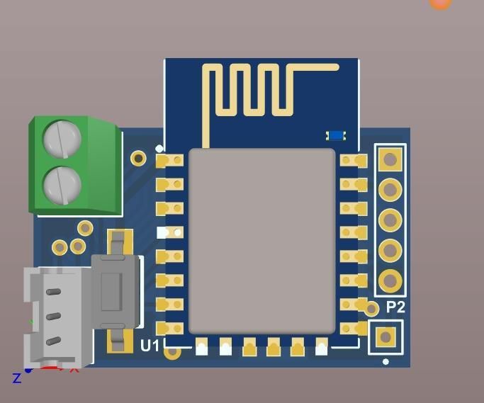

Introduction: Easy Update ESP8266/ESP32 Via Internet (OTA Server for ESP8266)
When you build a device based on any MCU, you will face a lot of bugs after installing the device in the area. By the way, changing firmware is not always easy, sometimes device is installed in of reach place and you should update the firmware remotely.
The problem gets more serious when you made and installed multiple devices and it may be impossible to upgrade new firmware for all devices.
OTA upgrade makes it possible to upgrade the firmware of a lot of devices simultaneously.

Now, I want to write a simple program for ESP8266 using the Arduino framework, It's a LED blinker, I will compile this project with two different blink speeds and then change the firmware via the internet.
The source code should be something like this:
#include "Arduino.h"#include "ESP8266httpUpdate.h"String version = "1.0.0.0";void doUpdate();void setup(){  // put your setup code here, to run once:  Serial.begin(115200);  WiFi.begin("SohaDevice", "DamkpKCk");  while (WiFi.status() != WL_CONNECTED)  {    Serial.println(".");    delay(150);  }  Serial.print("Wifi IP:");  Serial.println(WiFi.localIP());  // Setup LED GPIO  pinMode(2,OUTPUT);}int updateCheckTimer = 0;void loop(){  // Lets blink  digitalWrite(2, 1);  delay(100);  digitalWrite(2, 0);  delay(100);  updateCheckTimer++;  if(updateCheckTimer > 30)  {    updateCheckTimer = 0;    doUpdate();  }}void doUpdate(){  String url = "http://otadrive.com/DeviceApi/GetEsp8266Update?k=9a03f4fb-98c5-4963-9d39-cc9181f65edd";  url += "&s=" + String(CHIPID);  url += "&v=" + version;  t_httpUpdate_return ret = ESPhttpUpdate.update(url, version);  switch (ret)  {  case HTTP_UPDATE_FAILED:    Serial.println("Update faild!");    break;  case HTTP_UPDATE_NO_UPDATES:    Serial.println("No new update available");    break;  // We can't see this, because of reset chip after update OK  case HTTP_UPDATE_OK:    Serial.println("Update OK");    break;  default:    break;  }}
All you need to know is in doUpdate() function. There is a URL to the otadrive.com server with lets you upgrade and manage devices.
