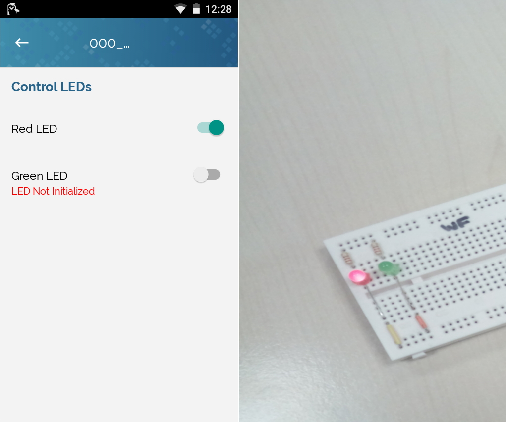

Step 11: EXPANDING THE PROJECT
There are lots of things we could add at this point such as:
- Create a GPIO Mode to switch on/off GPIO pins and switch on/off LEDs.
