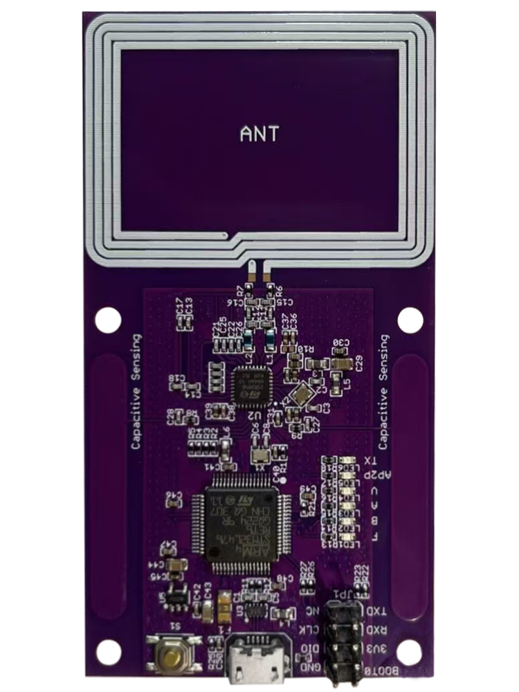

√ Connect the NFC Reader 3911 to your PC via Micro USB

Step 2: Press the NFC Reader 3911 S1 button once to reset the device, The 6 LEDs are fully lit to indicate that the reset is successful.
Step 3: Click Reader -> Disconnect -> Connect, When ST25R3911B-DISCO CONNECTED is displayed, it means that the NFC reader 3911 is connected to the PC successfully.
Step 4: Open the serial port utility tool and press the NB DISCO 95 S1 button once to reset the device. Then hold the NFC reader 3911 close to the ST25DV module of the NB DISCO 95 and click Scan Once.
When connected to ST25PC-NFC PC software, use the NFC reader 3911 to approach the ST25DV module of the NB DISCO 95. The serial port will print Enter FTMManagement, and when it is removed, it will print Exit FTMManagement.

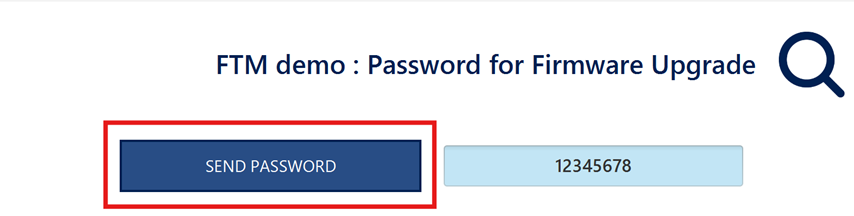

Step 4: Upgrade the Firmware of the NB DISCO 95 Board
Use the NFC reader 3911 to approach the ST25DV module of the NB DISCO 95.
Click on the Firmware Upgrade option and select a firmware Application_NFC_OTA.bin.
The update is successful when an update applied log appears on the serial port.
