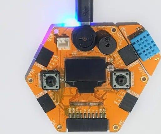

This tutorial will teach you to use the Push Buttons on your Magicbit using Magicblocks. We are using magicbit as the development board in this project which is based on ESP32. Therefore any ESP32 development board can be used in this project.

Magicbit: Magicbit is an integrated development platform based on ESP32 for learning, prototyping, coding, electronics, robotics, IoT and solution designing.

3. Choose 'PB Right(34)' or 'PB Left(35)' from the PIN drop-down menu.(Connects with the Right or Left Push Button on your Magicbit)

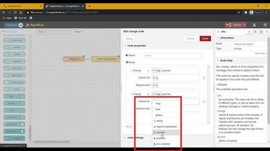

Step 3: Setup the Change Block
(This Node is used to change the 1 & 0 signal input from the Digital In node to any text you want)
1. Drag & Drop the Change Block from the function nodes section on the left of the screen to the flow.
2. Add new rule from the '+' Button to use 2 rules.
3. Change the function of both of the rules from Set to Change from the drop-down menu.
4. Next change the 'Search for' function from String(text) to Number in both of the rules. And make sure the 'Replace with' function is set to String(text).
5. Set up the rules.
- The First Rule to search for '1' in signal input and replace it with our text (e.g. 'Right Button Released' or 'Right OFF')
- The Second Rule to search for '0' in signal input and replace it with our text (e.g. 'Right Button Pressed' or 'Right ON')
the text 'Right' or 'Left' depends on the Push Button which is linked to the Digital In Node in the above step.
