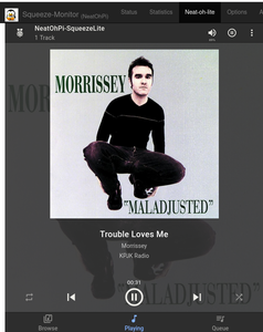

Introduction: Use RPI Monitor to Control Your Squeezelite Players Using Friends
Control your squeezelite players using a web interface that serves as an integration point - and at the same time, monitor each Pi's diagnostics using RPI Monitor.
Long ago, when Squeeze Players were sold by Logitech, they were highly regarded as quality audio devices. The code has been opened up and is being supported and developed by a highly skilled set of developers and hobbyists. Logitech Media Server (the back end) can run on most operating systems including windows, linux etc. It has the advantages of being tested and seasoned, durable and very stable. What were once called Slim devices are now called Squeezelite players and Squeezelite is maintained by the same set of developers, designed to provide a front end for the end user. There are many features we wont get into, and many extensions and addons you can customize to suit your personal preference. With many players in force (think whole home audio), a need for an integration point becomes a necessity.
Enter RPI Monitor. While not designed for audio enthusiats or purposes, it acts as a monitoring device for your raspberry pi, and provides a simple web interface. There are 2 notable features of RPI Monitor that I have exploited for the purpose of this instructable: The ability customize addons as menu items, and the ability to use the "Friends" feature to toggle to other Squeezelite players. Like squeezelite, RPI Monitor is open source and is available on github, or even better: it can be installed along with Squeezelite on Dietpi Operating System with one click. We'll see how easy this can be.

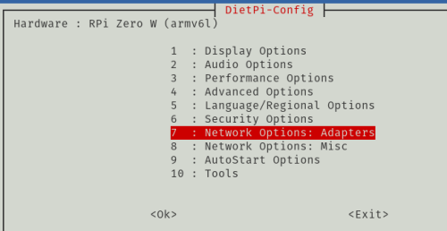

If we ssh to our player, or even if we connect the pi to a keyboard and monitor temporarily, we still need to configure a few things. On the command line, type :
sudo dietpi-config
First, let's setup our wifi by choosing #7 Network Options Adapters, and setup our wifi.
Secondly, let's regionalize our pi by choosing #5: Language/Regional options and establishing our Local language preference, timezone, Wifi country and keyboard layout.
Next, if not already done so, option #6 will allow us to change our password (a good idea) and our host name. The hostname will only change the pi on the network, we will have to repeat this step for squeezelite later on inside the squeezelite configuration. More on that later.
Almost forgot: Option #8 - Network Options - Misc. - "Wait for Network on Boot" should be toggled ON.

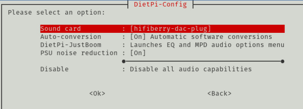

Finally, let's configure our audio options by choosing option #2 Audio Options. Let's turn ON the auto conversion and PSU noise reduction (who wants noise?) and select our sound card from the drop down choice. There is a good chance we may be prompted here to install Alsa Utilities, and if given a prompt, choose "Yes".
After making our configuration changes we can exit the Dietpi-Configuration Menu.
If prompted to reboot, please do so before returning to the command line....

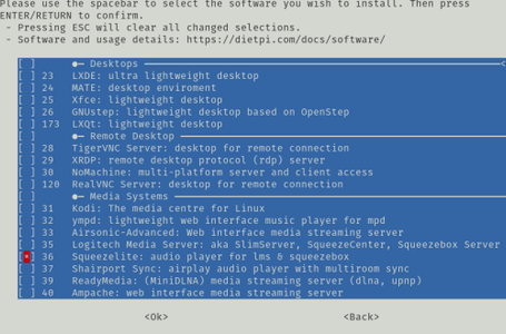

Step 3: Install Required Software
... to immediately enter the Dietpi Software menu:
sudo dietpi-software
We will want to Browse Software.

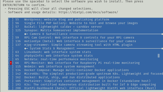

This step will take a good bit of time so for the sake of simplicity I recommend only installing 2: Squeezelite and RPI Monitor. If we were not prompted to install Alsa Utilities in the previous step, we would want to also select Alsa Utilities.
After putting a * (spacebar) in each option as pictured above, click Done, and then Install from the next menu. The software may take a few minutes to install, but on the bright side, both RPI Monitor and Squeezelite will setup automatically to run at boot.
Grab a cup of coffee, it will let us know when the software has finished installing.

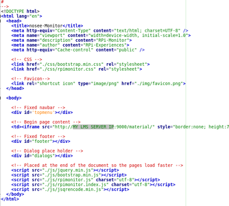

Step 6: Copy Squeezelite Html, Css and Js Files
Save the text file below as /usr/share/rpimonitor/web/addons/squeezelite.html - point squeezelite html file to our LMS Server IP address as in the pic above: (use the real ip address and port 9000 of your LMS server instead of the placeholder)
<!DOCTYPE html>
<html lang="en">
  <head>
    <title>nosee-Monitor</title>
    <meta http-equiv="Content-Type" content="text/html; charset=UTF-8" />
    <meta name="viewport" content="width=device-width, initial-scale=1.0">
    <meta name="description" content="RPi-Monitor">
    <meta name="author" content="RPi-Experiences">
    <meta http-equiv="Cache-control" content="public" />
    <!-- CSS -->
    <link href="./css/bootstrap.min.css" rel="stylesheet">
    <link href="./css/rpimonitor.css" rel="stylesheet">
    <!-- Favicon-->
    <link rel="shortcut icon" type="image/png" href="./img/favicon.png">
  </head>
  <body>
    <!-- Fixed navbar -->
    <div id='topmenu'></div>
    <!-- Begin page content -->
    <td><iframe src="http://MY_LMS_SERVER_IP:9000/material/" style="border:none; height:750px; width:625px;" title="squeezebox"></iframe></td>
    <!-- Fixed footer -->
    <div id="footer"></div>
    <!-- Dialog place holder -->
    <div id="dialogs"></div>
    <!-- Placed at the end of the document so the pages load faster -->
    <script src="./js/jquery.min.js"></script>
    <script src="./js/bootstrap.min.js"></script>
    <script src="./js/rpimonitor.js" charset="utf-8"></script>
    <script src="./js/rpimonitor.index.js" charset="utf-8"></script>
    <script src="./js/jsqrencode.min.js"></script>
  </body>
</html>
Also in the /usr/share/rpimonitor/web/addons/squeezelite directory, Save the two below files without the .txt extension. Instead use the .js and .css extension. Thank you very little Instructables Engineers for making the most important step so unnecessarily difficult.

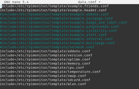

Step 7: Configure RPI Monitor Data.conf
If we installed RPI Monitor from the Dietpi repository (and we did), our data.conf file is almost ready to go out of the box. Really the only thing we need to consider is what Monitor chicklets suit our liking, and which ones we can do without. Personally, I don't need the network, so I comment that line out using the # preface, and uncomment (remove the #) the Wlan config options. There is a little "gotcha" here though. You may notice that we have a file named ...example.friends.conf option. If we uncomment that line, In our next step we have to ensure we modify the...example.friends.conf file for consistency. The order in the config file will dictate the order of screen appearance, so adjust the distribution of chicklets accordingly to your preference.
Note: if not using Dietpi (ie Raspbian OS), you can still install from RPI Monitor and Squeezelite from the repositories using sudo apt-get install *, but your data.conf file will be completely different. One is not better than the other, but Dietpi involves more menu options and less command lines. Six of one, 1/4 of 2 dozen for the other.

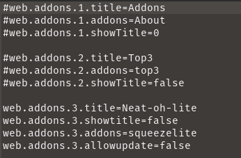

Step 9: Configure Our Addon
Open the addons.conf file by entering in the command line:
sudo nano /etc/rpimonitor/template/addons.conf
If you want to start with just one squeezelite addon, you can use below as an example. But there's no reason more addons can't be added later. Each Addon will need a unique identifier (number) however. I have commented out the About Addon and the Top3 addon in the example below to keep things simple. Any line beginning with # will be ignored, but it's useful to see how to configure addons if needed. The attached text file can be renamed as addons.conf if you want to save it. Note that the addon is still referencing squeezelite, where the directory resides, but it is titled "Neat-oh-lite". This is how it will appear as a menu item on the screen.
#web.addons.1.title=Addons
#web.addons.1.addons=About
#web.addons.1.showTitle=0
#web.addons.2.title=Top3
#web.addons.2.addons=top3
#web.addons.2.showTitle=false
web.addons.3.title=Neat-oh-lite
web.addons.3.showtitle=false
web.addons.3.addons=squeezelite
web.addons.3.allowupdate=false
As you can see, the only Addon that will be read will be my #3 Addon, or the squeezelite addon.
