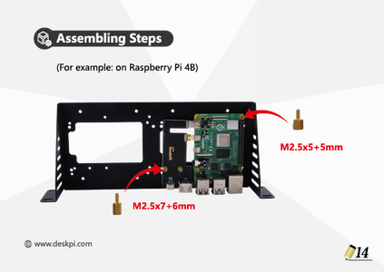

Step 1: Assemble Mini Chassis
It is very esay to assemble it, only one part you need to pay attension. the expansion board need to be insert into Raspberry Pi 4's HDMI ports and USB-C port, please insert it gentelly, and the copper pillar's size you may need to pay attention, it is different on expansion board and Raspberry Pi.

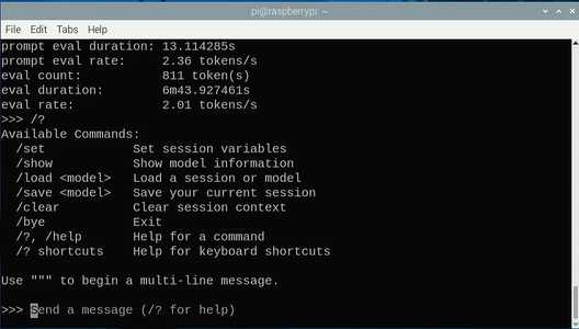

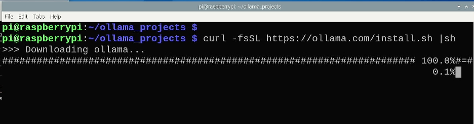

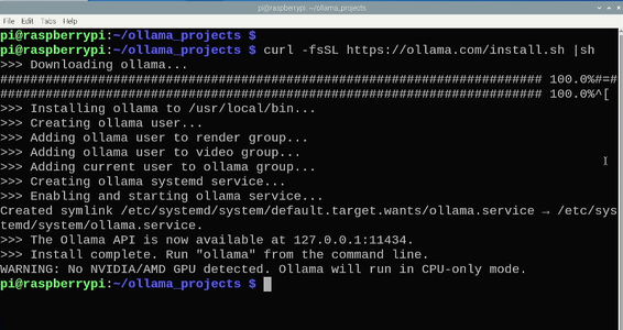

Step 3: Intall Ollama Framework
open a terminal on my Raspberry Pi 5 and typing following command :
curl -fsSL https://ollama.ai/install.sh | sh
ollama run phi3 --verbose

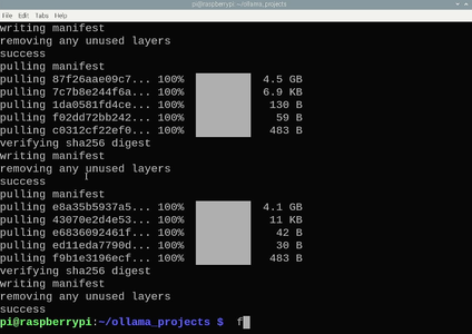

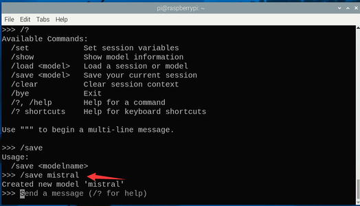

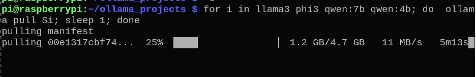

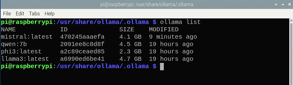

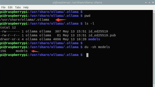

Step 4: Pull Down the Models
if you want , you can pull down the models if you like :
for model in llama3 llama2 phi3 mistral qwen qwen2 qwen:4b qwen:7b
do
ollama pull $model
done
and it may take a while and about 40GB disk space at least.

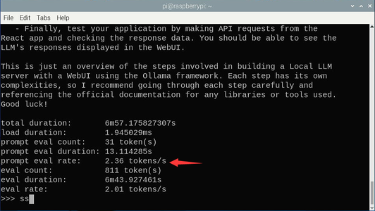

Step 5: Chat With Ollama
just chat with your AI model in the command line and you can install a webUI for your ollama.
