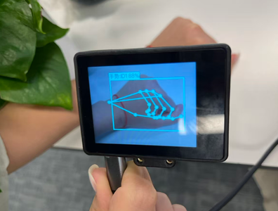

Step 1. Power on HUSKYLENS 2, and select the Hand Recognition function from the main menu. When a hand appears in view, HUSKYLENS 2 automatically detects it — white boxes outline the detected hands, and 21 keypoints on each hand are marked with small white dots.

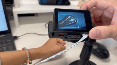

Step 2. Align your hand (e.g., grab or release gesture) with the center cross on the screen and hold the gesture steady. Press and hold the A button to capture more than 10 learning frames, then release it to proceed to the next gesture.For better results, slowly rotate your wrist and slightly adjust the hand angle during the learning process to improve recognition accuracy.
Step 3. Once learned, HUSKYLENS 2 will highlight the recognized gesture with colored boxes, showing the gesture name, ID, and confidence score on the screen.

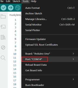

Step 4. Select your board and port
Board:
Navigate to Tools > Board > Arduino AVR Boards and select "Arduino Uno".
Port:
Navigate to Tools > Port and select the correct serial port for your board. Ensure the COM number is accurate.

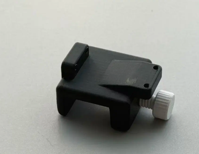

Step 6: Structure Printing
The HuskyLens 2 Universal Mount is a 3D-printed holder designed to securely attach the HuskyLens AI Vision Sensor to a computer screen. It supports structures with a thickness of 5 mm – 24 mm and is compatible with both the HuskyLens 1 and HuskyLens 2, as well as other modules with the same mounting hole spacing.
You can download and print the 3D files here to assemble the complete mount: HuskyLens 2 Universal Mount.zip
