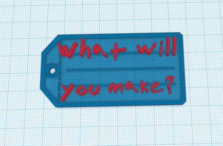

Lots of 3d projects involve putting text on things. You could make key chains, or luggage tags, or personalized containers or a customized candy mold or even a stocking tag...
And in all of those projects, they will have a much more personal feel if you use your own unique and distinctive handwriting.

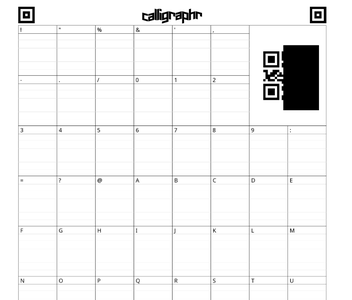

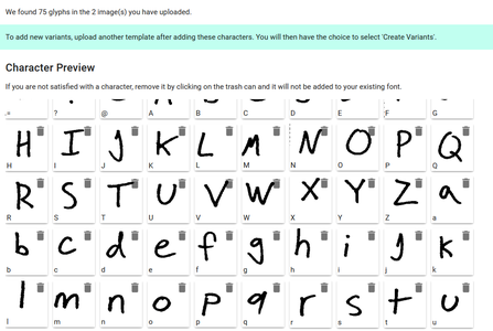

You are going to create a template to print out and fill in. Calligraphr has a limit of 75 characters for the free option, which is enough to get all the upper and lower case letters, numbers, and some punctuation.
By selecting "Minimal English", "Minimal Numbers", and "Minimal Punctuation", you'll get a serviceable set, but you'll be slightly over the allotment.
I un-selected a few punctuation marks by clicking on them to remove.
(I have obscured the QR code in the image so it doesn't get used by mistake.)

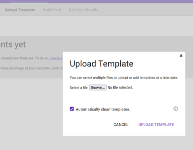

Upload the template- Be sure to click the "clean" option, as that will remove some messy artifacts. If the template does not upload well, you can try unclicking it, but the result have have odd elements built into it.
You can upload both scans or pictures at the same time.

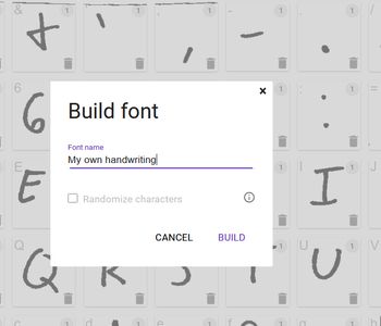

If it looks good, then "build" the font and name it.

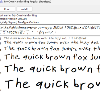

You now have a font made of your handwriting.
You can use this like any other font by installing it on your computer. The mechanics of doing that may be as simple as double clicking and selecting "install".

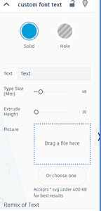

Step 7: Bring Your SVG Font to Tinkercad

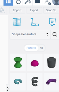

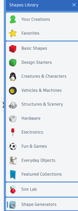

In Tinkercad, find "shape generators" at the bottom of the shapes library menu.

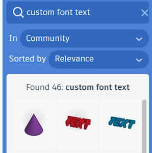

Then search for "custom font text". You may get may results, but only two actually deal with fonts.
Choose the blue text one.

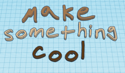

Step 8: Create the Text Object

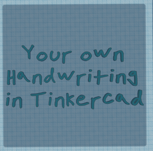

Now you can use your font just like any other Tinkercad Text Object.
