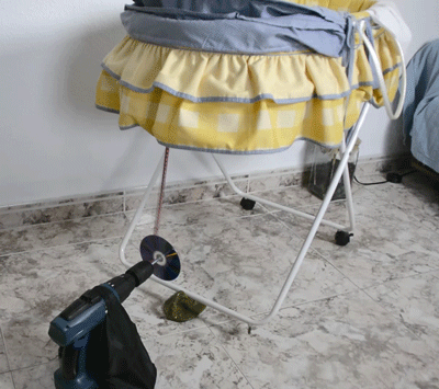

Step 1:
I used Instamorph to make a bouncing base for the crib.
When Instamorph had cooled down, I tried out the base to see how good it bounces.
It did bounce, but not as much as I wanted, so I made a few cuts until I was happy with the result.
Step 2:
I drilled a hole in the CD and glued a screw in the center
Step 3:
I remove the hooks from the bungee cord and used a screw to attach the cord to the CD.
Step 4:
I removed 2 wheels from the crib as they were hitting the floor when the crib was bounced.
I put the base under the frame and tied the bungee cord to the crib.
To make sure the cordless drill does not move, I put some weights on top of it.
After setting the speed, I used a piece of electrical tape to keep the button pushed.
That's it!
