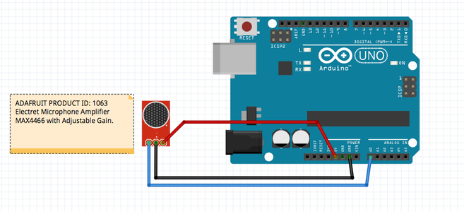

Step 1: Interface the Microphone to the Arduino
Connect the VCC Microphone pin to 3.3V arduino pin and the GND Microphone pin to one arduino GND pins.
For the best performance, use the "quietest" supply available (on an Arduino, this would be the 3.3V supply).
Then connect the OUT Microphone pin the arduino A0 analog input.
The audio waveform will come out of the OUT pin. The output will have a DC bias of VCC/2 so when its perfectly quiet, the voltage will be a steady VCC/2 volts (it is DC coupled).
