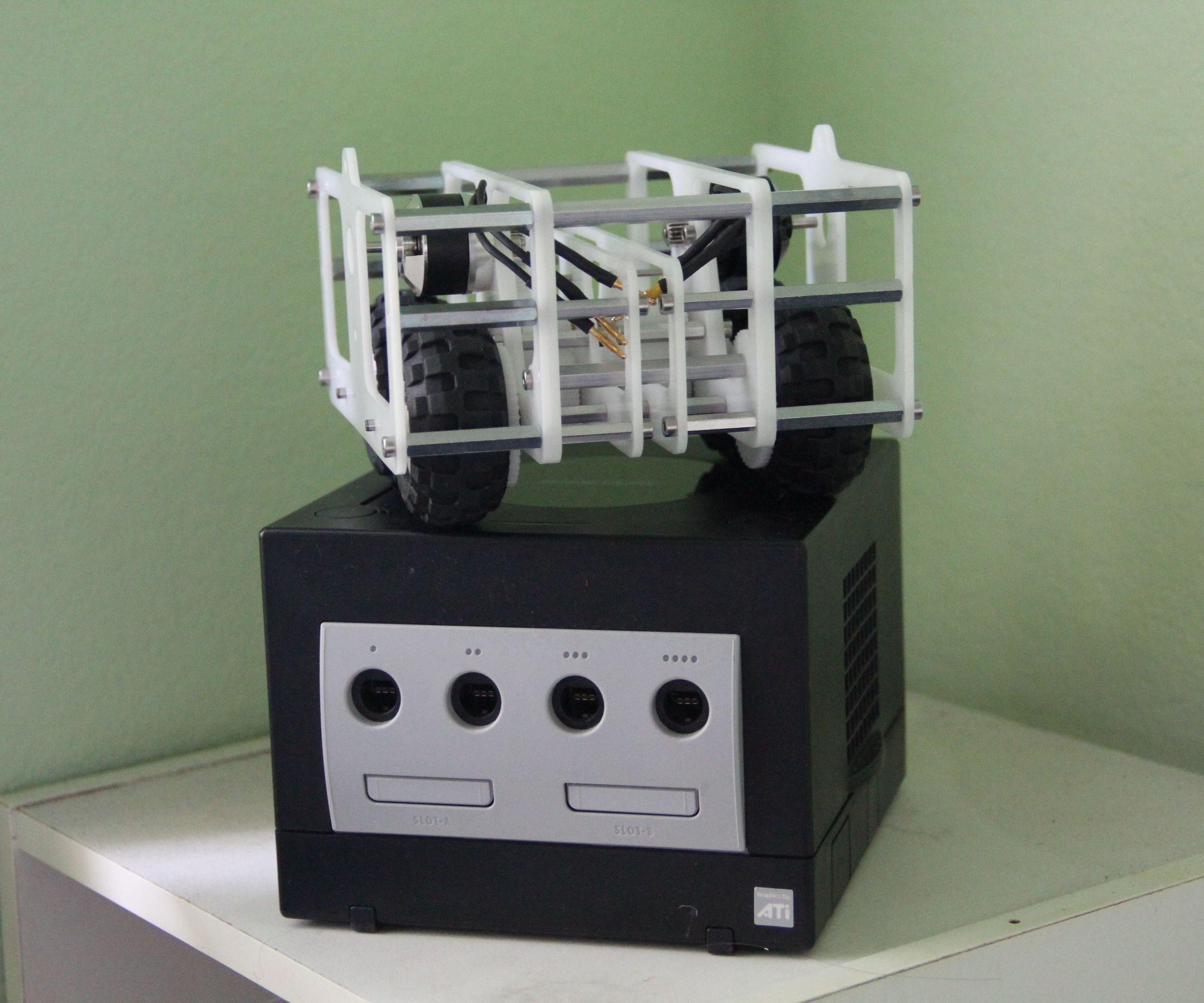

Greetings, everyone, and welcome to my first instructable!
Today we'll be covering a few major bases to get to the final goal: controlling an Arduino-based robot via a PS3 remote! By the end of this instructable, you'll be able to control the speeds of both NXT motors with the two analog sticks of a PS3 controller.
Here's the idea:
A PS3 communicates via bluetooth to the computer sending the value of its analog sticks to the Processing program. Processing then sends this information as a packet of data to the Arduino bot through the Xbee wireless modules. Lastly, the Arduino board "unpacks" this data packet and interprets it as the speed and direction to drive each motor.
Here are the three basic milestones that we'll cover:
-- using Arduino to control NXT Motors
-- interfacing the Programming Language Processing with a PS3 controller
-- Wireless communication between your computer and Arduino via Xbee modules

Step 4: Assemble Your Robot Chassis
So far, so good!
In this case, I decided not to include instructions on how to build my LegoNXT chassis.
All you'll need to do is create a chassis that runs off of two motors. Each motor drives a wheel on that corresponding side (in my case, a tread).
If you're not too LEGO savvy, no sweat! Check out the gracious providers of many instructions at www.nxtprograms.com for a guide to building a simple chassis:
Here's a really simple one to get you started:
http://www.nxtprograms.com/mini_rover/steps.html
Once you've built that chassis, we'll be mounting a few Arduino components to it in the next step.
