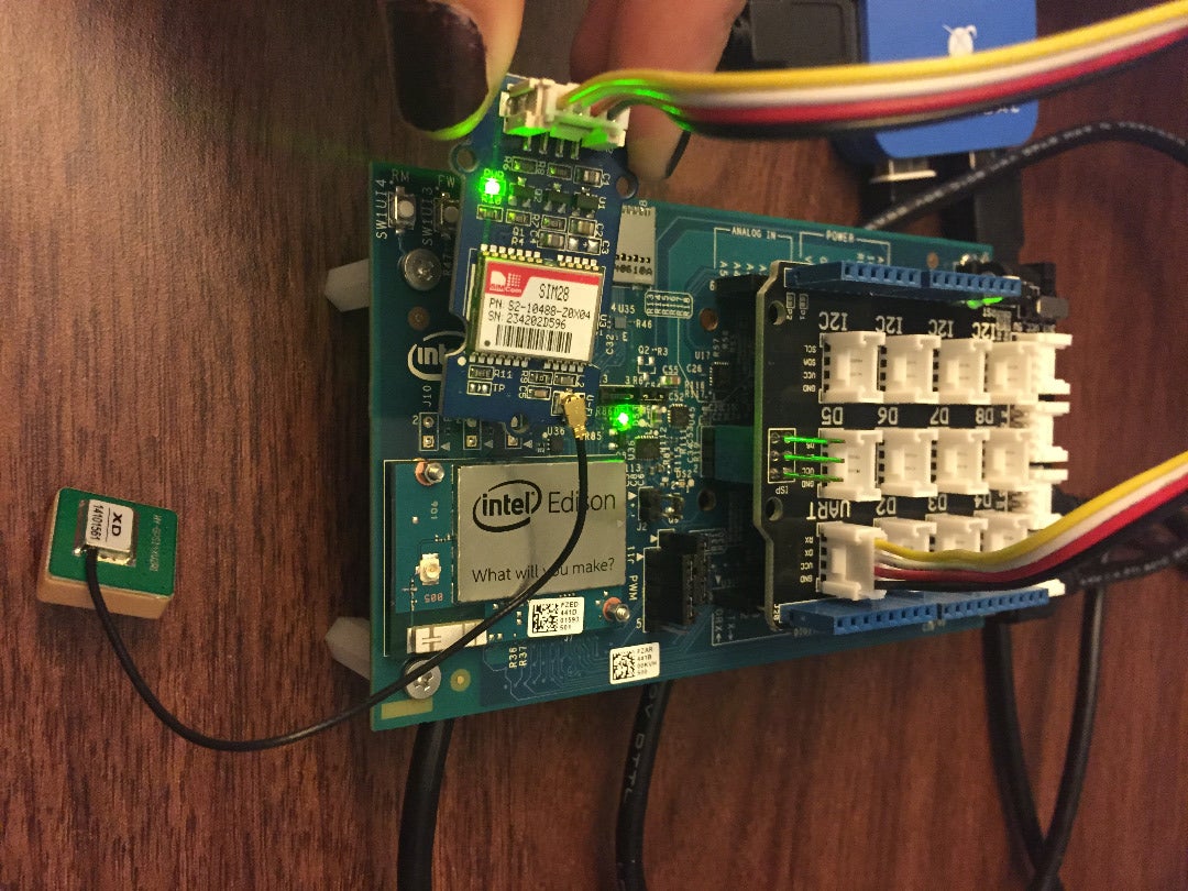

The GPS sensor:
The GPS sensor is linked to the UART input of the Base Shield (included in the Grove Starter Kit Plus). Once connected you should see the green light on the sensor turned on, this indicates its properly connected and receiving power.

Step 8: Seeing the GPS Data in Action
Note that the GPS data is in NMEA format.
Once you have your the sensors connected to the board you are ready to build and deploy the code.
Once you deploy the code you should see the following in your console in Eclipse.
