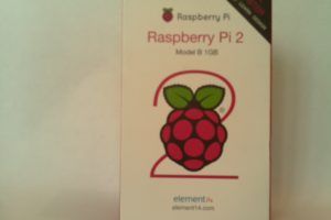

First, we’ll try to get the Raspberry Pi to detect the Raspberry Pi Logo. We’ll use the big Raspberry Pi label on the Raspberry Pi Box. Set the Pi box about 1 ft from the camera. We’ll be propping up the camera with a Raspberry Pi Robot, the GoPiGo. It holds the camera in place with the acrylic body, and we will use it later for some fun projects!
You might want to take a test picture to make sure the label is visible. In the command line, run:
If the picture looks ok, we’ll move along!

We’ll make our JSON credentials available. In the command line, type:
export GOOGLE_APPLICATION_CREDENTIALS=filename.json
And now, in the example directory, run:
python camera-vision-logo.py
You should get “Raspberry Pi” back!
