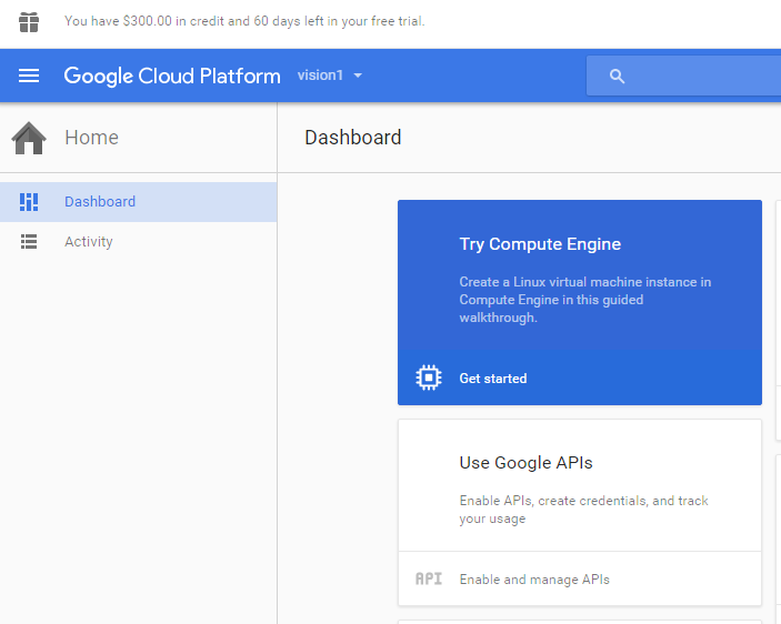

After you’ve created your account, you can set up a project and enable billing. First, click here to go to the Google Cloud Projects Page.
Create a new project.
In our example, we named it “vision1”
You will need to enable billing for your account (you won’t be charged). You can do this by clicking here. Go to the Cloud Platform Console here. Select the project “vision1” and click the hamburger in the upper left hand corner of the page.
Select Billing on the left hand side. From here, you can enable billing on your Google Cloud account. Finally, we’ll enable the API. Click here to enable the API. Select the “vision1” account we created. Click “Continue”. You should get a message that API is enabled.

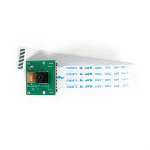

The hardware is pretty simple! We’ll be using a Raspberry Pi Camera with the Raspberry Pi, here are some directions on setting up the camera.
These Raspberry Pi Camera setup directions assume you’re using Raspbian for Robots on your SD Card. You can buy an SD Card with Raspbian for Robots on it, or you can download it for free and install it using our directions here. If you’re not using Raspbian for Robots, you will need to take additional steps to enable and setup your camera; here are some directions on setting up the camera.

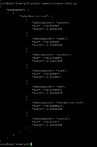

One of the cool things you can do with Google Vision is get the cloud to figure out what’s in the picture you take. Let’s take a picture of a GoPiGo Wheel and see what the cloud thinks it is.
Set up the camera and run the sample program. Again, we’ll be holding the camera in place with the GoPiGo robot kit.
With the camera set up, we’ll take a test picture. Looks like the wheel is in there.
In this sample program we’ll return the entire JSON response. We get a few interesting results from the picture: “yellow” (with an 80% score), “wheel”, “product”, “tire”, “toy” and “automotive tire”.
