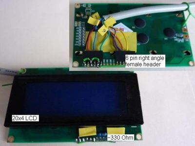

    luisazmouz
    luisazmouz
    11 years ago on Introduction
    This is an awesome project! And I'm working on it, but can you please specify what was soldered to the LCD and what was connected to the ethernet shield and were? If you can that would help me finish mine. Thank You :D
    0
    bogdanzalmoxis
    bogdanzalmoxis
    Reply 11 years ago on Introduction
    The provided sketch (or C program) describes the connections, which must
    be made to realize the whole system:
    // LCD pins 1,3,5,16 to Arduino digital pin GND
    // LCD pin 2 to Arduino digital pin +5V
    // LCD pin 15 via Resitor 330 Ohms to Arduino digital pin +5V
    // LCD pin 14 to Arduino digital pin 2
    // LCD pin 13 to Arduino digital pin 3
    // LCD pin 12 to Arduino digital pin 4
    // LCD pin 11 to Arduino digital pin 5
    // LCD pin 4 to Arduino digital pin 9
    // LCD pin 6 to Arduino digital pin 8
    What is soldered on the back of the LCD is related to the first and third
    lines above.
    The first line, "// LCD pins 1,3,5,16 to Arduino digital pin GND",
    says that pins 1,3,5, and 16 of the LCD are connected to the GND pin
    of the Arduino board. To realize that I soldered short wires on the
    back of the LCD to basically sort-circuit these pins. In this way,
    I only need one wire - I used the black wire - of the
    "9 Conductor 24 AWG" cable to connect to the GND pin of the Arduino
    board. Note that the pins' types, names, or numbers of the Arduino board
    are the same as for the Ethernet shield, which is fixed on top of the
    board. These are clearly marked on the board. Also, the pin numbers
    (from 1 to 16) are also clearly marked on the back of the LCD.
    The third line: "// LCD pin 15 via Resistor 330 Ohms to Arduino digital pin +5V",
    is realized by soldering the resistor on the back of the LCD
    between pins 15 and 2. Then, pin 2 of the LCD is connected through
    one of the wires of the "9 Conductor 24 AWG" cable - I used the
    red wire - to the "digital pin +5V" of the Arduino board (or
    more precisely of the Ethernet shield). This is illustrated by

    Lastly, to realize the connections of the LCD to the board/shield,
    I soldered on the back of the LCD the two "6 Pin Right Angle Female
    Header" as indicated in Figure 2. Eight out of the nine available
    wires of the "9 Conductor 24 AWG" cable are then inserted into these
    headers. The other endings of the same eight wires are inserted into
    corresponding headers of the shield. The correspondence between LCD
    pins and the board/shield pins is described by the sketch lines above.
    I hope this helps to clarify things.
