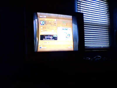

Step 6: Congratulations
Congrats. You are now connected to XBOX Live without having to have bought one of those ridiculously expensive wireless adapters. Have Fun!
