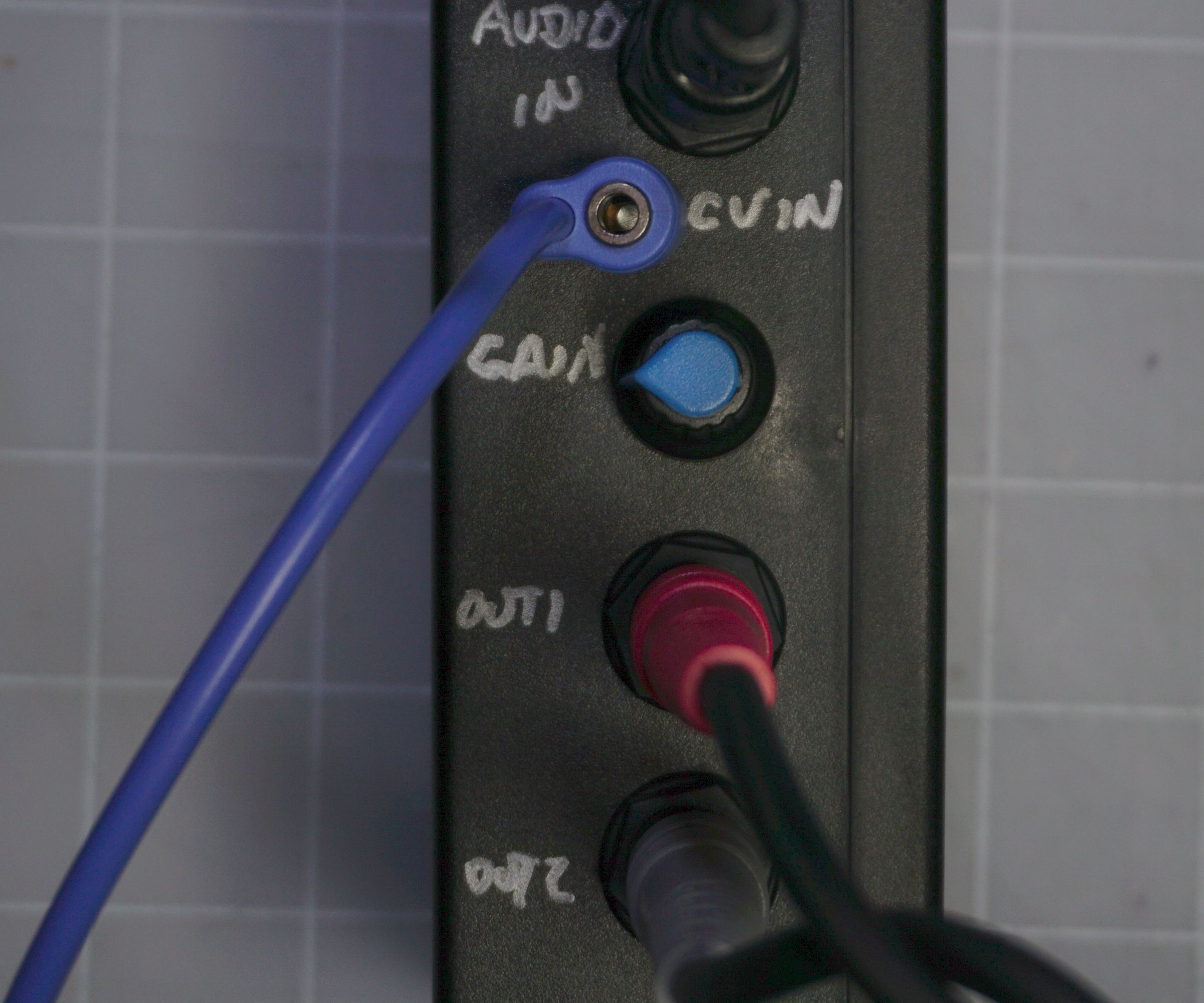

When you're done, you'll have 4 to 8 jack-pairs that look something like the second photo for this step.
Next, remove the mounting hardware from each socket, then one jack-pair at a time, insert the 1/4" side in a larger hole and the 3.5mm side in a smaller hole adjacent to it. Reattach the nuts and any washers to the jacks from the front side of the panel and tighten them (if you've spray painted the front of the panel, do this delicately as it will be really easy to scuff the paint.) It's best to be consistent here, so if the top 1/4" jack goes to the left 3.5mm jack beneath it, then mirror that on the bottom half of the panel.
EDIT: If your sockets have tabs of the right length, you may be able to do away with the wire and soldering ahead of time. See the last photo on this step (added with edit, of the 4 hp 4 route version)-all you have to do is line up the sockets as you mount their hardware in such a way that each jack-pair's tip connectors are touching, then solder them together. In this case you should be able to simply tin the tip of the soldering iron, touch it to each of the tip connector junctions and touch the solder to the tip of the iron until solder flows to join the connectors. Just don't use so much that it touches the metal panel! Continue reading the original text to see why!
The reason that I specified that the metal used for the panel should be conductive and the jacks had to have conductive sleeves as we're using the panel to complete the circuit for each of these jack-pairs. The sleeve connector for Eurorack and PA or effects is ground, so we can simply solder the tips together and let the connection to the panel do the rest of the work. That's why you don't want to get any paint on the back or in the "walls" of the drill-holes:paint is an insulator and can keep the circuit from completing.
As you insert the jack-pairs and tighten the hardware down, make sure that none of the tabs (at least the ones that aren't soldered to each other) are touching. This could short the transition you're trying to make and defeat the purpose of sending your signal through a pedal or effect or out to a PA.
Once all the jack pairs are inserted and tightened, get out the continuity tester again and make sure that a) none of the soldered tabs connect to ground and b)none of the soldered tabs connect to another soldered tab jack pair. (The last picture is how I did that. All the multimeters I've ever had have had an audible continuity detector built in, so I attached a probe clamp to one of the free ground tabs, which is connected to all the other grounds through the panel instead of solder, and probed each tab point with the free end to test the ground.)
Step 4: Mount and Use
If you have a Eurorack then unless this is your first and only module, this part should be familiar. Simply slip the module into the channel formed by two paired rack rails, (if necessary) slide a couple rail nuts behind the mounting holes of the units, and screw the mounting screw through the front of the unit into the nuts or threaded strips.
Using it is just a matter of taking a signal from a point in the modular signal path and patching it into the module at a 3.5mm socket, continuing that path out of the corresponding (jack-paired) 1/4" socket to the destination and if necessary, inverting the process to bring the signal back in to the modular signal path through a separate jack pair.
