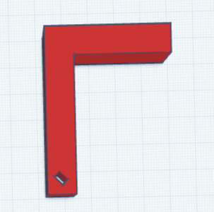

Step 9: Design 3D Printed Arm/ Motor Casing
Next you will design your 3D printed arm to the right dimensions and with the correct sized hole for it to fit onto the motor, now you print your desgin. Then you will design your 3D printed motor mount and print this as well.
