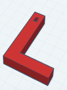

Step 10: 3D Design of Arm
Here I designed my arm on tinker cad that I will use.

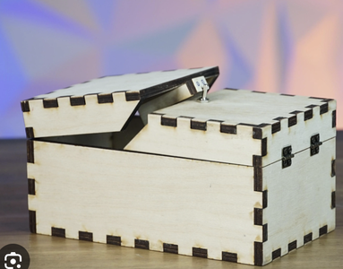

Step 11: Make Box
I forgot to take a photo in class so I uploaded one from google. In this step I sticky-tapped and glued the floor and walls together of the box. I ran out of time to add a roof.
