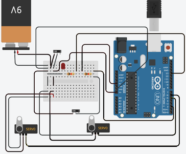

  • Arduino Uno
  • Arduino 'kit' with cables, resistors, boards etc
  • 2x male & female crimp wire plugs
  • 2x MG990s Motor Servos
  • 2x switches
  • 1x P-clip
  • A piece of aluminium (for the main arm) (110mm x 10mm)
  • A piece of foamex (for the lid arm)
  • Blocks of wood for
  • 7.4v rechargeable battery
  • Soldering iron, heatshrink rubber tubes, pliers, drill, screwdriver, screws, patience, whisky

The battery arrives with connectors designed for R/C projects, so we trim away the original plugs and crimp on the cable plugs. Then do the same with two regular jumper wires so that the battery can be easily disconnected from the circuit for safety, charging etc.

After securing the arms in place, it's time to test everything to make sure it works.
I didn't shove everything in as cable management is important, so I left most things hanging out for now. You'll want to check that the main arm doesn't push too far, as it could damage the motor and fittings.
Step 8: Final Fitting
I unscrewed the arms to help organise the cables, after getting very frustrated trying to do it in place. Sometimes you have to think outside the box- literally!
I used tie-wraps to keep similar cables together and I was happy with the result. The on/off switch was held in place with a P-clip. You can put it wherever you like, somewhere hidden is best IMO.
