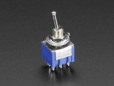

  1. Mini DPDT Toggle Switch
  2. 6A 125VAC
  3. Mini DPDT Toggle Switch Link

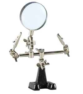

  17. Helping- Hands
  18. Link

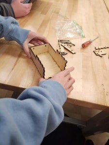

Step 3: Putting Together Box
  1. Assembling the exterior of box
  2. Use wood glue, for a strong grip.
  3. Let dry for at least 20 minutes before moving.
  4. Hold pieces together during the gluing process.
  5. Wipe away with wet paper towels and glue.

  1. Connecting the limit Switch.
  2. On a standard limit switch there are three prongs. If yours doesn't have three prongs make sure that its a NC switch
  3. On your switch we will first solder a connection between the NC prong on a limit switch and then onto any of the empty prongs on the DPDT switch using a wire. Make sure no bridges occur on the DPDT switch.
  4. We will then solder a wire on the ground of the DPDT switch that we will leave unconnected to anything for now until we get the battery in place.
  5. Positive and negative wires.
  6. Once the limit switch is connected to a node, look at the node that is directly adjacent to it that is empty and isn’t connected to the motor.
  7. Now look at the node Diagonally opposite from it.
  8. Both those nodes need to receive a Negative input in order to complete a loop and have the motor spin.
  9. The reason we need the diagonally opposite to both be negative is that when the switch is flipped the common connects to one of the nodes adjacent to it. If we have on one side of the common a negative end and the other side a positive end, the direction that the motor will run will be opposite based on how you flip the switch
  10. To connect these two: how we did it was that we connected a small wire to each prong individually and then connected the ends of those wires with one bigger wire to make one central (negative) wire.
  11. For the last node we connected 1 wire that we will designate positive.
  12. Battery
  13. Before you do and solder you should do testing to see how many batteries you will need to be able to flick the switch and if the polarity is correct.
  14. Depending on how your motor was linked your motor might spin in the opposite direction you need it to. If this happens reverse the polarity on your batteries by connecting the positive end of the battery to the negative set of wires and vice versa. This should resolve the issue
  15. Once you’re done testing and figured out how many batteries you should use we are now going to start soldering the battery holders.
  16. Connect the Positive end of the batter holder to the positive set of wires on the Dpdt and the Limit switch (Unless you had the situation as previous mention in which you would connect the negative end of the battery)
  17. Then connect the negative end of the battery to a negative set of wires. (unless in a previous case where it would now be a positive end to negative set.

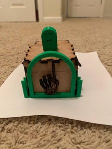

Step 6: Putting the Final- Touches of Box/ 3D Modeling
  1. For 3D modeling we used AutoDesk Inventor and MakerBot.
  2. For the switch, we added a little gravestone with a ghost on it.
  3. With 3D printing we used filament, and had our measurements in millimeters.

  1. Not using the right wood. Make sure that when printing out, USE THE RIGHT WOOD!!! Otherwise, the laser wouldn’t be able to cut through
  2. Connection with the wires to the DPDT switch
  3. Board the limit switch goes on needed adjustments for a larger limit switch
  4. Multiple iterations of the Motor Holder had to be made
  5. The first iteration couldn’t reach the limit switch
  6. The second iteration could reach the limit switch but would sometimes miss it by going under it
  7. The third iteration would fall short of the limit switch because the arm would hit the bottom of the box first (the arm also had to be changed)
  8. The fourth iteration had its axis rotated to solve this problem but was rotated incorrectly
  9. The fifth iteration finally worked as intended
  10. When printing out make sure the bed of the 3D printer is heated. Otherwise, it might be stuck to the board of the 3D printer.
  11. Had an issue with figuring out the correct amount of batteries to be able to successfully push the DPDT to a different state
  12. Also had an issue fitting enough battery boxes
  13. Currently this is only the prototype version of the box. The main issue we have and are currently fixing is replacing the battery once the lid is closed. Basically, once the lid is closed, there’s no way to get the batteries out and no way to repair the circuitry.
