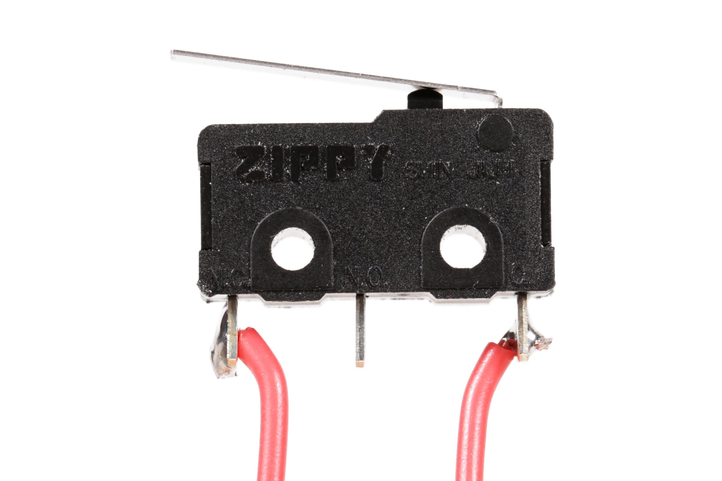

(x1) SPDT lever switch

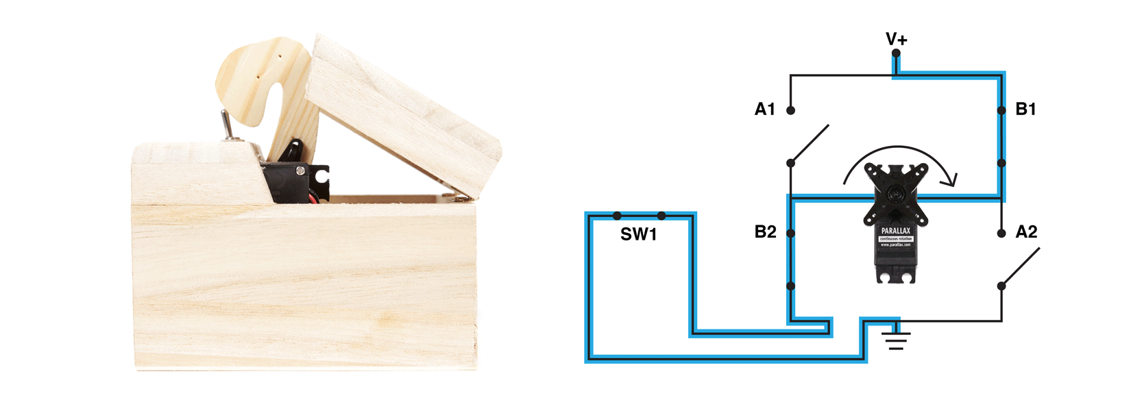

Step 2: How It Works

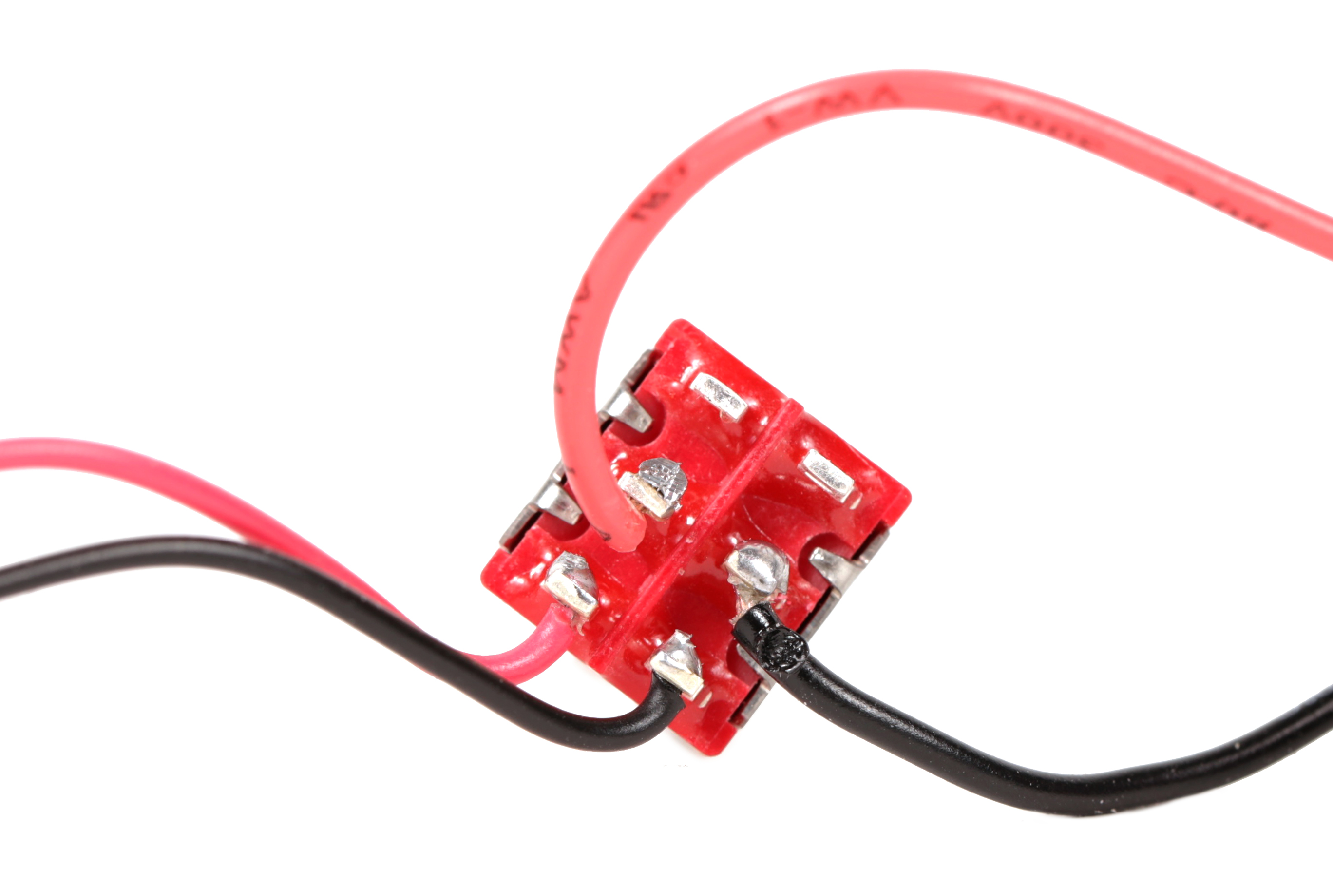

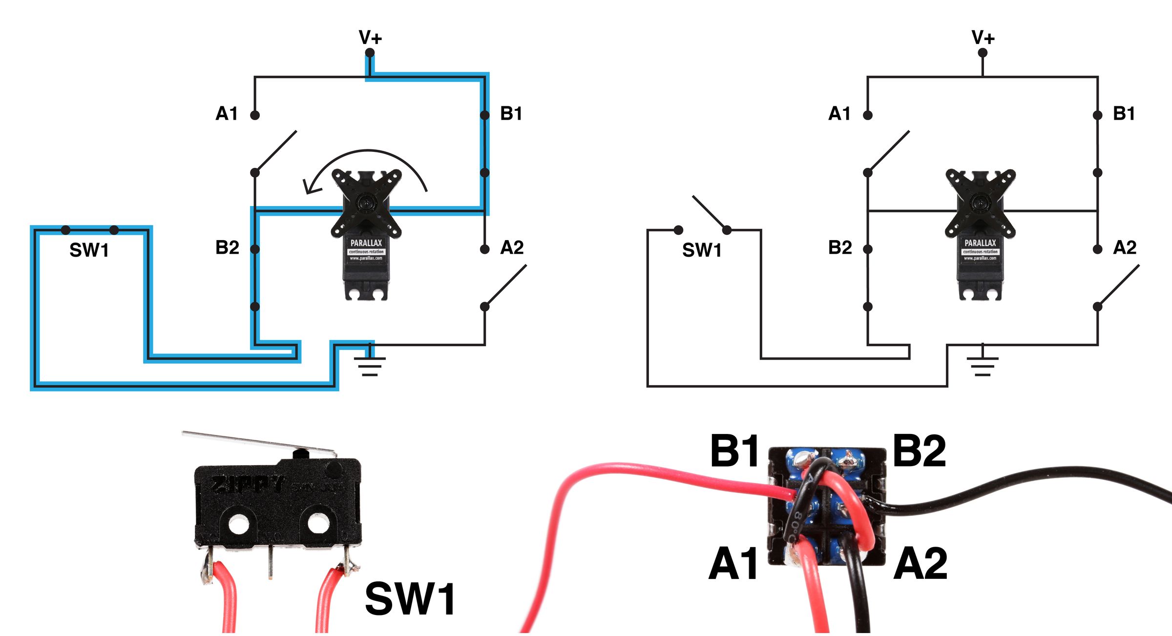

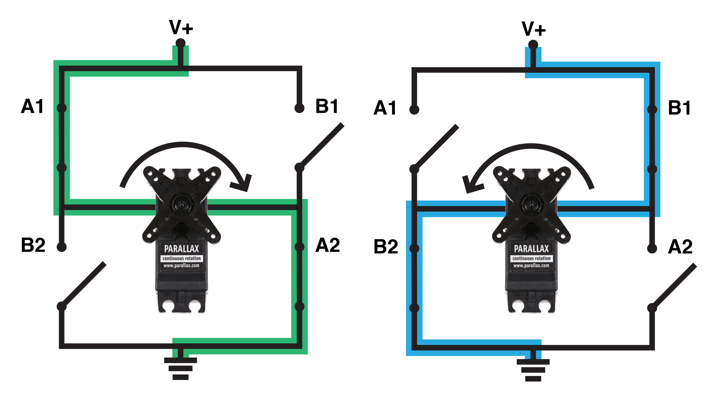

At the heart of the machine there is a DPDT toggle switch wired to reverse polarity to a motor. This means that the direction electricity is flowing through the motor changes when the switch is toggled. This is important because the direction a motor rotates is dependent on which direction electricity flows through it. So, to put it simply, when power and ground get reversed, the direction of the motor changes.
There is also a lever switch inside the case which disconnects power to the motor, but only when it is pressed and the power is reversed.
Thus, when the toggle switch is pressed, the power is no longer reversed and the machine is once again turned on. The arm is then free to rotate up out of the box and hit the switch. This in turn reverses the arm, which rotates back into the box, where it hits the lever switch, and turns itself off once more.

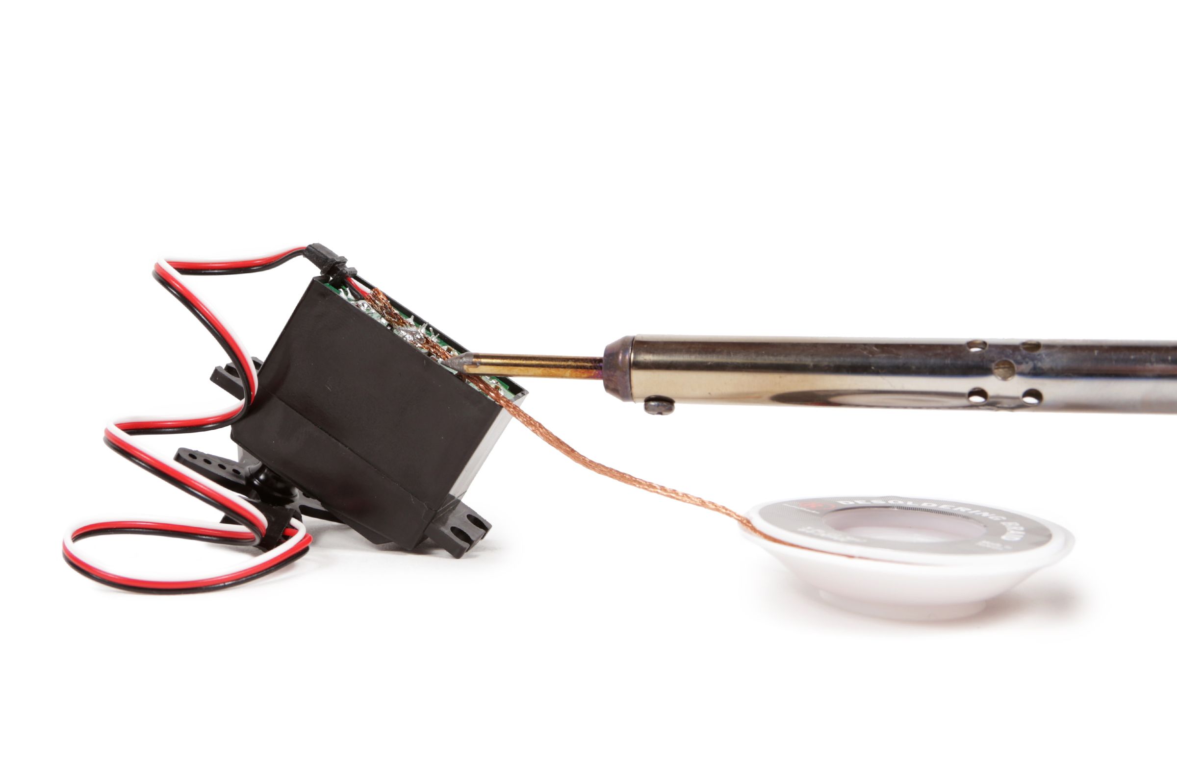

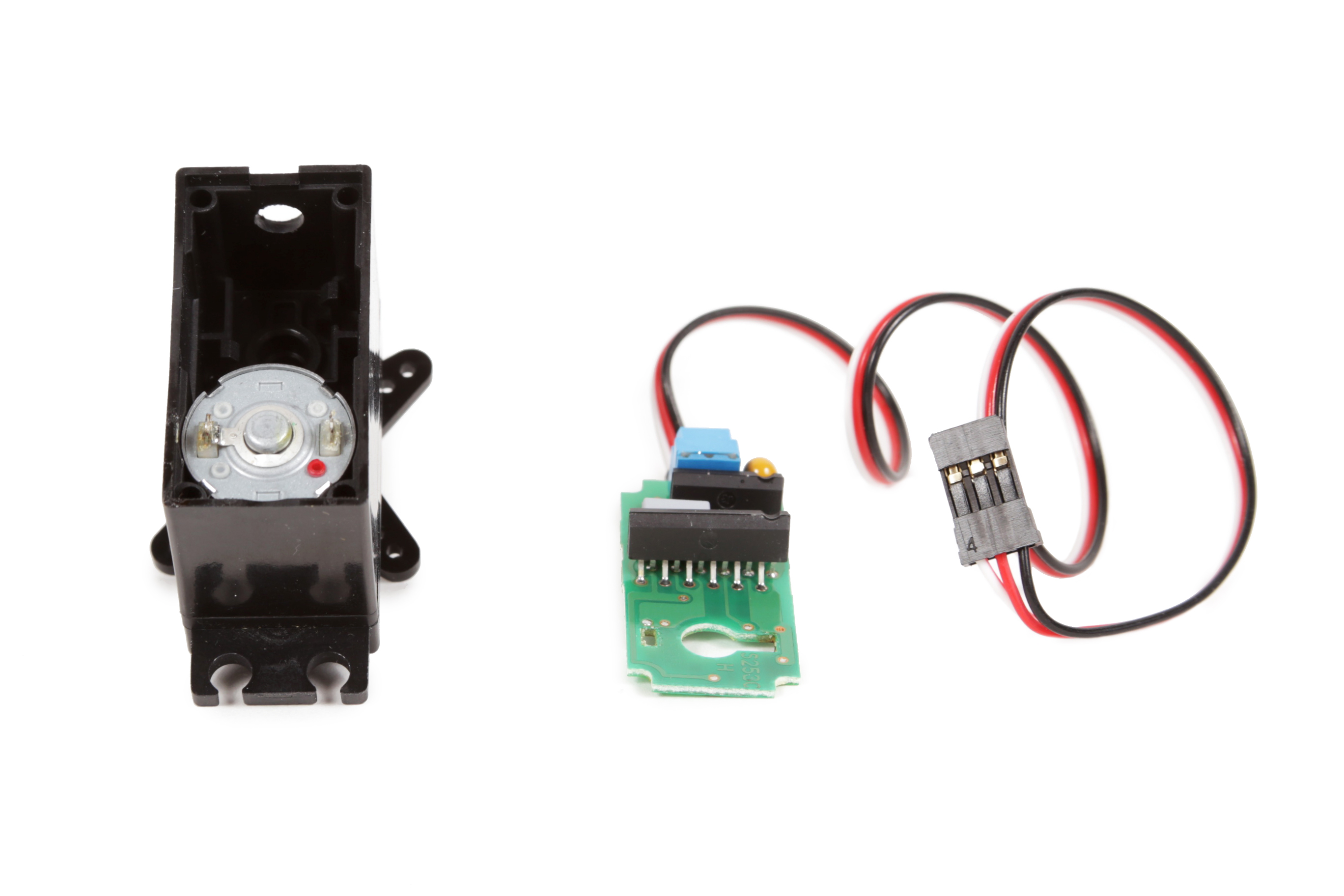

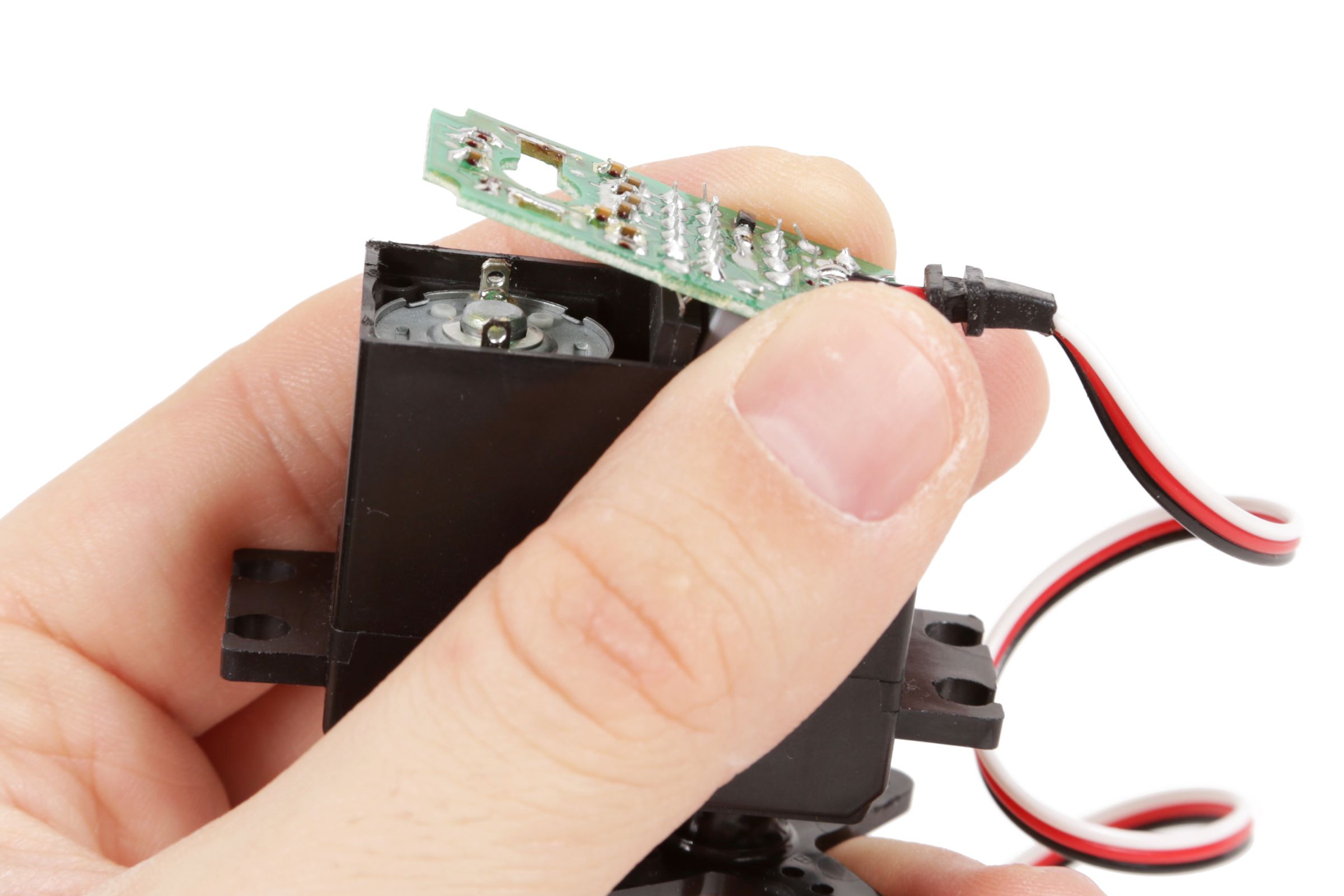

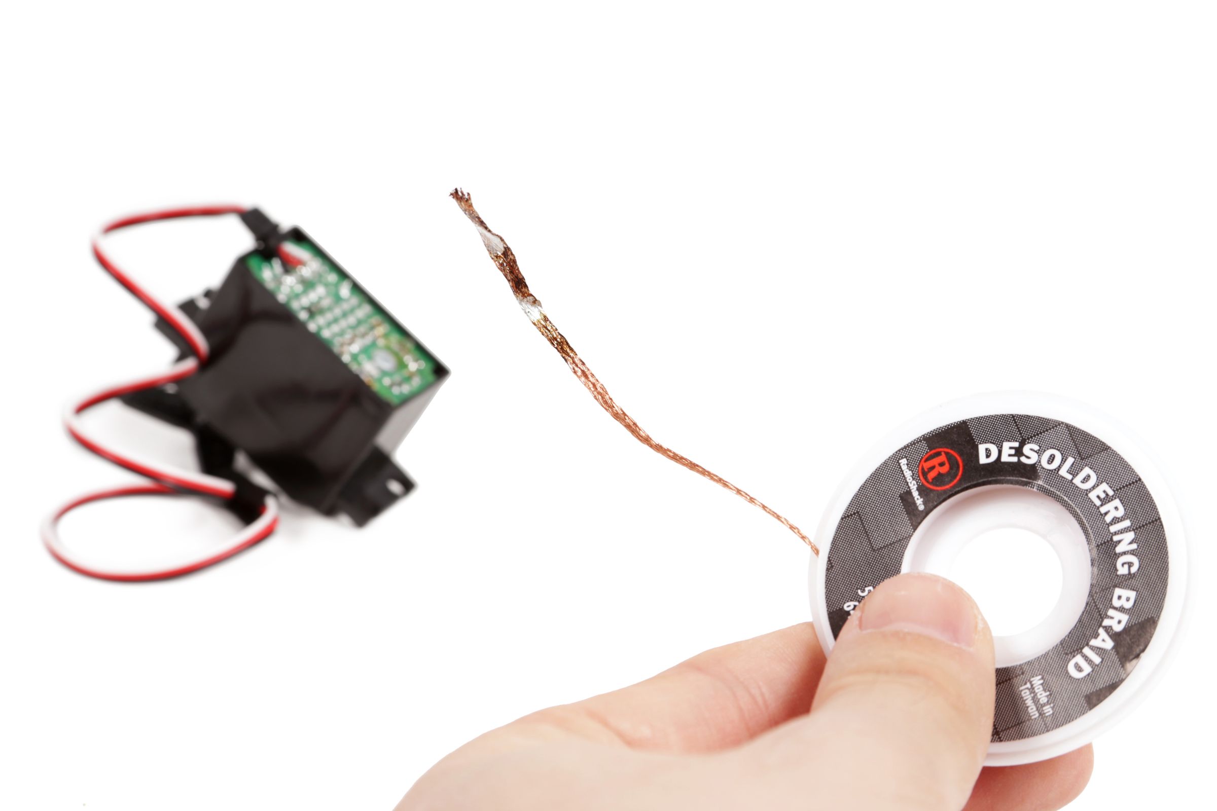

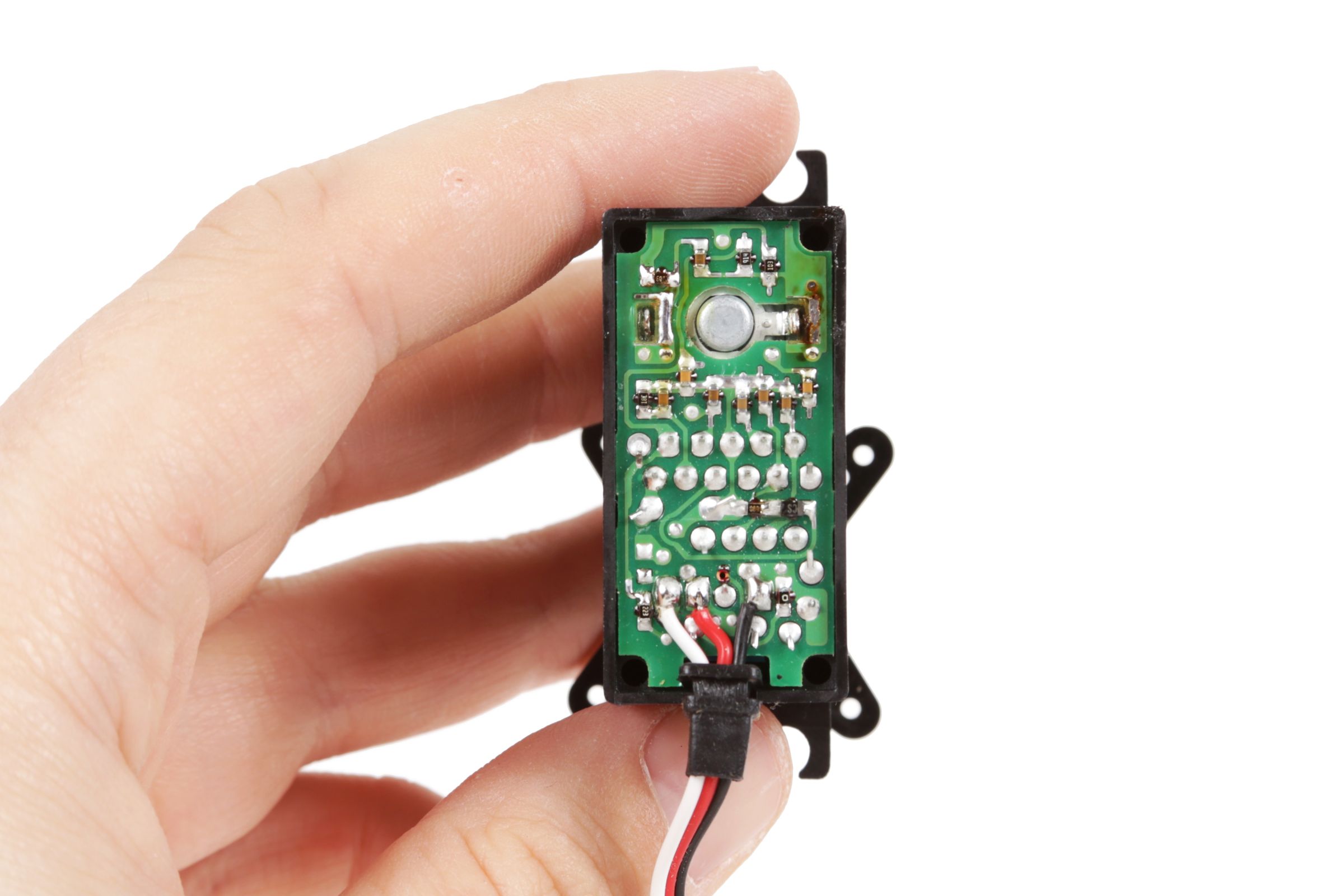

First things first, we need to convert a servo motor, which is a circuit board controlled motor into a basic gear motor. The reason for this is because servos are reliable, easy to work with, and have gearboxes with a lot of torque, which is necessary for pressing the switch.
All this entails is removing the circuit board attached to the motor and attaching two wires instead. It's not as scary as it sounds, and gives us a chance to practice desoldering.

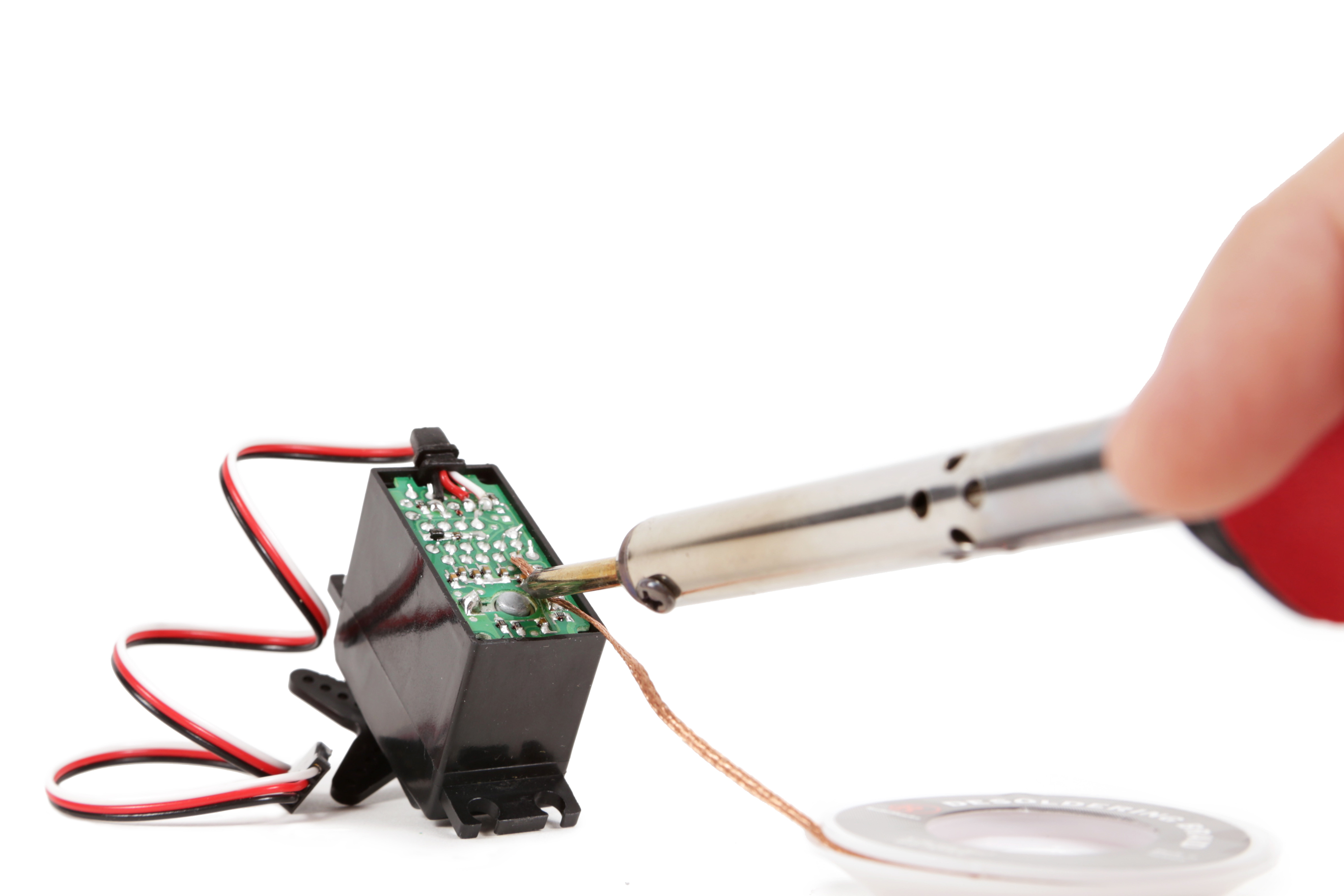

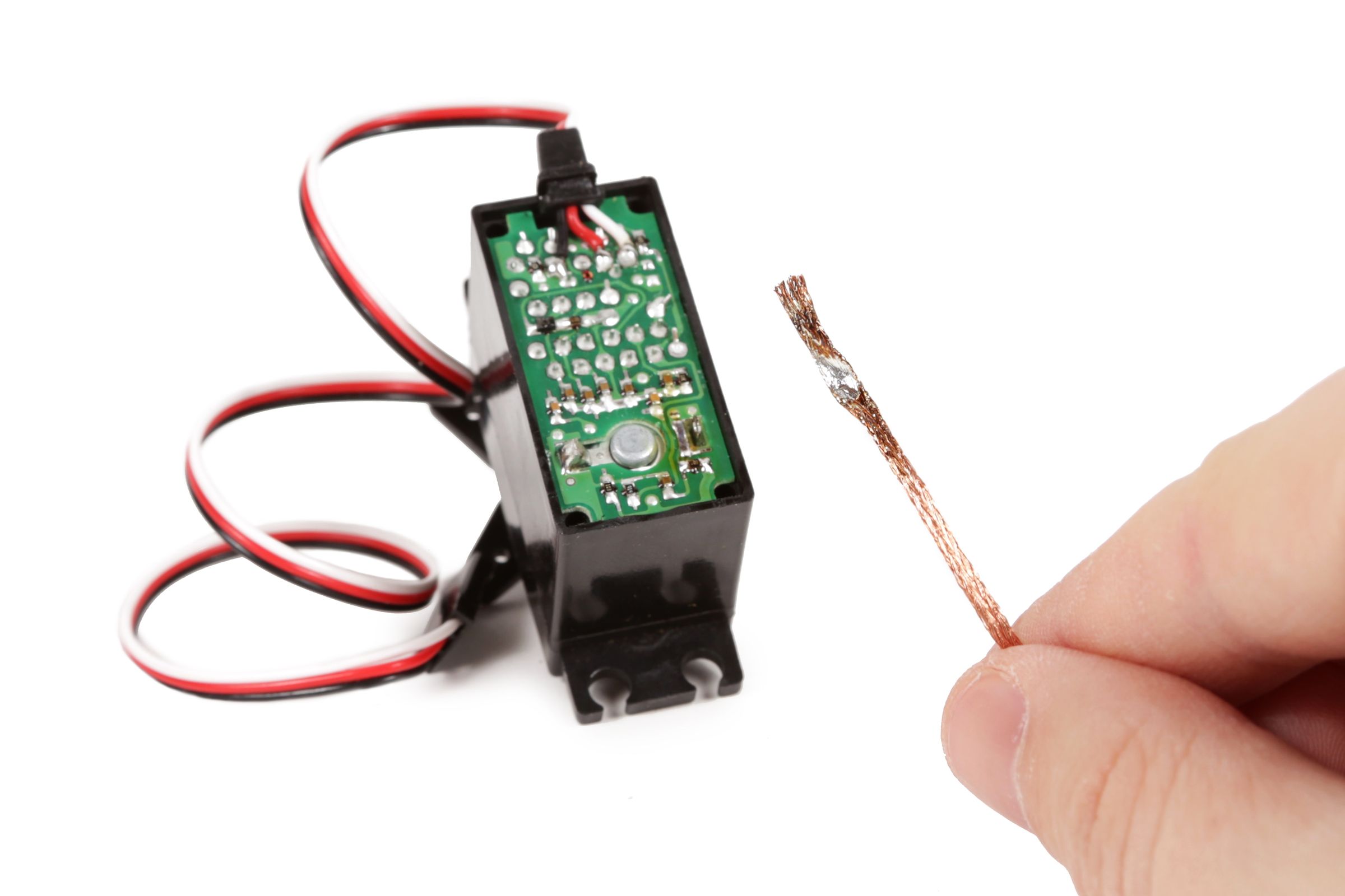

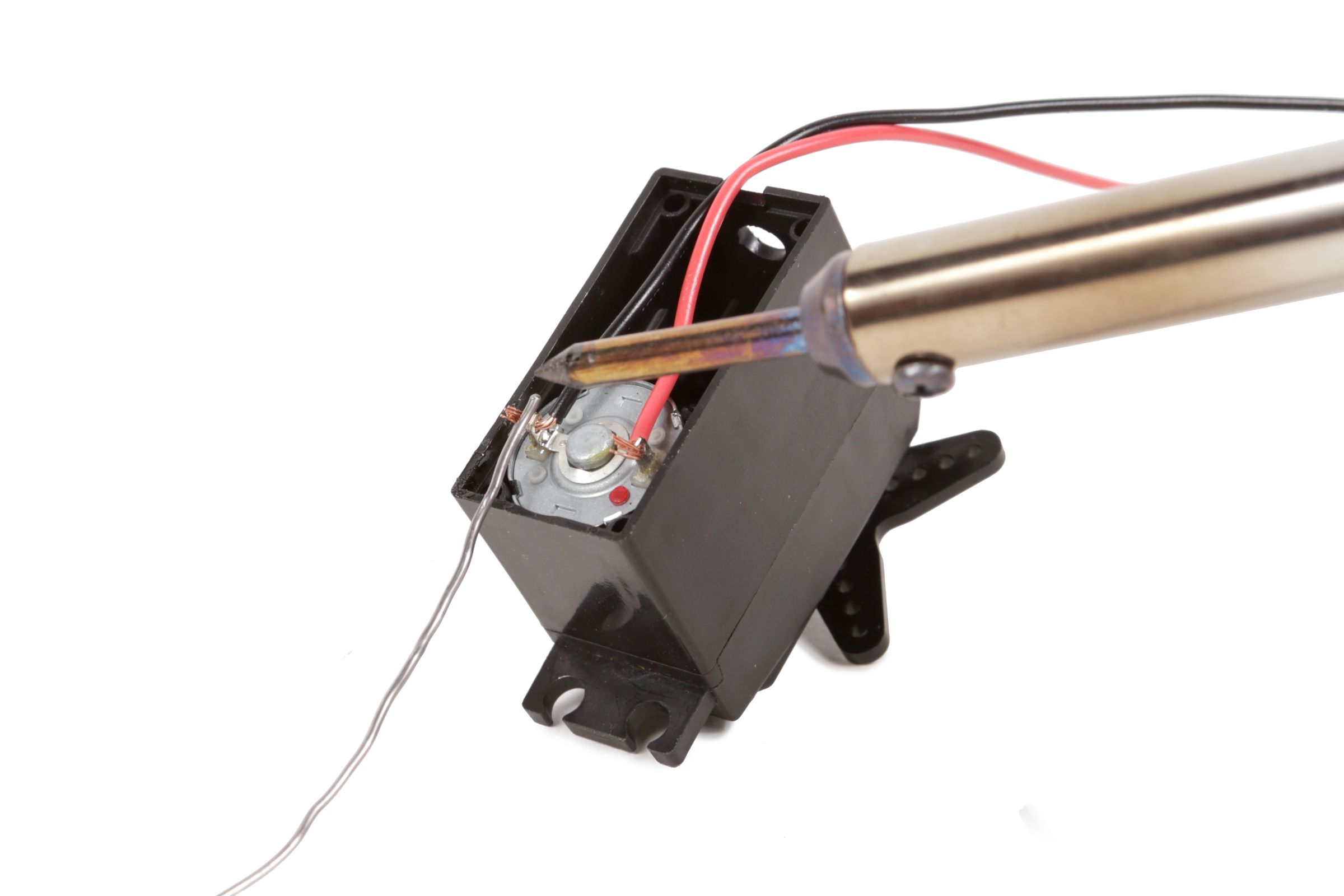

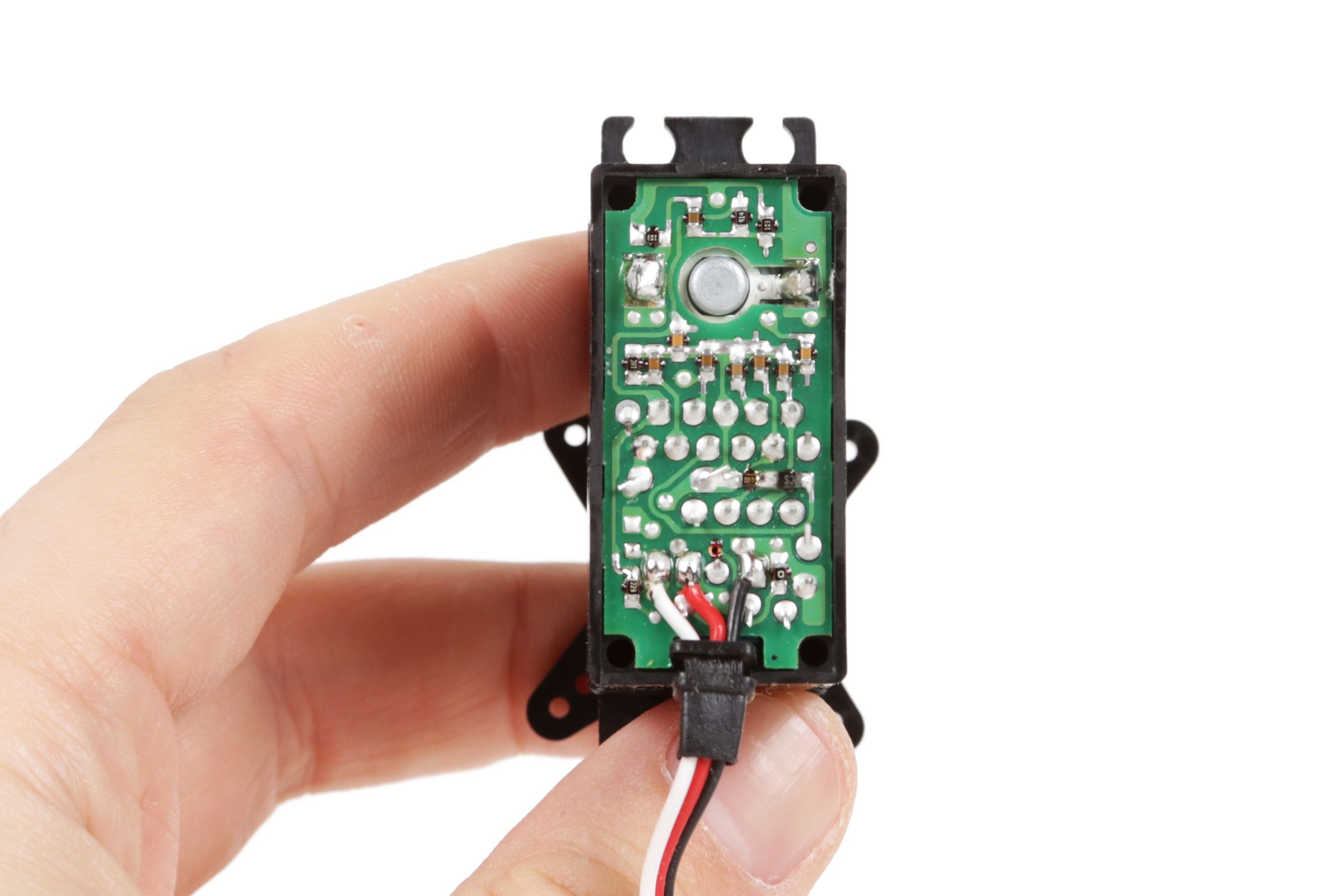

Remove the four screws to find the servo's circuit board and locate the two large solder terminals connected to the motor.
Carefully use desoldering braid to remove the solder from the two terminals connecting the circuit board to the motor.
Remove the circuit board from the case.

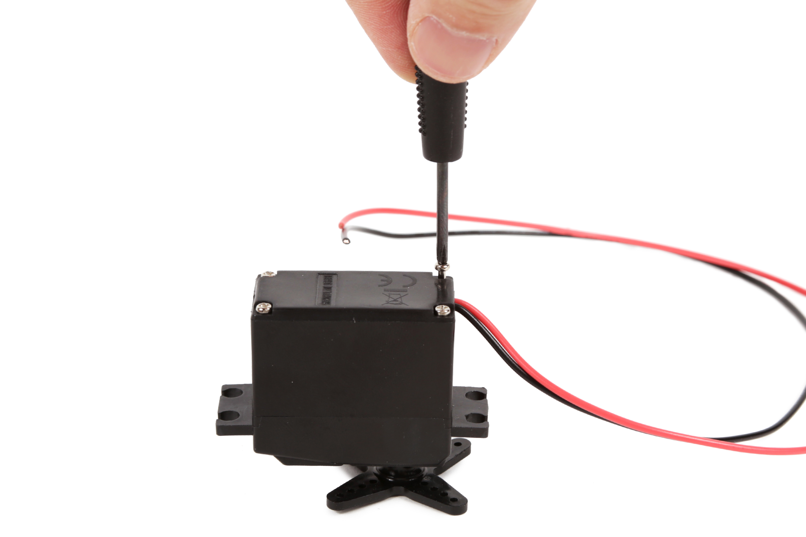

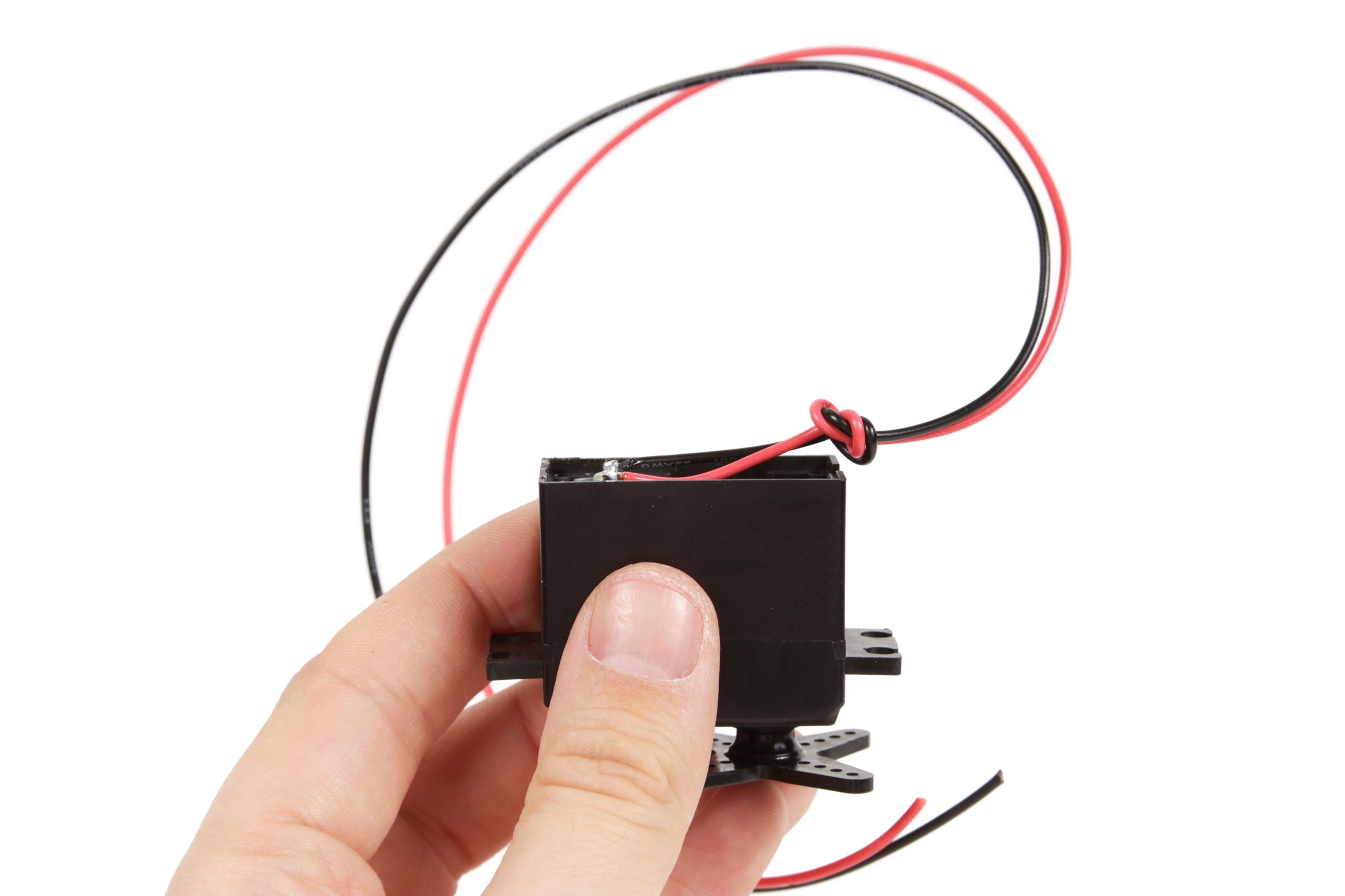

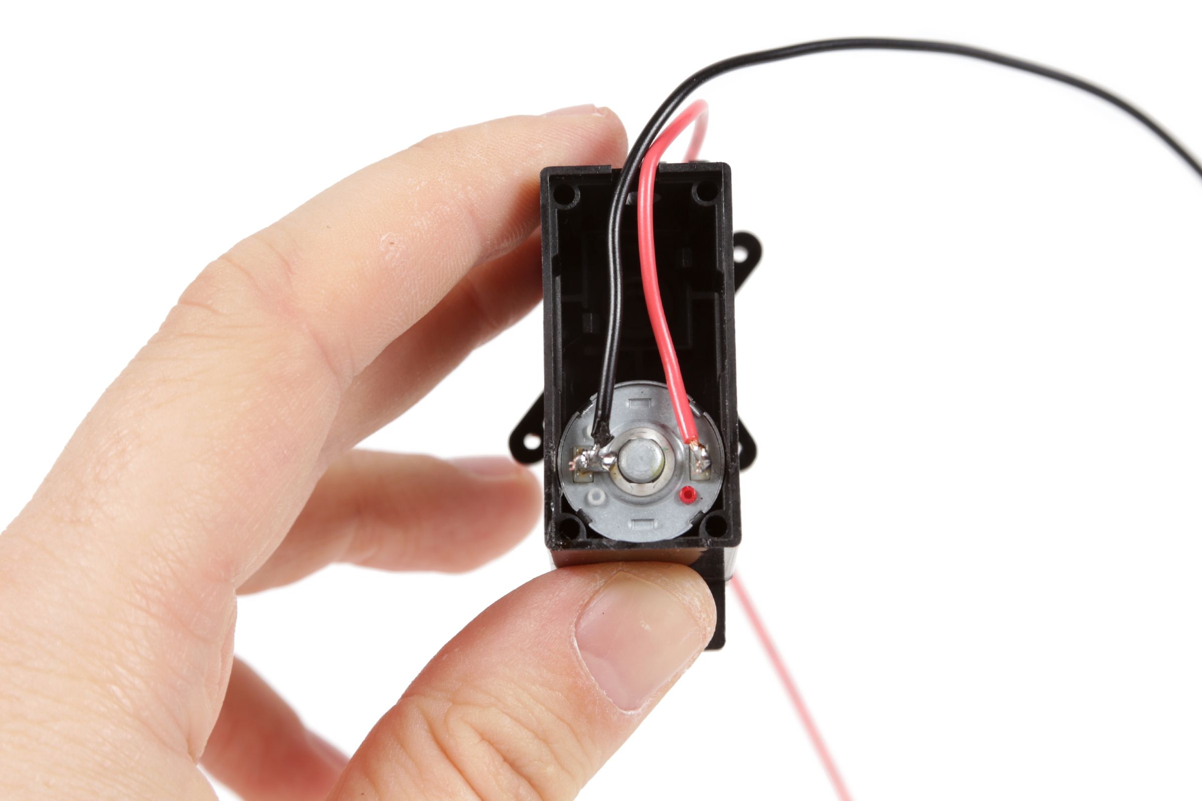

Solder a red wire to the positive terminal of the motor. This is typically marked with a red dot. Then, solder a black wire to the other terminal. If you mess this up or they are not marked, don't sweat it. It will just mean your motor might spin backwards when power is connected. If this is the case, just rewire it with the wires reversed.

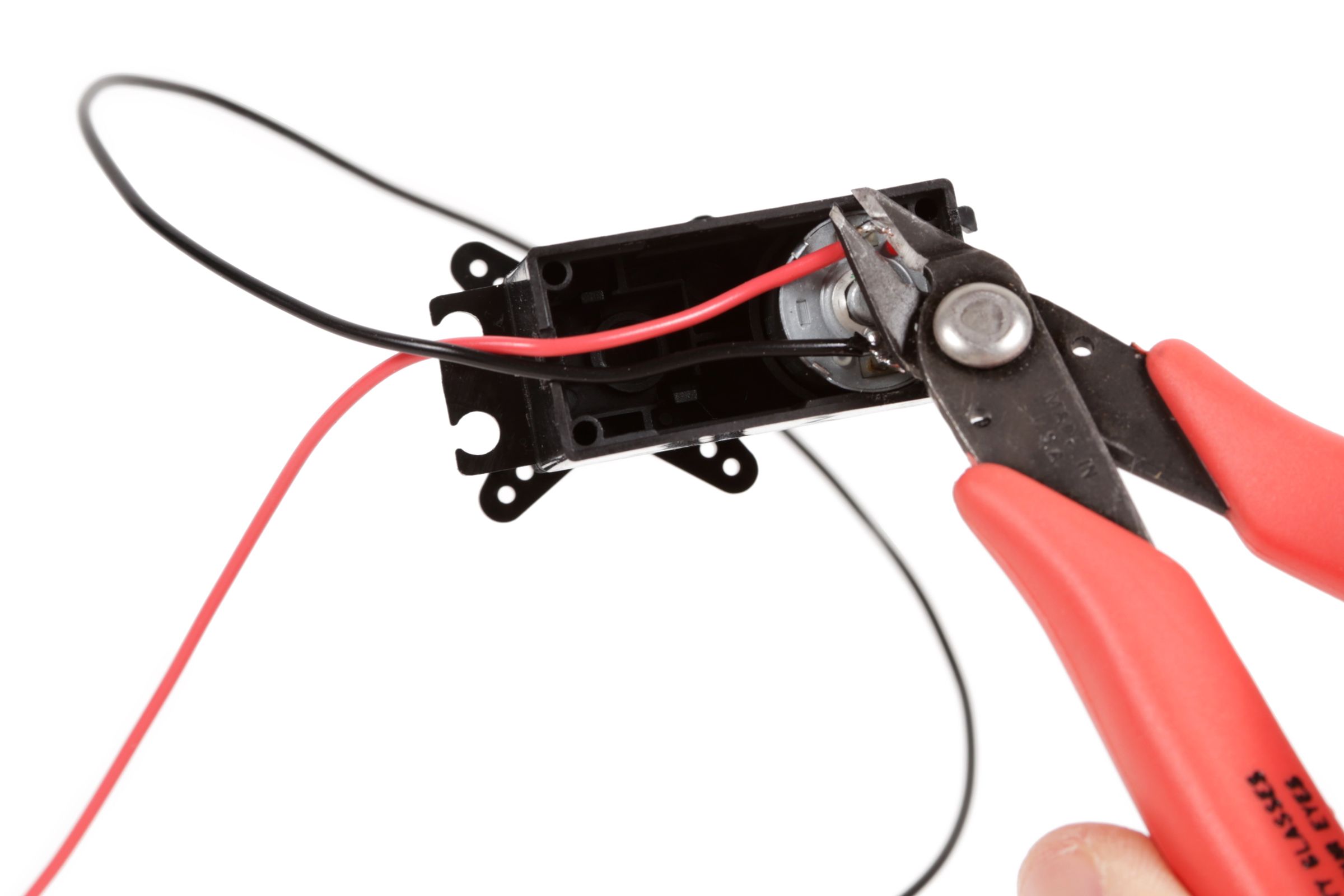

Trim away any excess wire leads from the terminal. This will make it easier to get the lid back on.

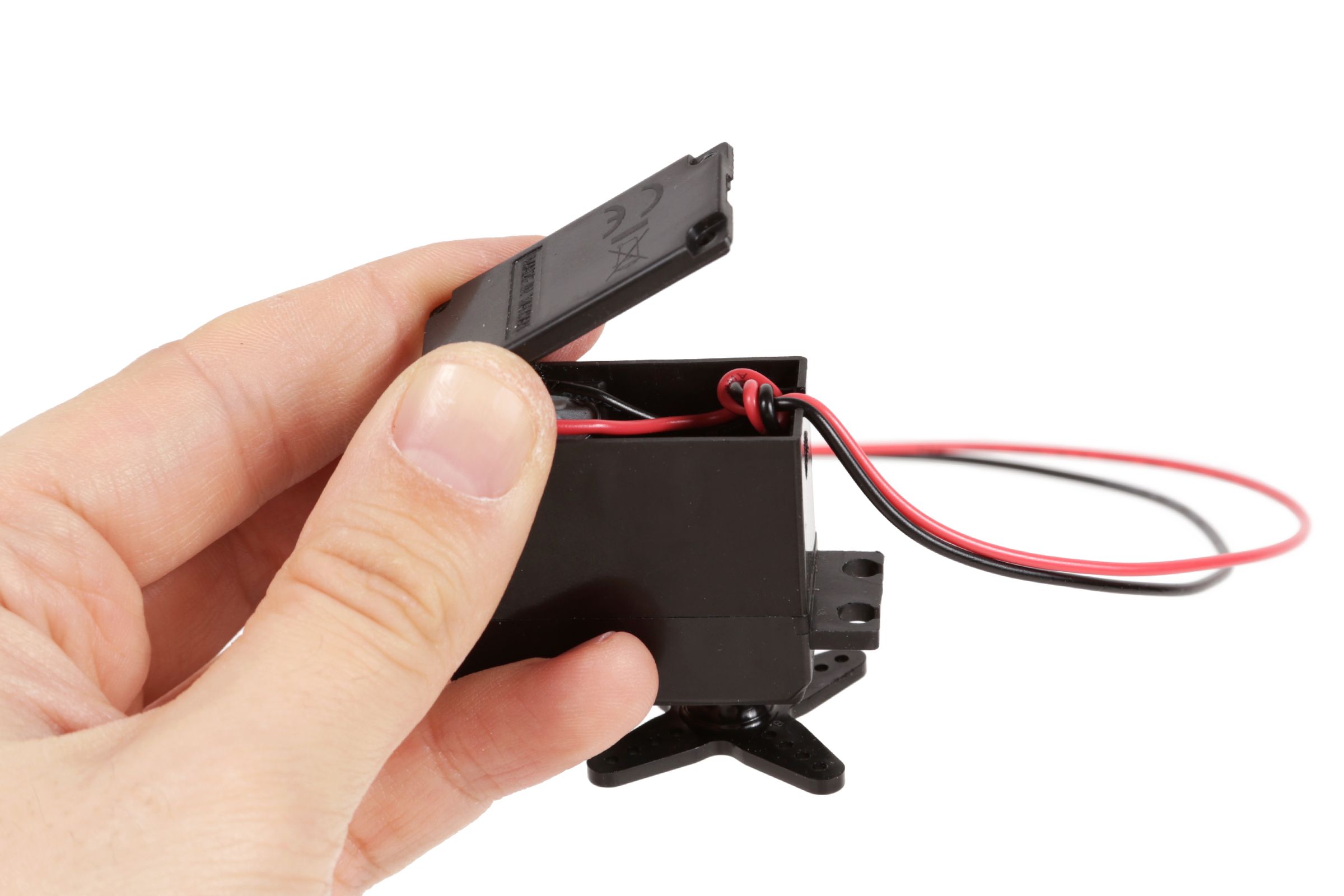

Tie the red and black wire together in a knot such that the knot itself extends past the outside of the motor enclosure. Then, place the knot on the inside of the motor enclosure. This will prevent anything from placing strain on the wire and it getting pulled free.
Close the case back up and you are done.

Step 9: Wire the Circuit

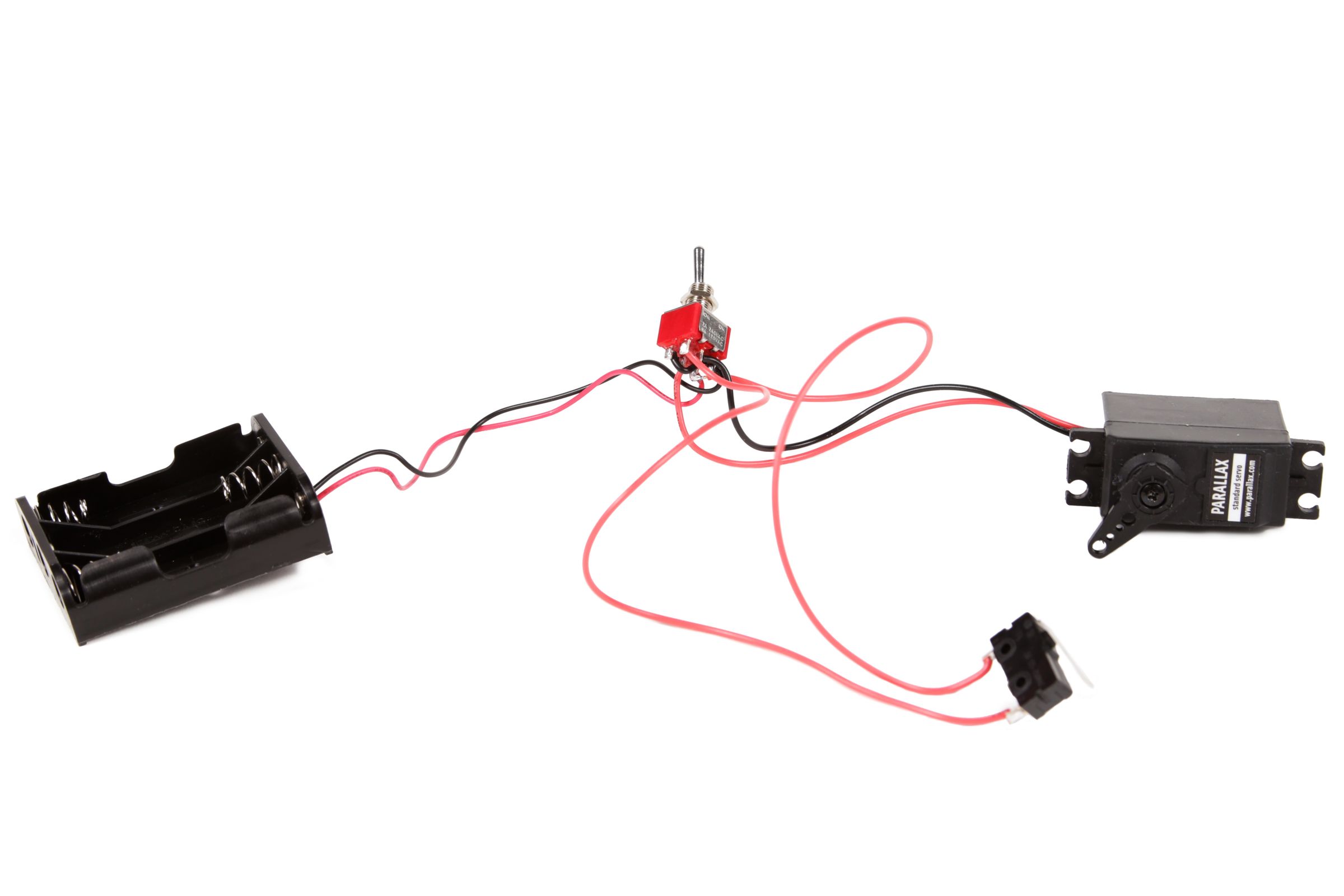

Let's wire together the circuit as outlined in the wiring diagram above.

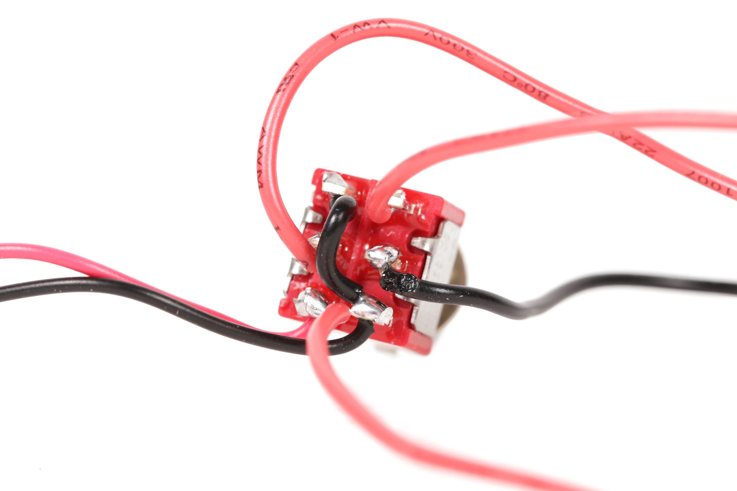

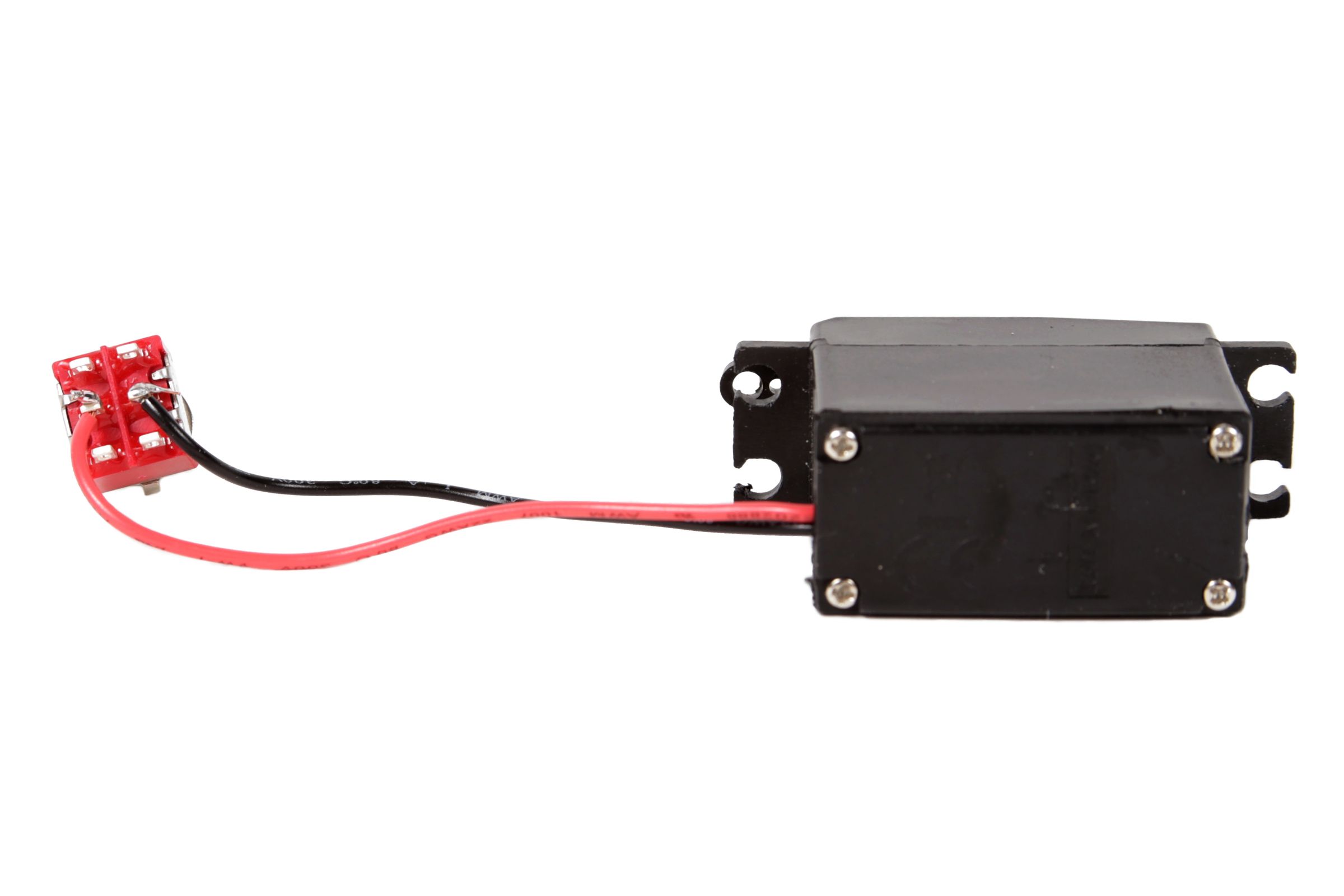

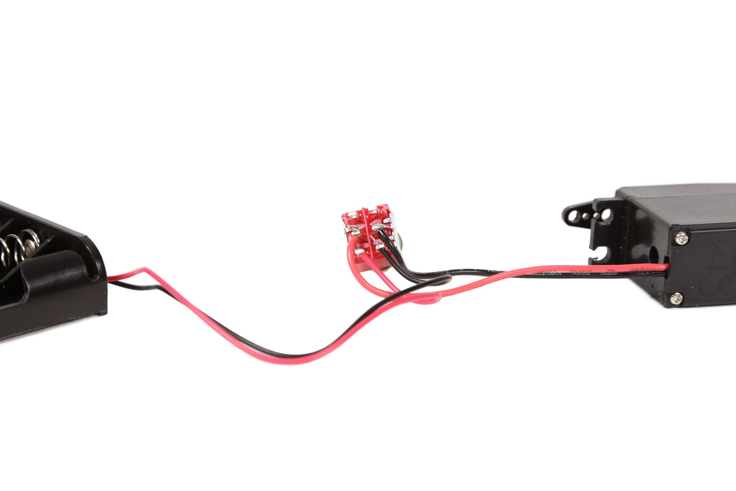

To begin, attach the motor to the center terminals on the switch.
Then, attach the battery back to the outer terminals on the switch, keeping an eye to line up power and ground connections. If the switch were to be thrown now, power will either be connected or disconnected, and the motor should spin clockwise.
Since we want the motor to get disconnected when it spins counter clockwise and presses the lever switch, we then connect wires to its common and normally closed pins. In this way, the switch is normally closed to allow electricity to flow, but the connection is opened (or 'broken') when it is pressed.
Finally, the outer terminals of the switch are crisscrossed to allow the motor to be powered backwards when the switch is toggled. For ground we simply use a short wire. However, for power we use the wires from the lever switch such that it can be toggled on and off.
