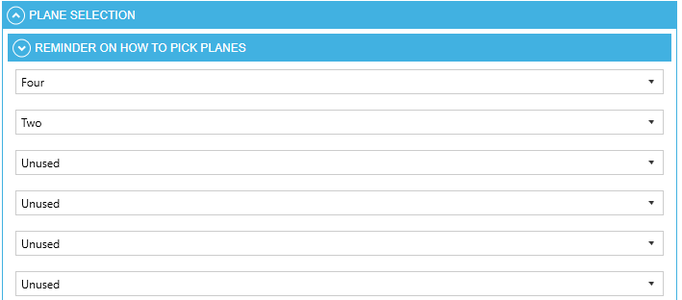

Step 3: Choose Planes and Operations
Choose the planes that you require based on the photos you took and what kind of operation you want to do between the different surfaces you create. Overlap and Subtract are two operations available. The difference between the two operations can be see in the last image above

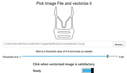

Step 4: Insert Images and Vectorize
In this section, you choose the image file you want to vectorize and input a threshold value that would provide the cleanest vector image. There is also a toggle that you have to click before the vectorized result is let through the rest of this script. This is so that you can tweak the threshold value till the result is satisfactory without causing massive performance issues.

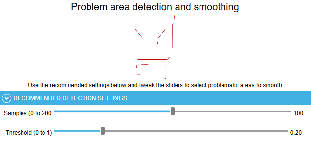

Step 5: Problem Area Detection
In this section of the window, you find areas that aren’t as smooth as they are on the actual object and clean them up to achieve better results. The viewport shows the irregular parts of the curve being marked red. This section has two slider inputs, in which you can tweak how sensitive the script flags problem areas to more precisely only detect areas that are truly problematic, instead of also including areas that are part of the intended geometry. Samples (50-200, default 100) determine how many points along the curve are analyzed - more samples give better detection of small irregularities but take longer to process, while fewer samples run faster but might miss subtle irregularities. Threshold (0.00-1.00, default 0.15) sets the sensitivity for detection - lower values like 0.05 catch subtle bumps and minor roughness, while higher values like 0.4 or above only flag major problem areas.
Step 6: Smooth Problem Areas
Once problem areas are identified, the script separates the curve into the smooth sections (areas that don't need fixing) and the problem sections. You are output separately, so it is possible to edit only the problematic segments and then join everything back together into a clean, smooth curve. The viewport shows the areas of the curve that were flagged by the script as being irregular and have been smoothed out.

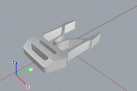

Step 7: Insert Obtained Measurements
In this section of the window, you input the measurements of the object you want to recreate. It also includes a preview of the final surface after being resized. This is shown in Figure 18. There is also a short disclaimer regarding how the measurements might need to be varied slightly between the different planes, since Grasshopper’s boolean intersection/difference operations don't function well if the edges are exactly coincident.
The image with the example model also shows the dimensional axes
