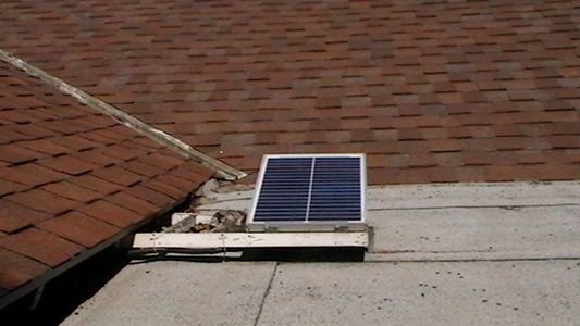

A couple of years ago I decided to add another small solar panel to the collection I have on my roof. I have a 5 and 10 watt. This new one is a 20 watt. It is dedicated to providing emergency power for lighting, a small fan and other misc. small low voltage devices. For this setup I needed a battery since it would need to be able to provide power 24 hours a day. I decided an un-dead car battery would be perfect since the largest load it would need to power for any extended period of time would be less than one half an amp. There is quite a difference between 200 – 600 amps and a half an amp.

I also made a desk lamp with a completely enclosed battery.
I decided to go green with these lamps and other low voltage devices I have made, so several years ago I bought a 5 watt solar panel. We do not use our chimney because we have birds (they are sensitive to smoke) so I put the solar panel up on the top of the chimney. Since the current is so low I used cat 5 cable to run from the panel to the garage. Since I only need to charge one of my other un-dead car batteries for about 4 or 5 hours about twice a month (as needed) I made a battery charging board with a linear regulator. It is a 15 volt regulator. The battery never gets up to 15 volts. I charge the battery when it gets down around 12 volts and I charge it back up to around 12.5 volts. I check both lamps every couple of weeks. They have a really long run time. A 7 amp hour battery is kind of overkill for a 20 milliamp load. It’s great. Both lights get used daily. One of them gets charged about every 6 weeks or so. Keeping the batteries above 11.5 volts makes them last longer.
